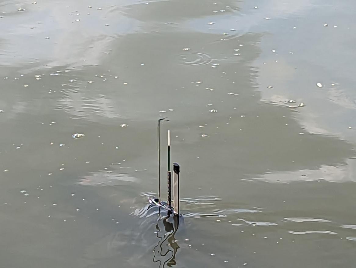

      B: 95% of my operating environment is opaque to anything but a few inches underwater. Periscope Depth is my wheelhouse. I was taught in 1991 to never take your eyes off the scope in dark or murky waters, or with solar glare. Only on rare occasions do I run in clear water enough to see it. So 2.4Ghz works for the greater percentage of MY running venue as I run in the wild, not protected pools or reflecting ponds.
      Click image for larger version  Name:	PXL_20230702_145024769.jpg Views:	0 Size:	57.3 KB ID:	172470
      The only clear place I have to run in now is SubFest, which accounts for (let’s do the math)….
      Cohutta Run, 1/y, (4d x 6h realistically as a high limit) = 24Hr/year
      Everywhere else: 30/y, (1dx3h avg) = 90Hr/year
      Total is 114hrs/year, 24 of which is in water good enough to dive below PD. 1-(90/114)= gives me 79% of the time 2.4Ghz is good enough, or in my case…warranted due to visibility.
      FWIW, this works for 14/17 boats in my fleet. Which is 82%. Only 3 actually need 900Mhz. I have been running 2.4Ghz since 2016, and to be honest I was delighted when Dave came up with his original 2.4Ghz article. I will take a solid performer at PD over a temperamental performer that can dive any day of the week. Plus I giggle when I hear people ask for frequency flags.

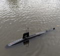

      Also, I can set up one boat to have TWO identical Models on the TX. One as 2.4Ghz only (Normal Mode), The other uses both 2.4Ghz and 900Mhz on a single FrSky Tandem Receiver (Dual Mode). In fact both have the same picture on the screen but the Dual has a wide red border so I can instantly tell which “model” (or mode for that boat) I’m in at the pond.
      Soooooo why do I go through all this??
      When I’m running in my Normal mode at 2.4Ghz in the Texas mud (or the first time at a strange body of water), I’m forced to remain at PD, the Failsafe will kick off as the scope dips.
      Click image for larger version  Name:	0-591.png Views:	0 Size:	24.8 KB ID:	172475
      When I’m running at Dual mode, say at Cohutta, Carmel, etc, I CAN dive the boat where the failsafe would kick off at a much greater depth. I’m not worried about losing it as I can jump in and swim right to it to recover.
      Click image for larger version  Name:	0-591D.png Views:	0 Size:	43.8 KB ID:	172474
