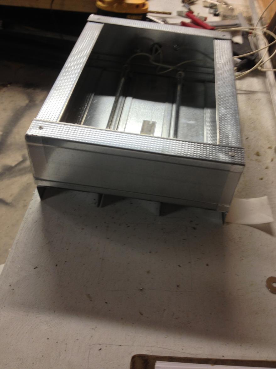

                I've poked around in hardware strores, looking for 'stuff' to make the heater with and no light bulbs went on. And then - there it was - in my basement - staring me in the face - 2x4 steel studs! I'd had some remodeling done to 'this ol' house, and there were a few studs left over, quietly minding their own business, leaning in a corner.

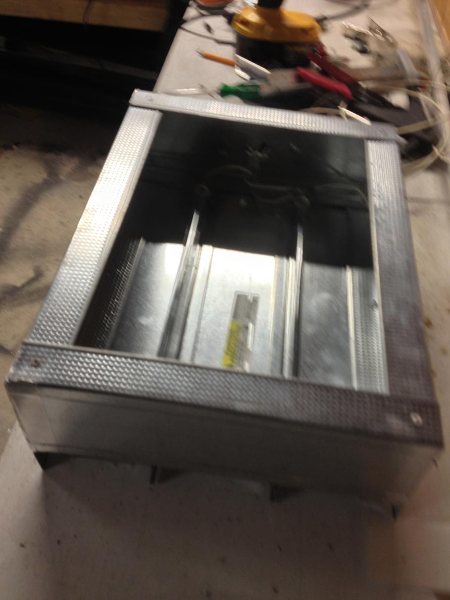

                I cut 5 pieces about 15" long and pop riveted 3 together to make the floor. They have formed the 'legs' of the unit, and keep that hot surface well away from the table.

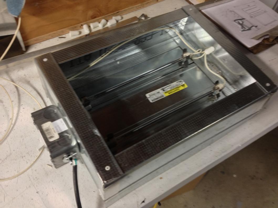

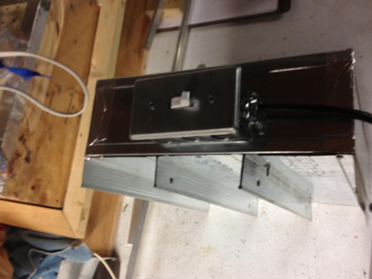

                I purchased some special heater elements and installed them into the supplied spring clips, then wired them to a metal switch box.
                Sharp edges of the studs are covered in aluminum tape.

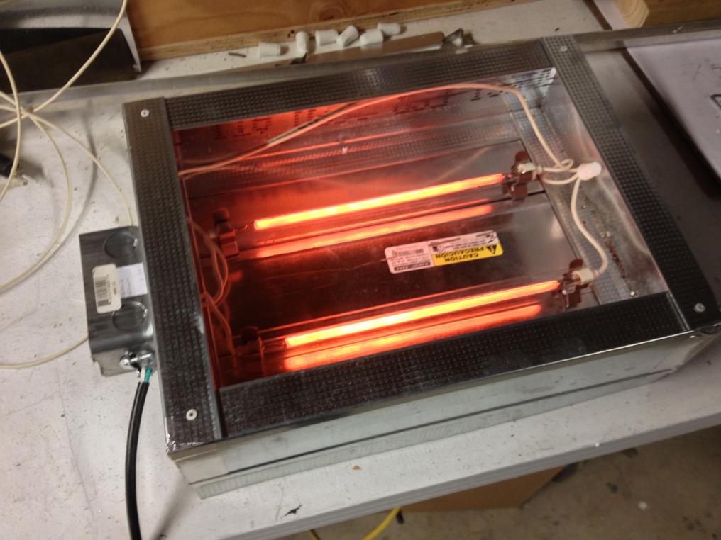

                Yup! It works! and it's darned hot.
ID:	74748Click image for larger version

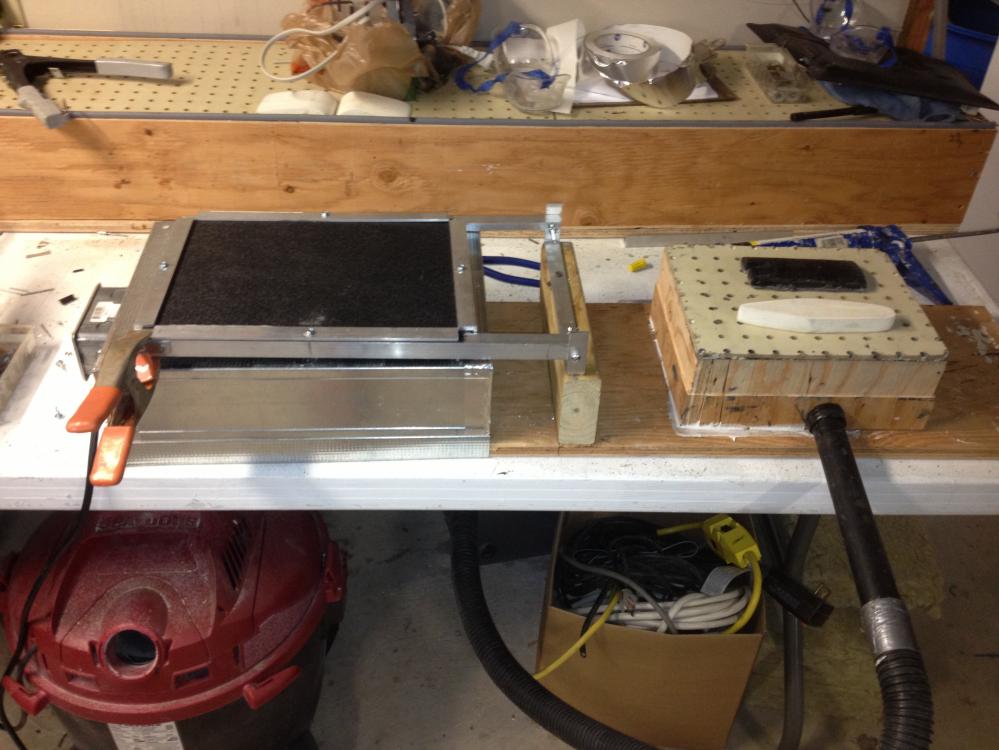

                  #38
                  Well, this is a comedy of errors! (Isn't every prototype?)

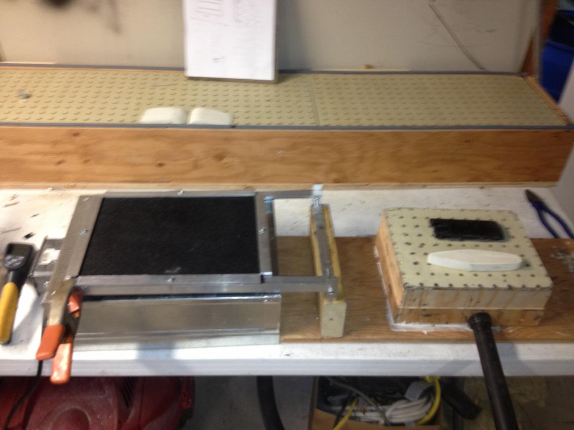

                  After a bit of trial and error, I realised that to get a really good seal on the platen, I needed to make the frame holding the sheet fit completely around the platen, so the soft plastic would form its own seal around the edge. Getting the height right so the frame would flip over and surround it was fun. It looks like the platen needs to be about 1" higher than the heater box, and the frame about 1/2" wider.
                  My other BIG mistake was to make the platen out of wood. I should have simply made the front and back of the heater box longer, and incorporated the platen into it. That would have eliminated the 2x4 holding the frame hinge.

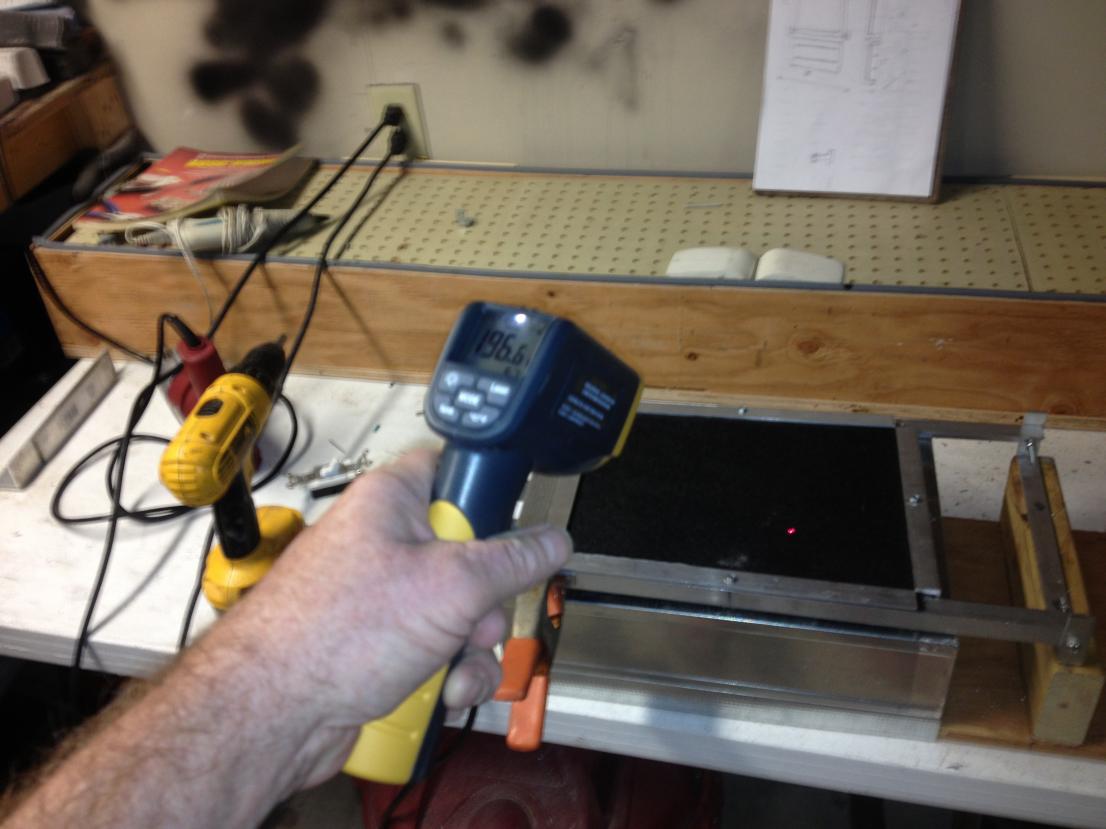

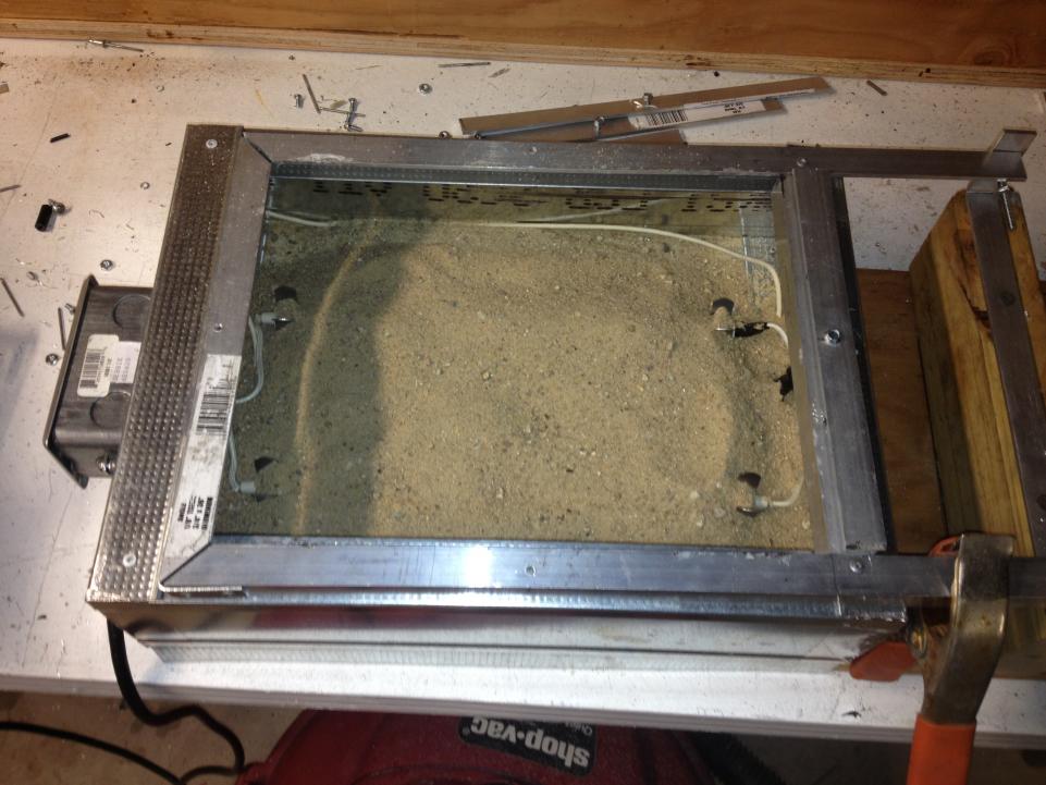

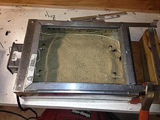

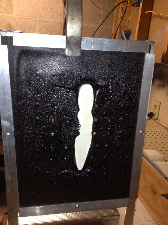

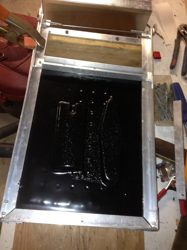

                  Next problem! I kept burning the underside of the plastic sheet. It was getting very hot in the middle before the sides had melted sufficiently. Those two heater bars were simply too close to the sagging plastic (sort of dangerous too! Now where did I put that ol' fire extinguisher?)
                  I had temps of 310 in the middle and 265 around the edges.
                  One of my employees (he's into R/C Cars) told me a pal of his was covering the nichrome wires etc with sand to even out the temps. So, I tried it!
                  Yup! That works, but the whole thing now takes a while to heat up and cool down.

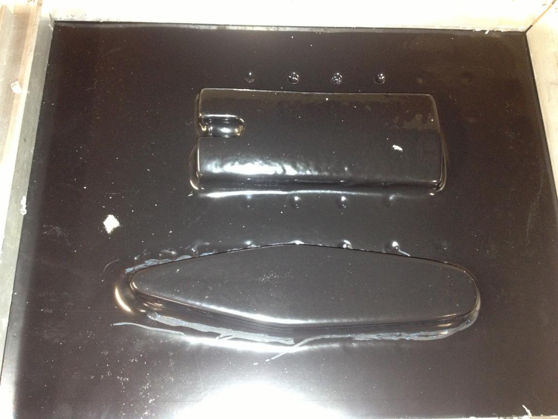

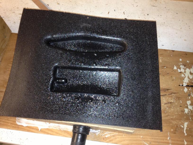

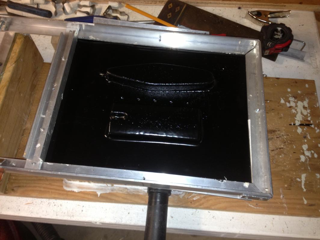

                  Here's the first one! It's not bad!
                  Certainly good enough for making Skipjack weights!

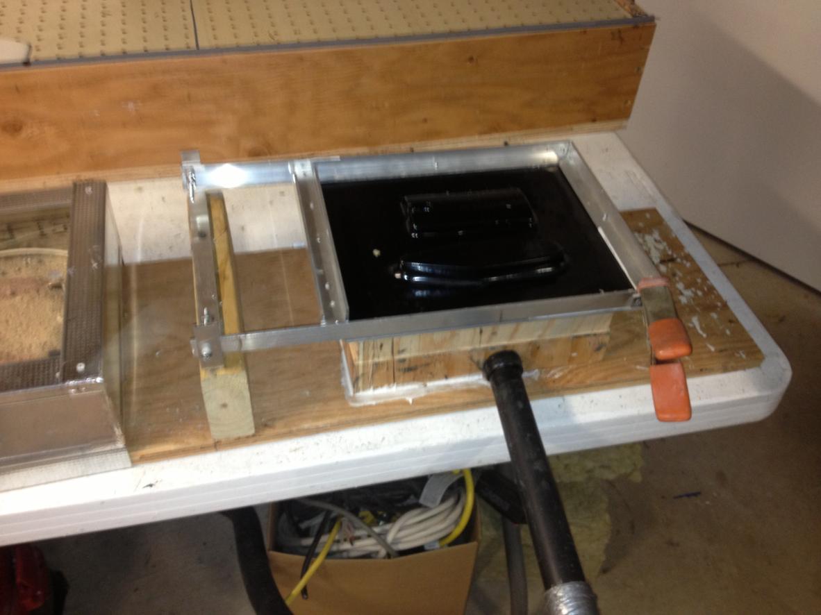

                  On my next attempt, I went for more heat and waited until I had 300 around the edges, which resulted in 350 in the center. I also raised up the part on some washers to try to achieve a sharper edge around the bottom.
                  The result was that the SHop-vac pulled the plastic right through the platen holes. I got a couple of folds in it too Dang-blast-it!
                  If I can conjure up the enthusiasm, I'll make MkII now. I have a better handle on it. Got to get that plastic further away from the heater elements.
ID:	74755Click image for larger version
ID:	74756Click image for larger version
                    • 13983
