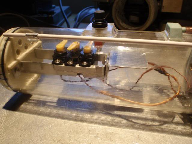

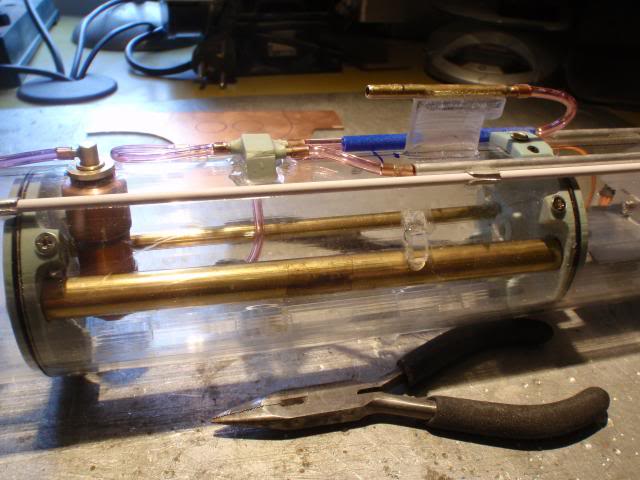

            John, here you can see my modified SD, the smaller conduit tube is the standard one, the bigger i've added, had to take the SD apart, stacked both bulkhead and used a drill press to get me the holes, to get a watertight connection i used epoxyglue on the inside of the ballasttank and also in the dry space of the SD, left the standard conduit tube as it was.

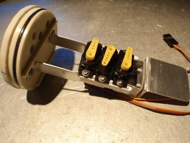

            This is how i fastened the front servo's, used a old bracket from another SD and rebuilded it to house the three new servo's, pretty straithforward tooling, used a 5 pins connector(male/female) to keep this part removevable, in this configuration you only need 5 wires through the conduit tube, plus and minus are shared, only three seperate signalwires for the servo's, works like a charm.

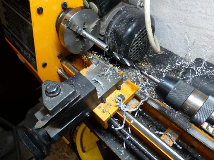

                          Hi John,

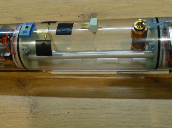

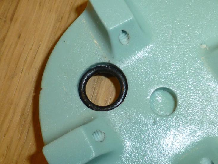

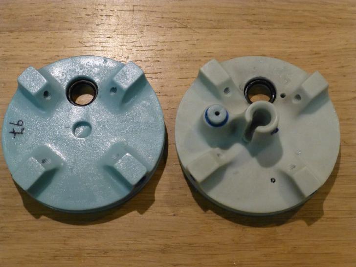

                          I had the same problem. Here is an extract of my WIP.
                          Grtz,
                          Bart
                          The only solution was to install a conduit tube with a larger diameter.
                          So I lined up all the issues that I would come across:
                          • Existing seals would not fit anymore
                          • I have to enlarge the holes in the bulkheads and drill holes off center from the existing holes, the servo to blow the ballast tank is to close.
                          • I have to dismantle the SD, without breaking anything
                          • Make a new conduit tube with a 8mm bore, without adding to much weight
                          • Provide a new sealing arrangement
                          • A larger conduit tube meant less ballast tank capacity resulting in an above waterline structure displacement that will be less.
                          I made a new crossover out of aluminum, started with an outside diameter of 10mm, and drilled a 8mm hole in it.
                          Turned it down to an outside diameter of 9,5 mm. A hole of 9.5mm was drilled in both bulkheads eccentric from the existing ones.
                          Next the new bores were partly drilled out to 12mm so they would take the new O-ring.
                          Everything turned out well to my relief. Everything was re-assembled The water tightness was tested without remark.
Name:	Akula (446).jpg
Name:	Akula (444).jpg
Name:	Akula (445).jpg
Name:	Akula (431).jpg
