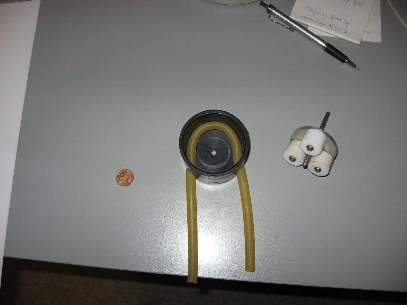

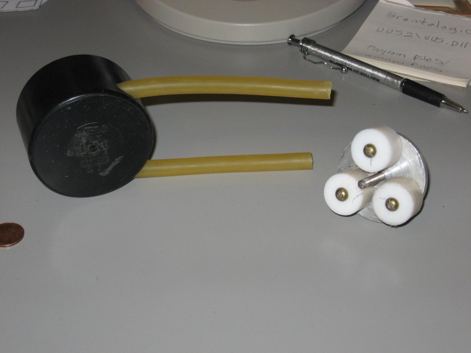

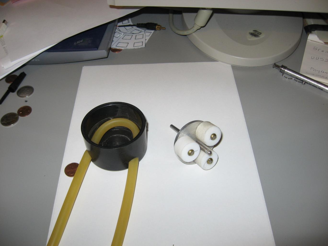

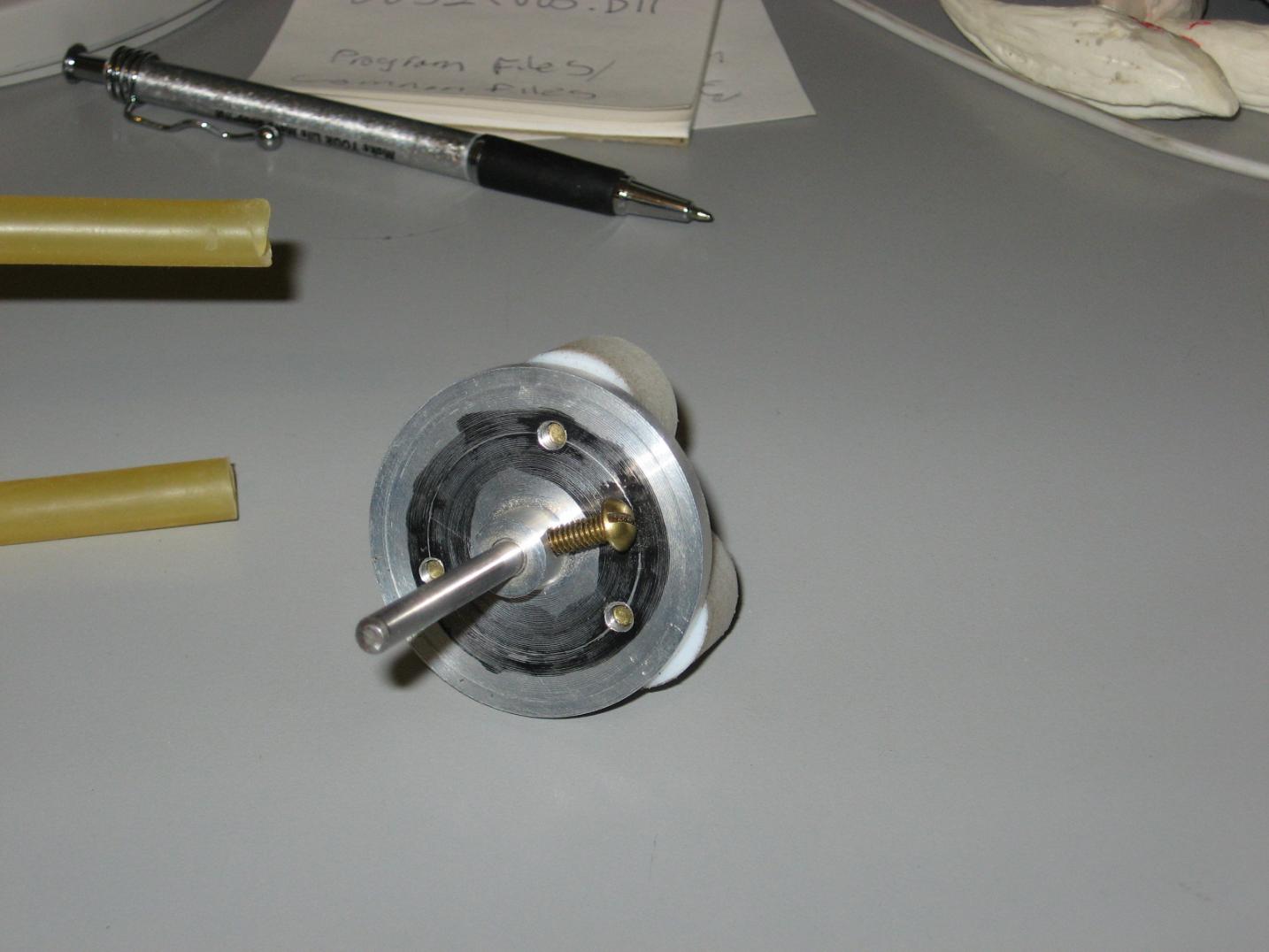

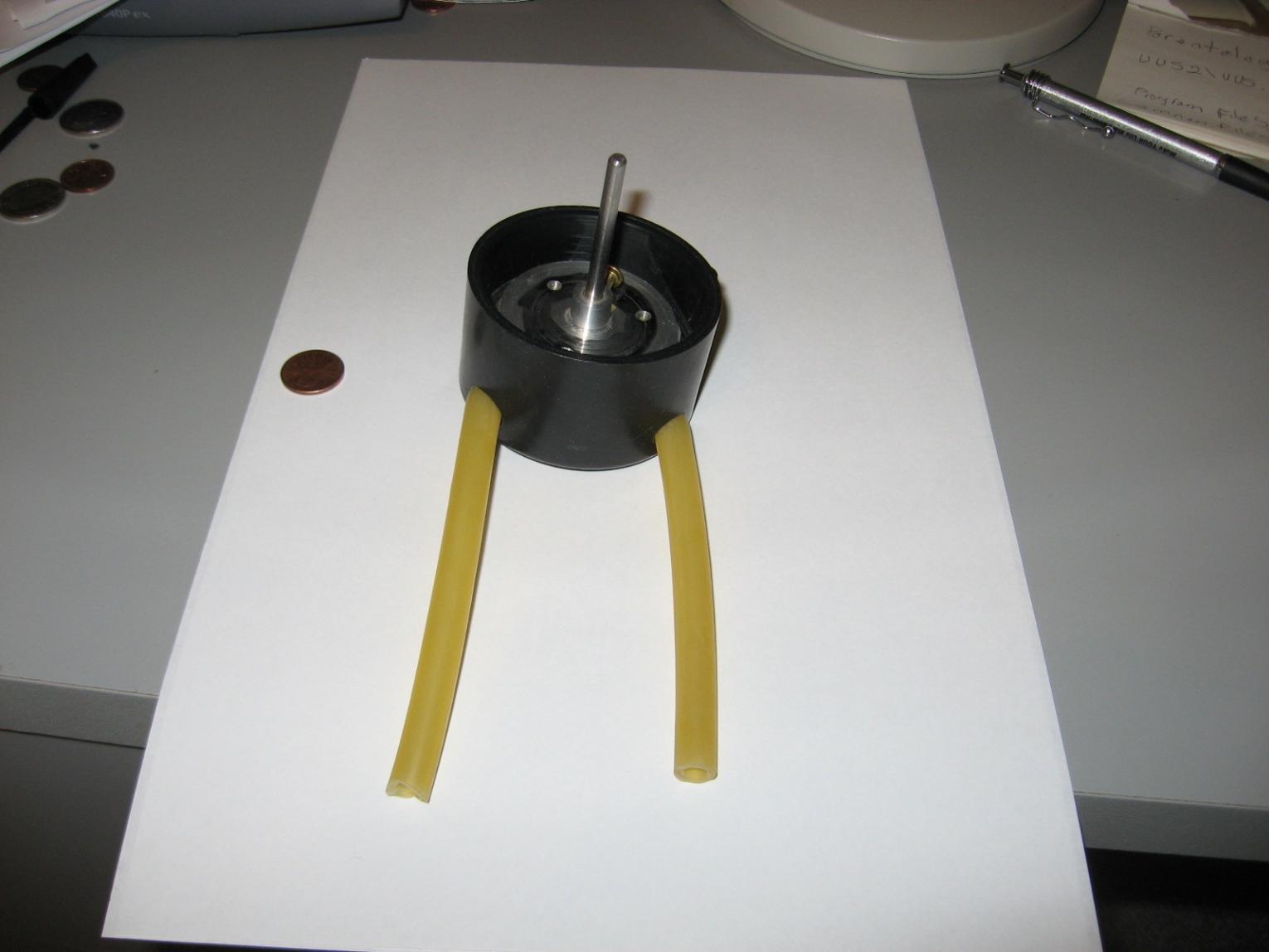

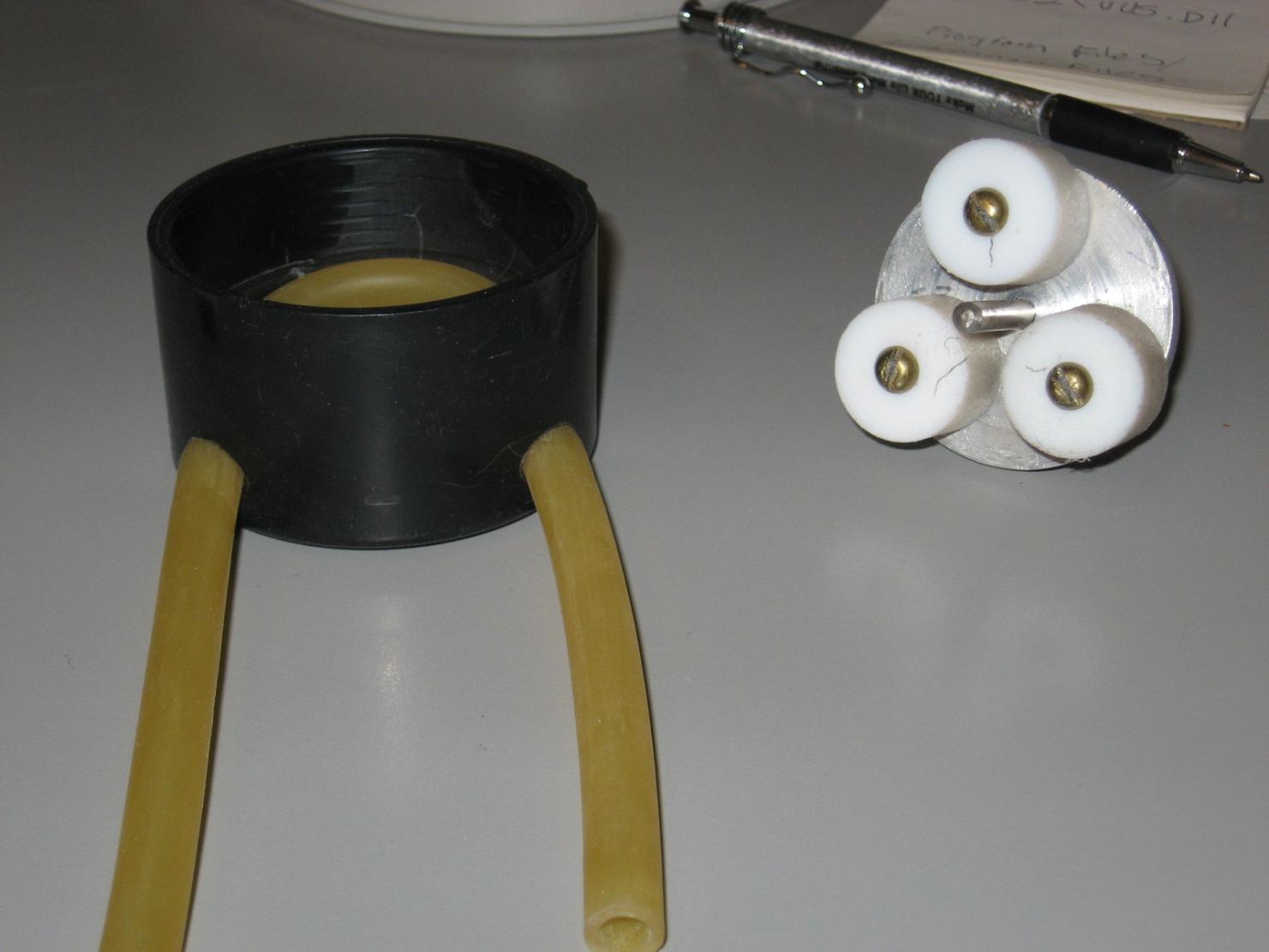

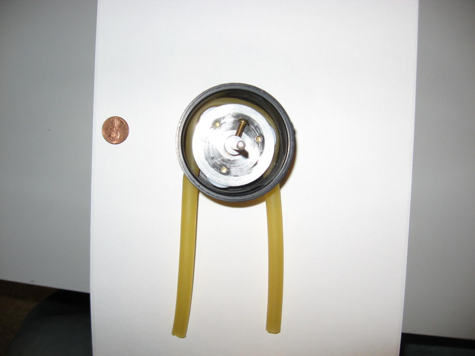

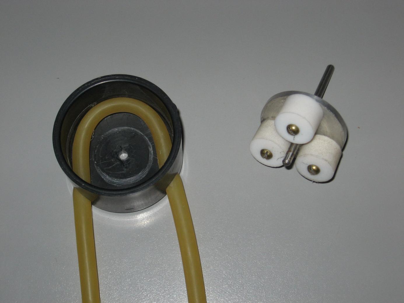

      Here are a few shots of a pump I made for proof of concept
      The pump housing is 2.375 " i.d. abs cap and I am using a .250 i.d surgical tubing.
      This was just down and dirty so I did not install and bushings or gear reduction.
      3 teflon rollers attached too an aluminun disk pretty simple and pumps great .
      I drove the test piece with a drill just too see if it would work.
      Sloted disk or rotor arm could be made so tubing size and amount of compression could be adjusted
      Rick
