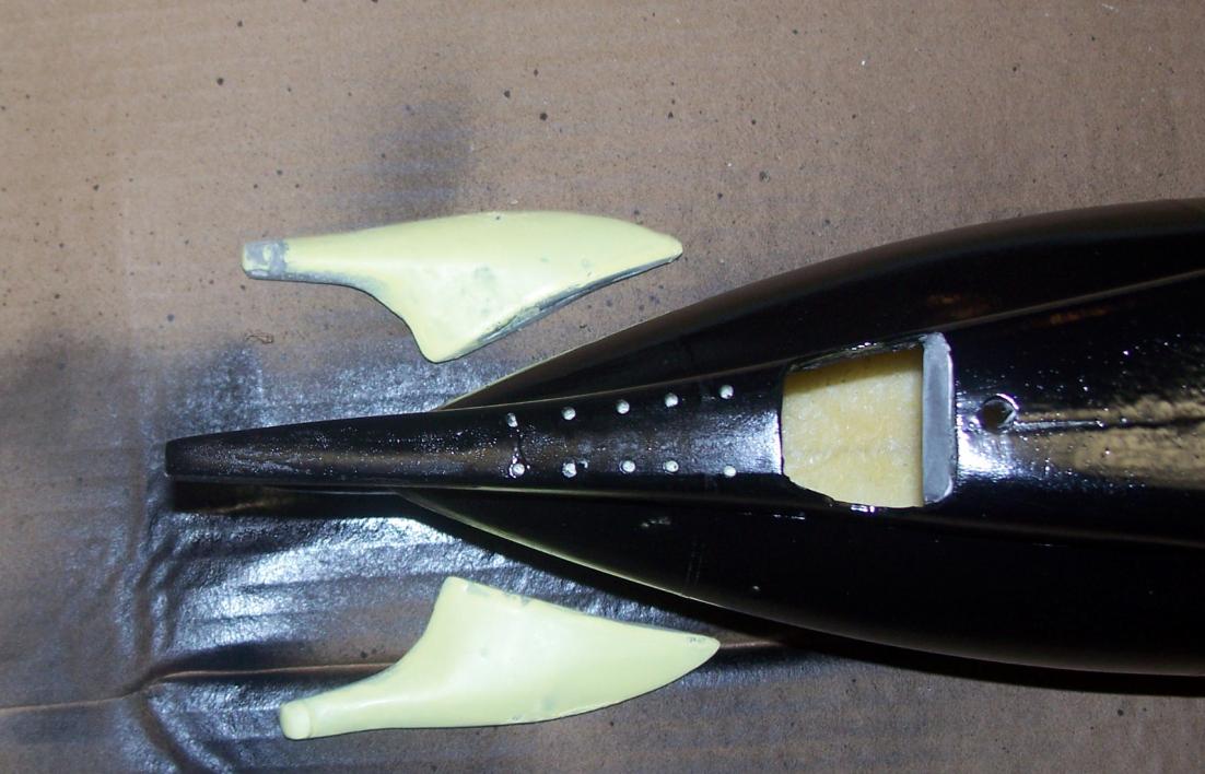

              If you look closely at the rear horizontal fins, you'll see they are flat. Compare this with Poole's model and they are rounded, more like chicken legs. I put some muscle on my Darnell model by using Playdoh on the fin and sculpting it, them making a rubber mold and pouring Alumilite. They look much more realistic now. But then, at 20' away in a mirky pond, who's to know!

                  The Darnell/MBD X-craft is best described as 'stand off scale'. The vanes need modifying or remaking as already mentioned and the bow needs reshaping if authenticity is your goal (the unmodified bow is too sharp and pointy).

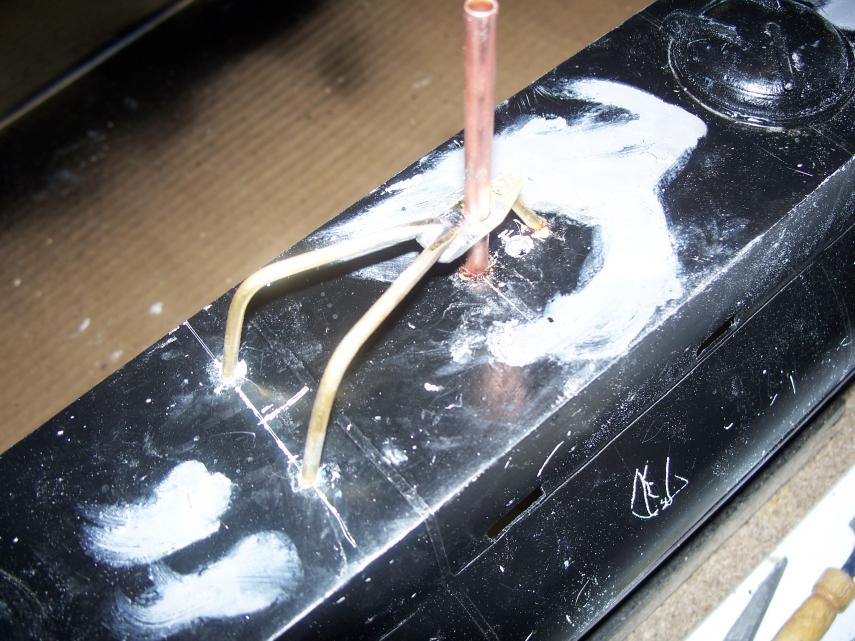

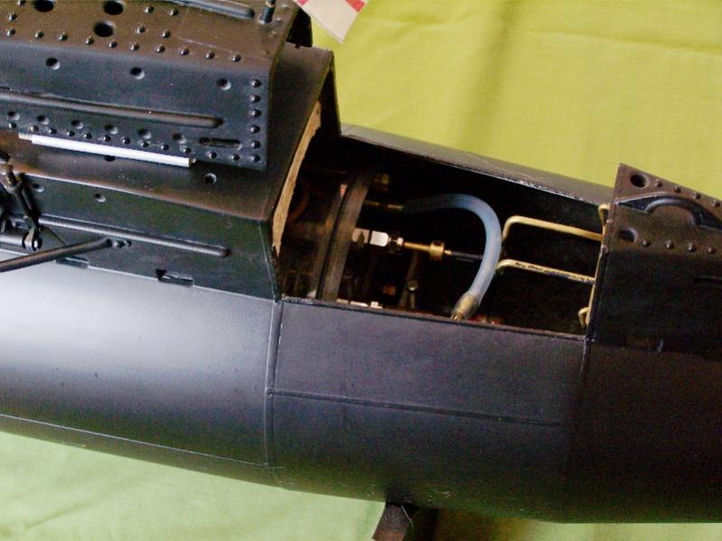

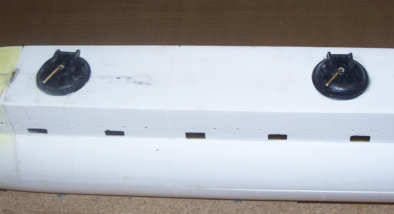

                    I didn't place the manhole covers under the superstructure - too complicated.
                    I absolutely hate, loath and detest the cover design, so much so that I am going to cut up the aft end and then glue bits onto the cover (a Zee cut maybe) because I cannot get into the aft end easily. The 3" cylinder lies low in the hull, yet all the controls ar high up, so Klik-on connections are difficult. Much more to do, but house repair and painting come first, otherwise 'her-indoors' will be beating me up again.

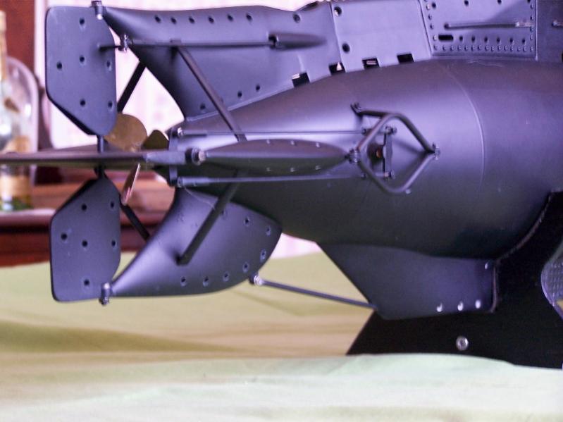

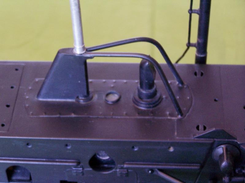

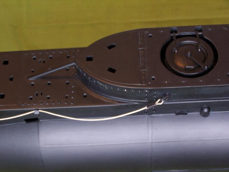

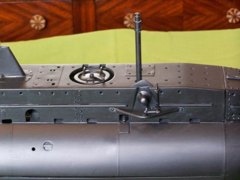

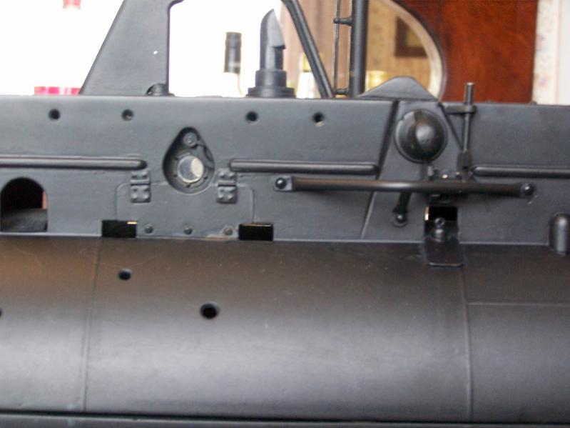

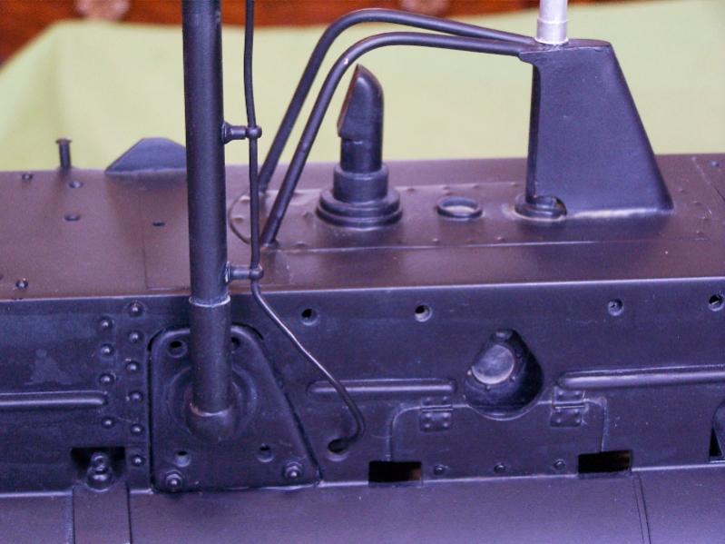

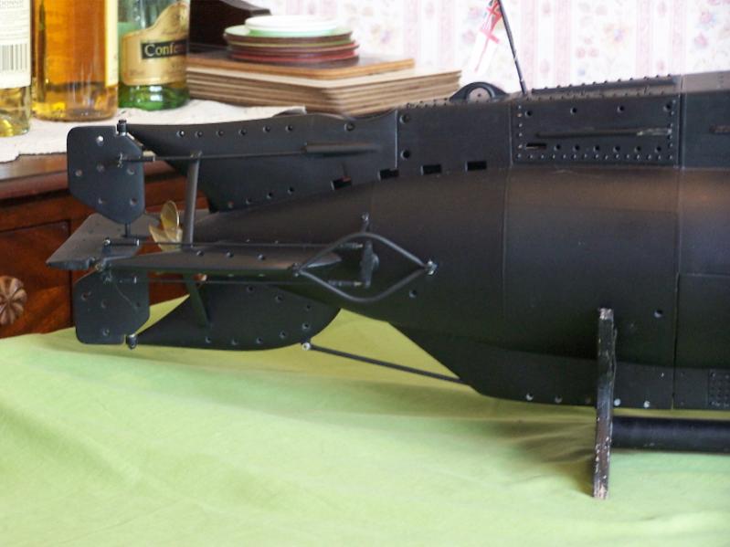

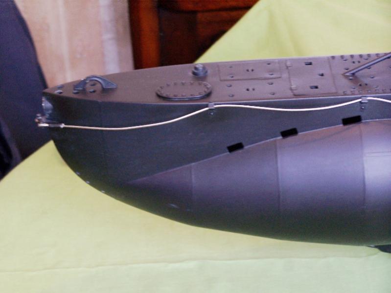

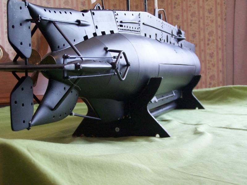

                      Here are some photos of Alan Poole's model.

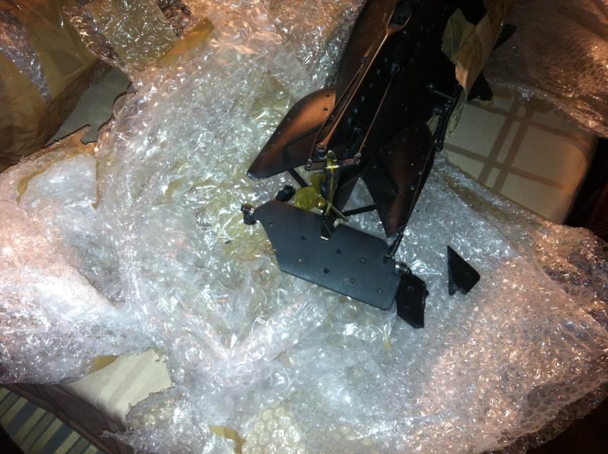

                        At long last, I secured a complete model of the X Craft by Alan Poole. It arrived yesterday from England and those bloody neanderthals at UPS dropped it on one end and crushed the tail.
                        Of course, these were all the parts needed to mold for the other hull Alan gave me.
                        The package was well done, lots of padding.
                        The disappointment of seeing all the parts I need in pieces. They managed to bend a 1/8" shaft in two places, snapped off the bearing housings and shattered the control surfaces.
                        I have a rep coming out to inspect the damage tomorrow.
                        In the meantime, what is the best remedy to fix this? Are the 'chicken legs' repairable?

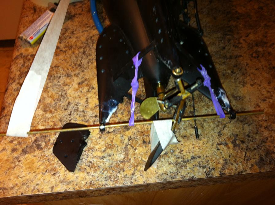

                        The shaft collars on the end of the legs hold the rudder shaft, and they'd had a brass rod threaded into them (where the set screw usually goes, and this was inserted into the end of the 'leg'. The resin leg snapped off at the end of the rod, about 3/8" down the leg. If only the rod had been an inch long, this would never have happened. I'll spec that into the new kit eventually.
                        I decided to effect a repair, so drill holes into the leg and the bit of snapped off resin holding the shaft collar. I made them oversized of the re-bar I was to use, to enable me to have some movement as I lined up the two parts. With the re-bar inserted in the 'leg' I gave it a dry run and both parts were able to line up on the break line.
                        Then I filled the drill hole in the 'leg' with a mercaptin hardening epoxy (5 min), pushed in the re-bar, dry fitted the collar part, and left it to set up.
                        Once that was hard, I mixed up some Phenol novolac epoxy, painted over both faces of the joint, letting it run into the re-bar holes, and then fitted them together. There were some spots where the resin was missing as it shattered, so I filled those areas with epoxy mixed with Cabosil so it was a non-slumping paste.
                        The really difficult part is to keep the parts completely lined up while this strong, but slow curing epoxy cures overnight.
                        I placed a shaft through both dive plane collars and fixed two elastic bands to pull the parts tightly onto the 'legs'. The force tended to pull the parts down slightly, so I used some masking tap (left) to exert a slight upward lift.
                        Tomorrow will tell the tale as to whether this repair will be strong enough.

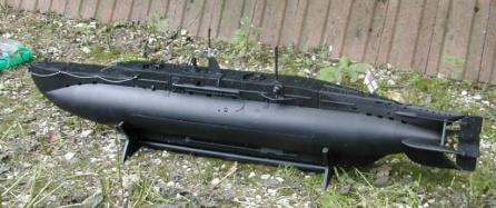

                        Here's the same boat before UPS butchered it.

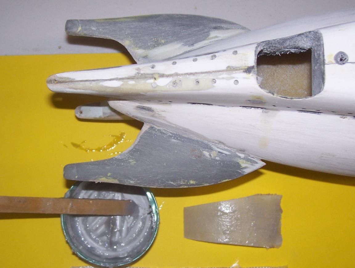

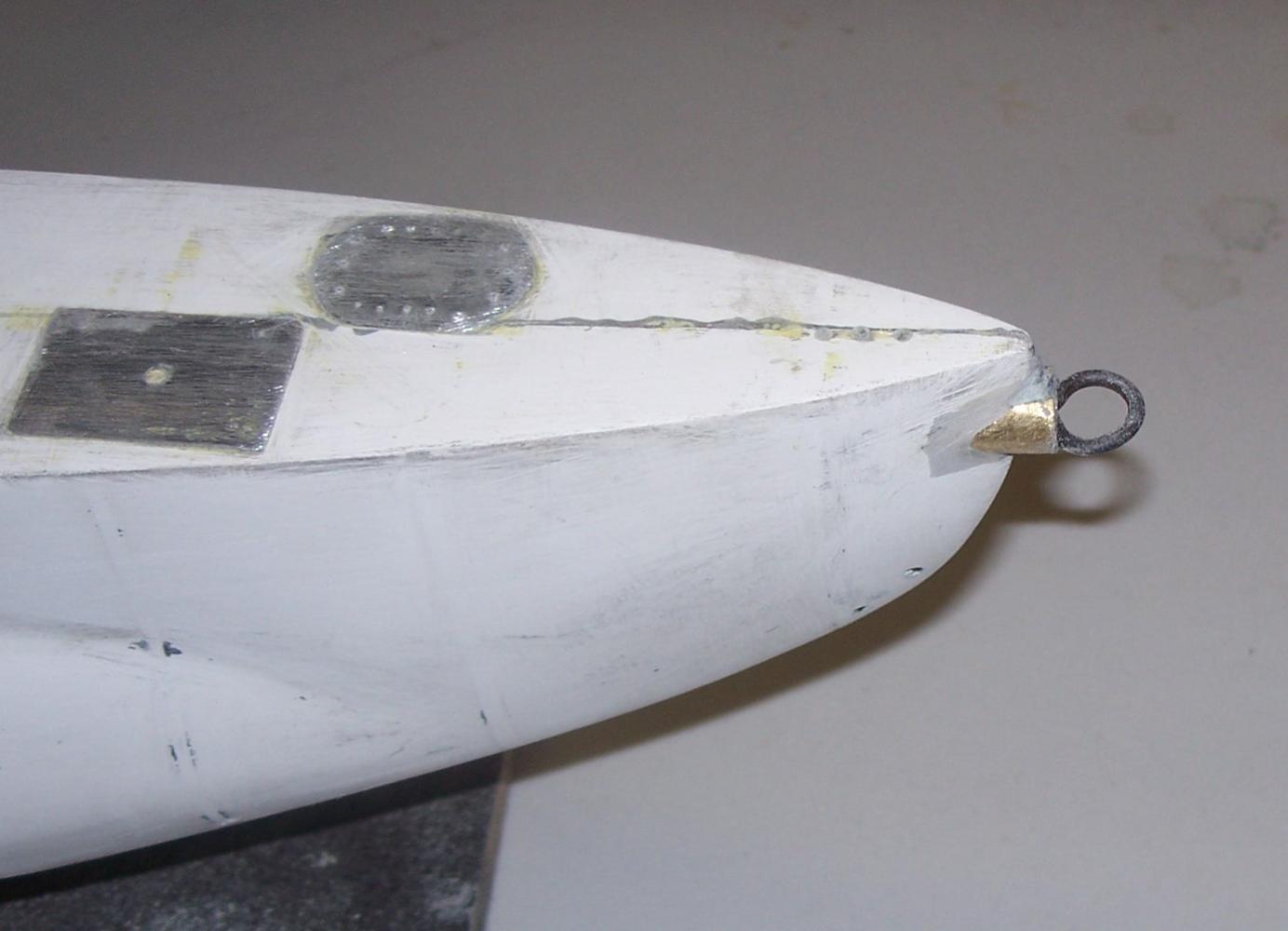

                          I've been slowly altering one of the Darnell hulls to get a better shape, it still looks to me as tho the deck /casing is a bit wide. This is a hard one to fix....

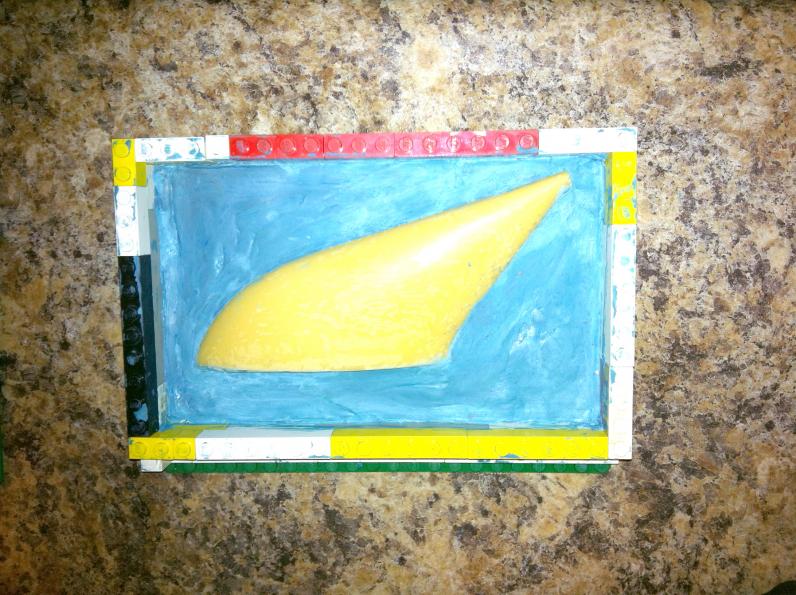

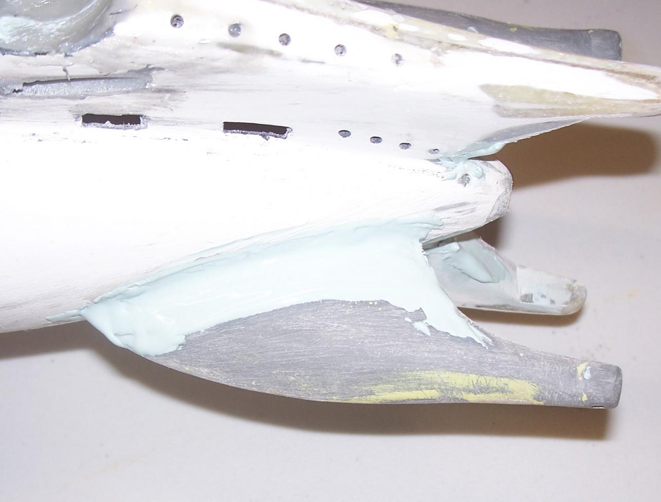

                            Here is the rear (and only) dive planes. The diagonal stripe on the right is the repair of a complete break where this was sheared from the boat. I'm using Skulpy, Lego and a Freeman rubber to make a mold of it. Looking OK so far.
                            I have a pair of 'chicken legs' from the boat sent me by Alan Poole, so while I'm at it, I may as well make the mold for that.
                              I have both models here, the Darnell one and Alan Poole's. The latter is more accurate than the actual boat at the Museum, as that ran out of funds and was cobbed up, apparently.
                              Post some pictures of your build and ask for dimensions, and I'll take them off my boat for you.
