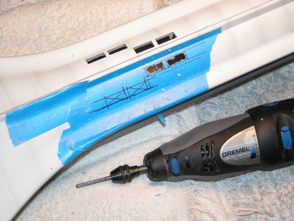

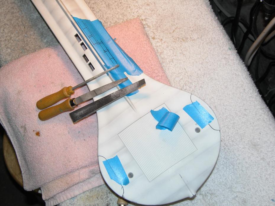

    Well, for the first time this year (other than the recent Carmel SubRegatta) I got to play with one of my toy submarines. I spent the morning getting my Moebius SEAVIEW ready with the addition of a set of flood-drain holes near the bow, followed by the normal pre-mission checks.

    Seaview Bow Blow Openings
    Tell us more on why you needed the new forward blow opeings? How did you determine where to cut them and the overal area required? Was this a last min. fix or had you known of this issue long? I am finishing up my Seaview and still have time to cut these holes if needed. Do you think that if you had left the origional display stand keel oenings alone, that this would have provided the needed water flow?
      • 13936
      Without the new flood-drain openings and the pump-jets going 'ahead', a partial vacuum is created within the hull that prevents filling of the ballast tank when the vent valve is opened. The opening bust the vacuum so the boat can submerge while underway.
      Start with the two open stand holes, if that's not enough open up the holes near the bow like I did.

          Ps - thanks for posting the photos of drilling those holes out - just learnt something with the low tack tape over the top to prevent filing causing fraying edges.
          I have been using other tape (more sticky) that did not seem to work that well in this regard
