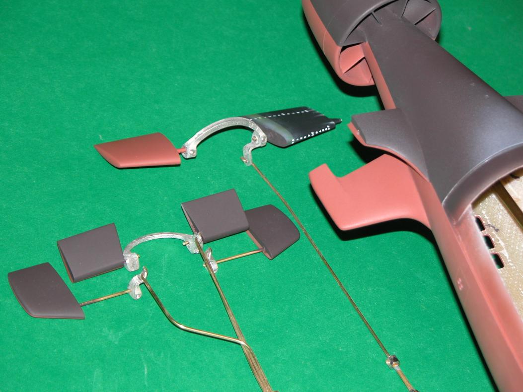

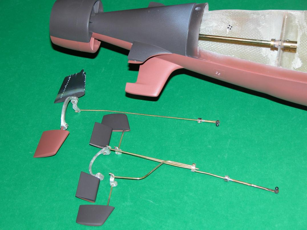

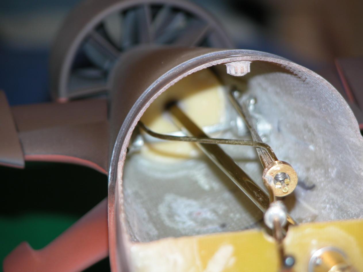

    I have noticed that some people use individual horns and push rods on stern planes and or rudders. I prefer U type yokes / horns connecting the planes Left and right together / upper and lower rudders together, and having just one push rod for planes and one for rudders. For those who have individual horns and push rods per planes and rudders, I was wondering how people then link the two push rods together for one connection to the WTC?
    Pictures would be great.

    A wheel-collar.

        Another way is to wrap some tinned wire around the two linkages and solder them.

          Which denies you the opportunity to make differential adjustments.
            You can fit turnbuckles.
