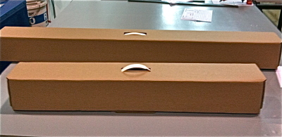

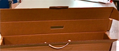

                    Here are the prototypes of our new carrying boxes. They are being shipped to me today, and I hope to have them by Friday. As soon as I do, I will take some photos of the waterproofing resin procedure.

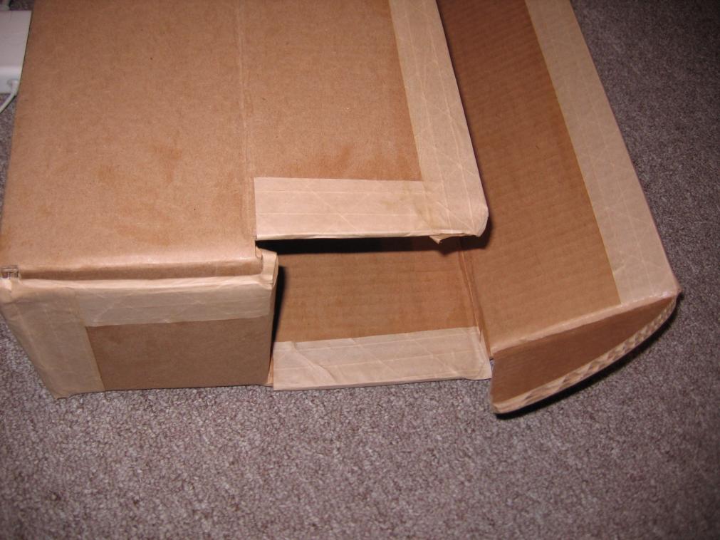

                          The edges of the cardboard Tri-wall needs to be blanked off and sealed, and I have found that the standard kraft paper reinforced box tape is ideal for this.
                          This tape has thin strands of fiberglass bonded to the adhesive side, making it extremely tough.
                          By cutting lengths of tape and wrapping them over the edges, a fairly neat looking job can be accomplished in a matter of minutes.
                          It would also be worth considering using the tape to strengthen the folds of the lid. Prior to doing this, I think it would be advisable to run a blunt object along the folds, to push the tri-wall together. This would make it hinge easier.
                          Once the tape glue has dried, apply the first coat of resin, mixed with some lacquer thinner. This need to be the consistency of water, so it really soaks into the board and paper. The whole thing will look like hell at this stage, but leave it to cure overnight, and then you can trim off and protrusions, creases etc by sanding.
                          Apply a second coat of resin to the entire box, still thinned with a little lacquer thinner, but to the consistency of maple syrup.
                          Finally, you can paint the entire box with whatever enamel paint you prefer.
