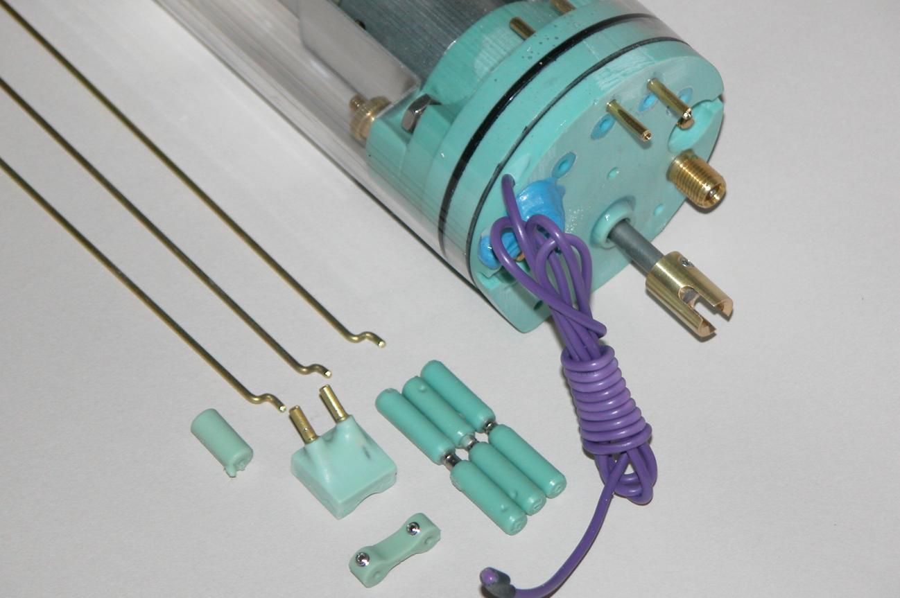

    Here you can see all the parts required to get operational.

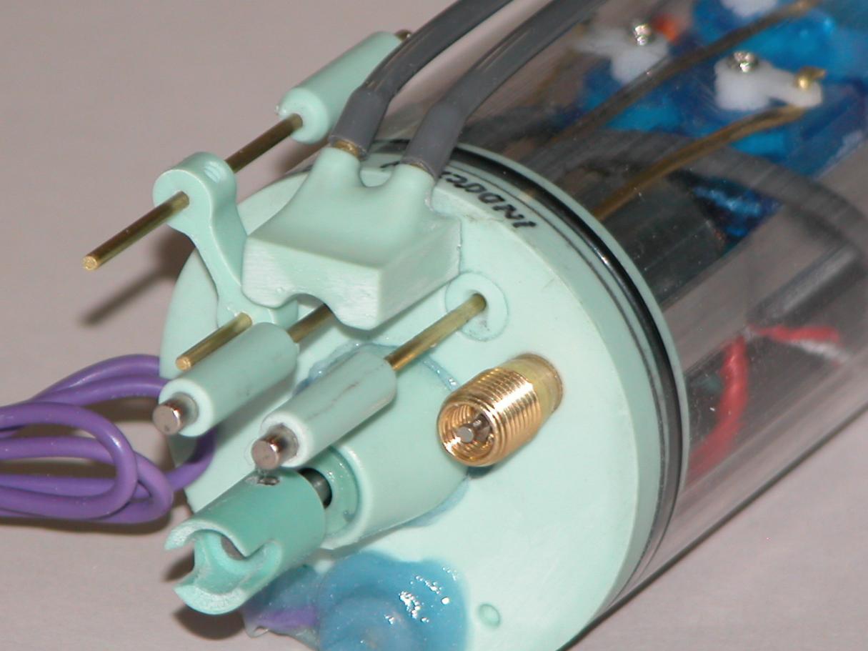

    You can see the Snort tubes penetrating the end-cap. These are fitted with plastic tubes that run to the Snort Pump inside the Sub-driver. Externally, the plumbing block is fitted over them to redirect the tubes forward.

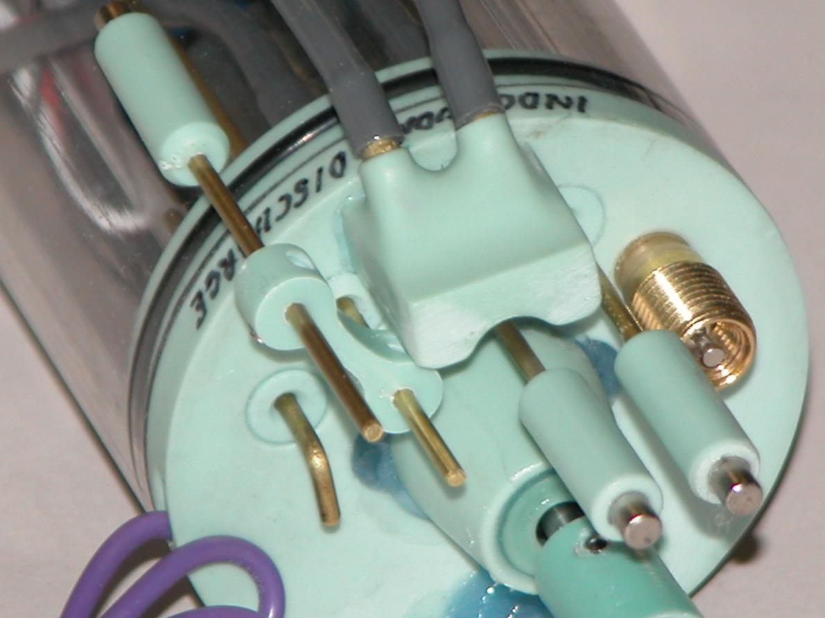

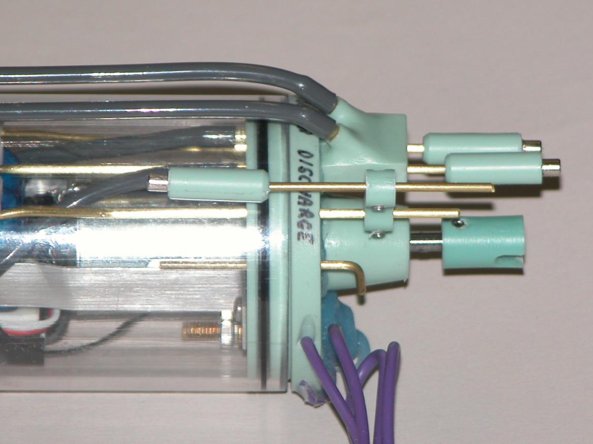

    The plumbing block installed.
    I like that very innovative looking connector you use to couple the servo output and bow plane rod together.
      • 14010
      The dumb-bell looking thingy? KISS.
        Yup. I was gonna mention that "dumb-bell looking" thingy.
