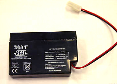

    Since the 3.5" Sub-driver was designed to use a SLA battery and I Like them, that's what I'm going to use in the T-class model.
    In most of my surface ships I've used the large 12.volt 7.Ah size, but I was thinking about using a lighter weight battery in this sub. So I am considering using the smaller .8Ah size (see 1st picture).
    Is anyone familiar with this battery and how many *Days* or *Thousands of Miles* it will operate a model sub before needing to be recharged? :D

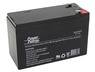

    Or will the 1/48th hull handle the weight of a 7.Ah size (2nd pic), which I have already?
    I know it will fit but is it too heavy and cause a problem with balance?

    I found out that the .8 Ah batteries weigh 1 pound,
    The 7.Ah are 6.1 pounds.
    Is 6 pounds too much???
    (It will be mounted a little forward of the Center of Hull, length-wise.)

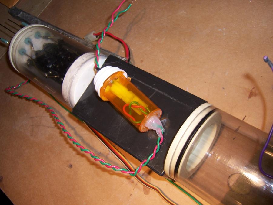

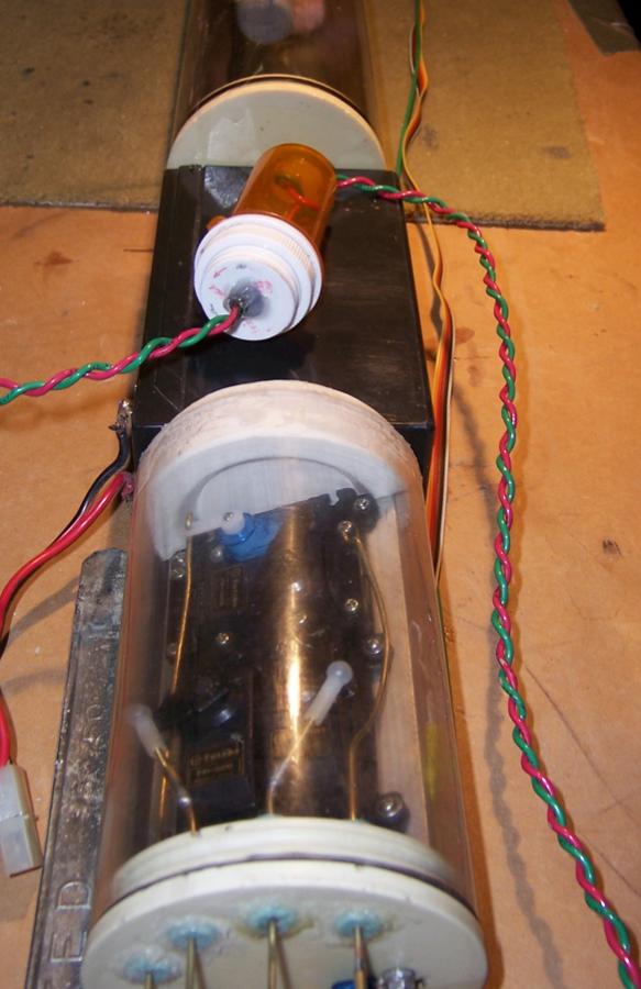

                        Here's some pics of my handy-dandy pill-bottle WTC for battery connector.
                        It will be soldered directly to battery after I deside which size battery I'll be using.
                        That's a 7.Ah battery in pic.
                        The short 3.5" WTC in pic, with 4 servos in it, is the one I constructed. I moulded the RTV attached rear end-cap for it, using a similar type resin that David uses. The rear end-cap is sloted to hold the servo tray rigidly in place. Having servo trays attached at only one end is Not good, too much flex.

                            Rick that is a hell of big connection housing.
                            I hope it doesn't leak.
                            BTW - what type of WTC (ballast system) is in the photos.
                            J
                            sigpic
