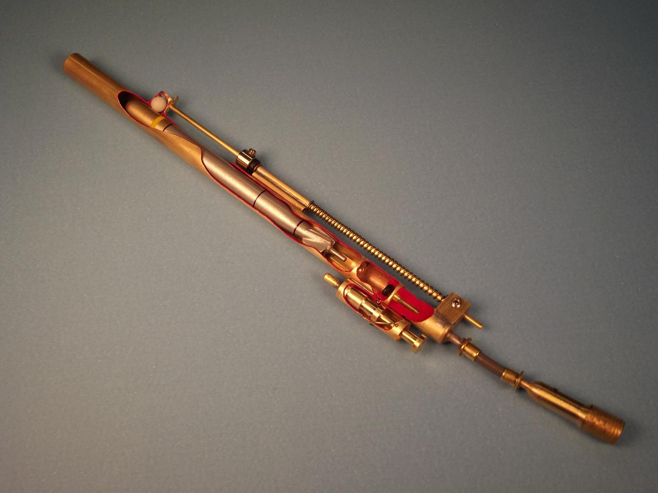

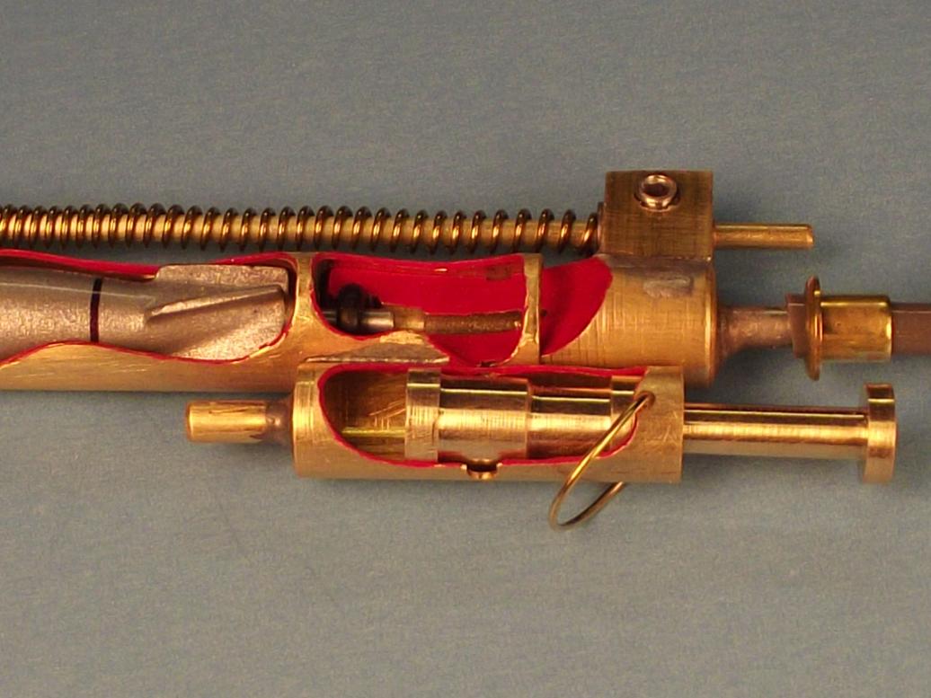

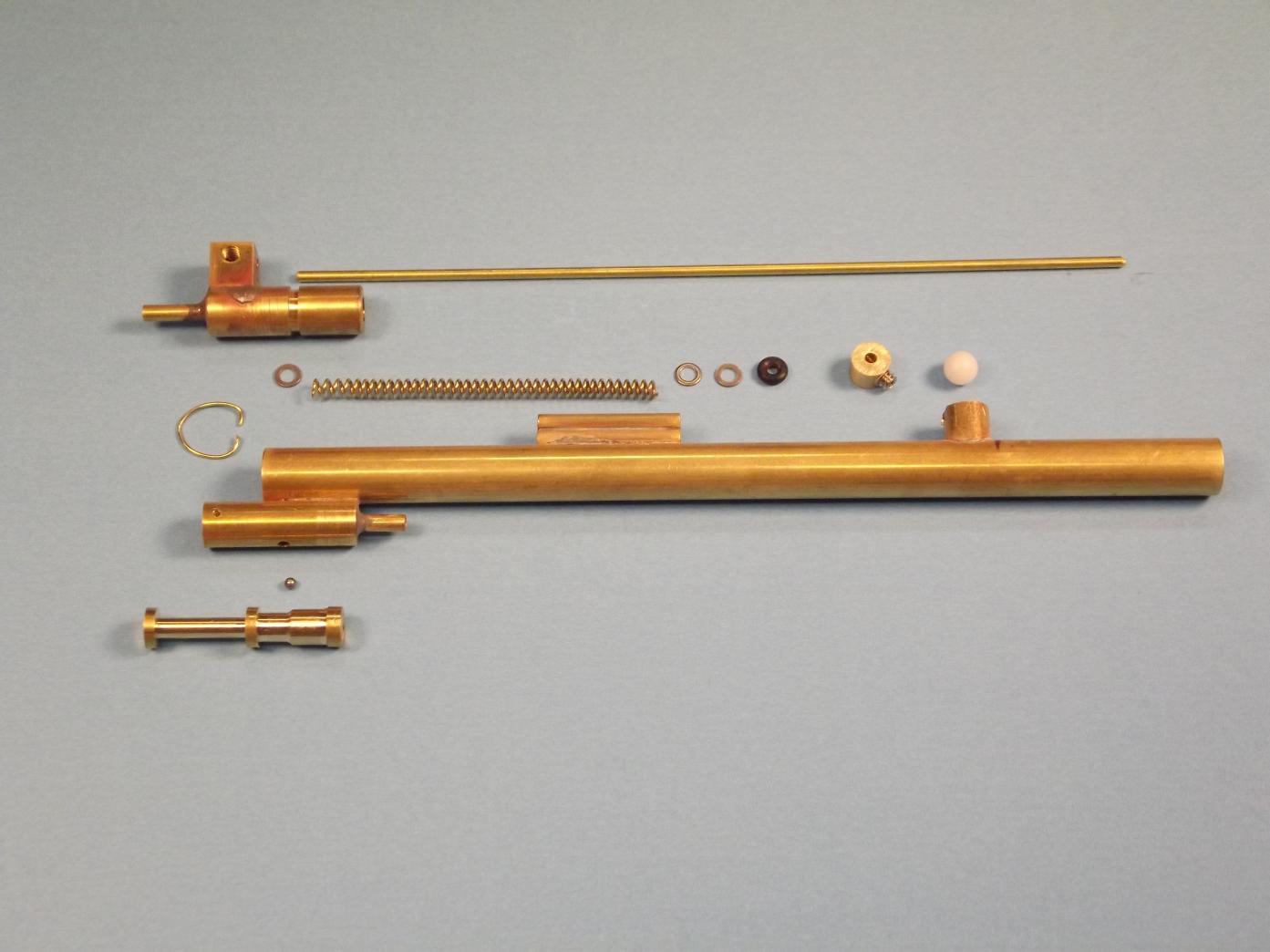

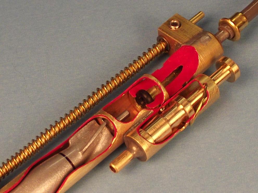

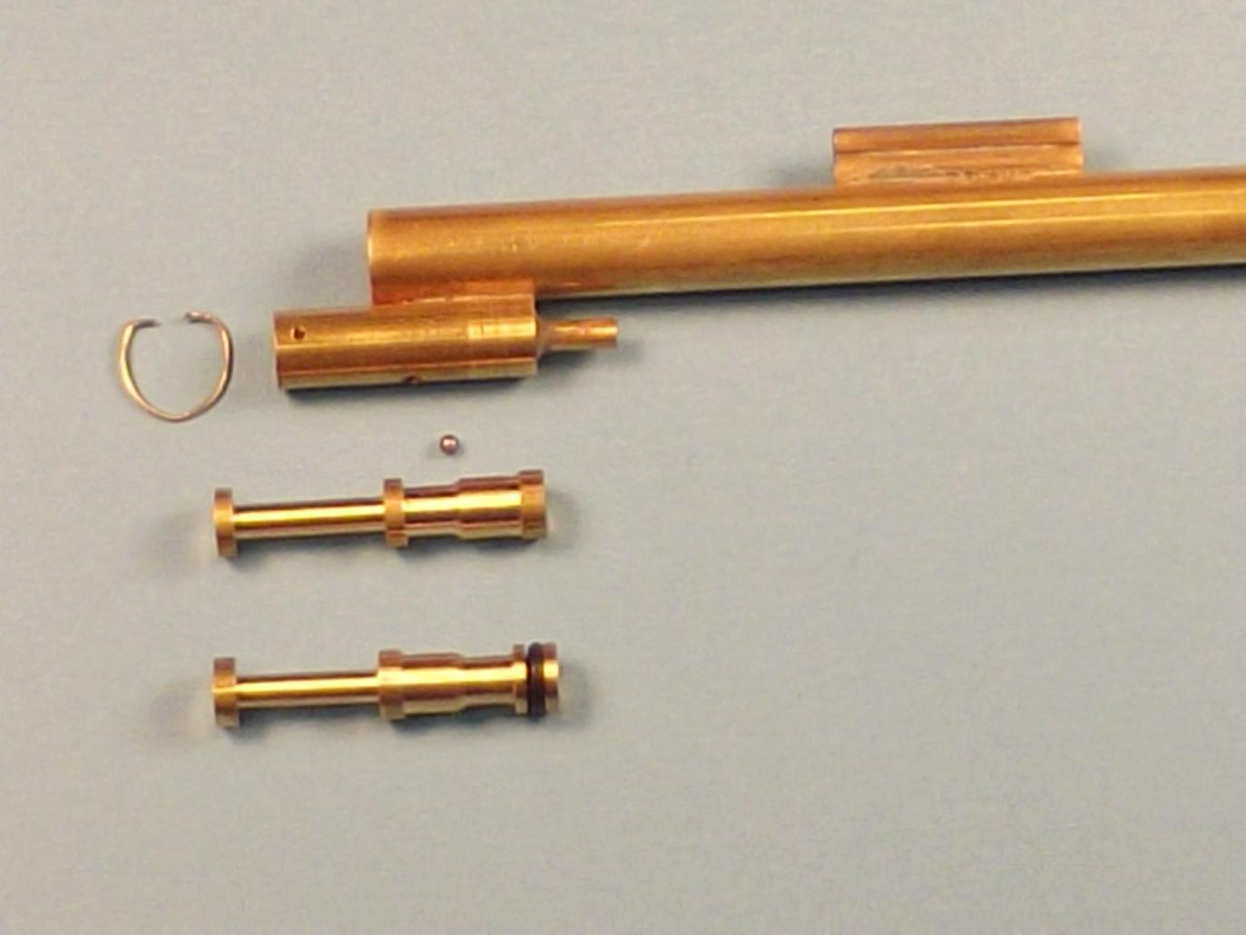

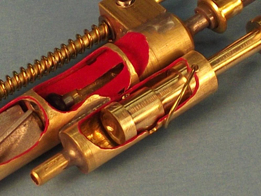

    You're trying to introduce the locking ball through the shuttle cylinder -- bad hockey! You introduce the locking ball through the breech end of the torpedo tube. Duh!

    Order of assembly is everything:
    1. remove the breech block (loosen the interlink set-screw and pull the breech block clear of the launcher)
    2. install the shuttle and place it in the 'launch' position
    3. into the breech end of the tube, place the locking-ball into the hole for it and push it down to engage the shank of the shuttle
    4. re-install the breech block and cycle the launcher to the 'battery' condition (ready to launch)
    5. test
    6. five Hail-Marries and a promise to never trouble me again!
