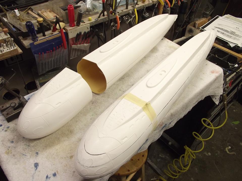

    They've been sitting here while I work to get out from under back-orders. This week I played hooky from the production work and set about the task of making an equatorial cut at the waterlines and gluing together the bow and stern pieces. What I got with the two kits were assembled forward and after hull halves with the radial break near the bows. Huh! Them inscrutable Chinese, ****ing with me again! We'll fix THAT!

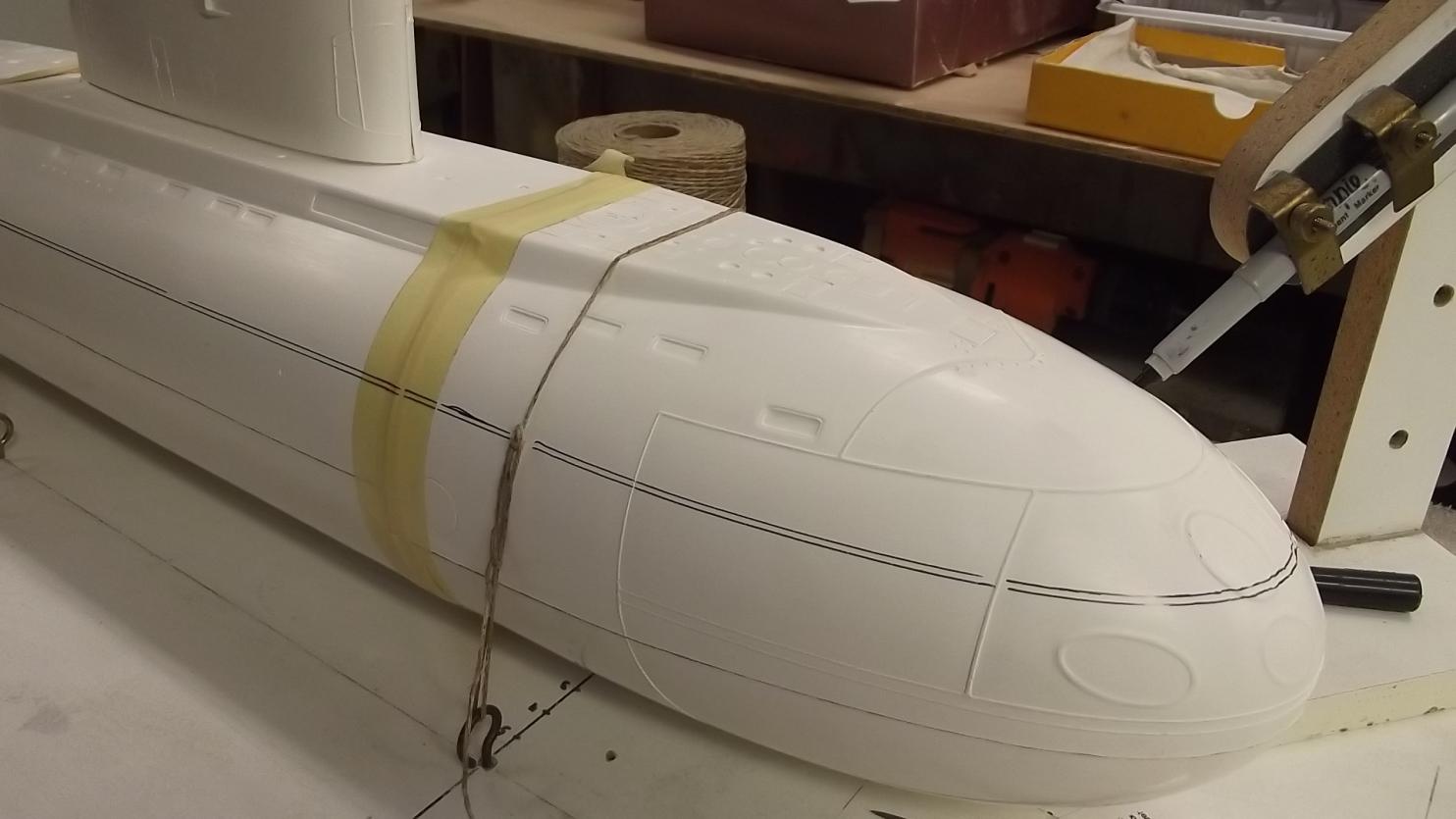

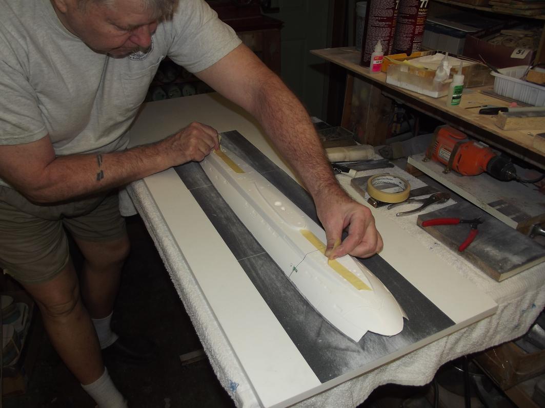

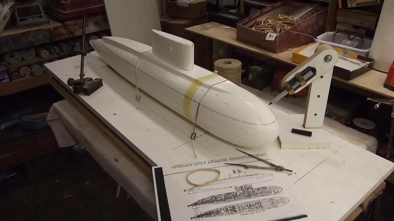

ID:	103498 So, I tape the bow and stern together as straight as I can, mount the hull on my molding board, strap it down, and use my waterline marking tool to establish the kerf zone. As long as I keep the cut within those lines I will be able to later accurately re-establish the height of the lost material (eaten up by the cut-off wheel used to make the equatorial cuts) and make it back up with filler or CA-baking soda.
ID:	103499 The surface of the board is my reference plane (datum plane) off which all vertical measurements and tool heights are set. I strap the model down with sail-twine (the wax impregnated weave will hold a knot once cinched down). Under the hull, glued to the mold board, is sandpaper which keeps the model from sliding around.

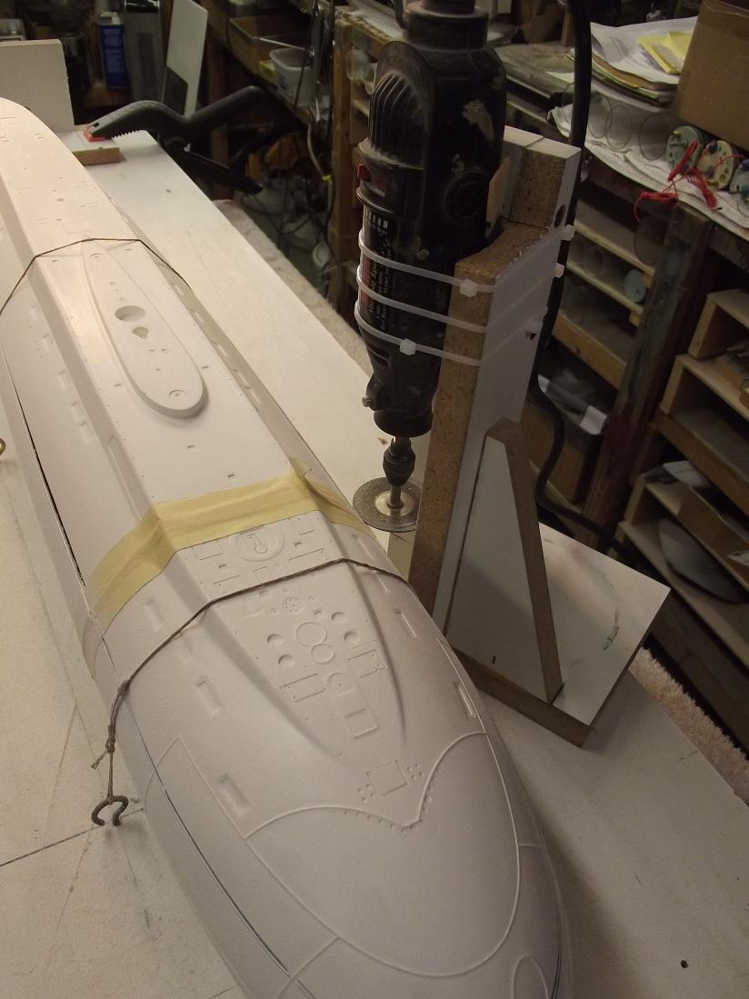

ID:	103500 Click image for larger version

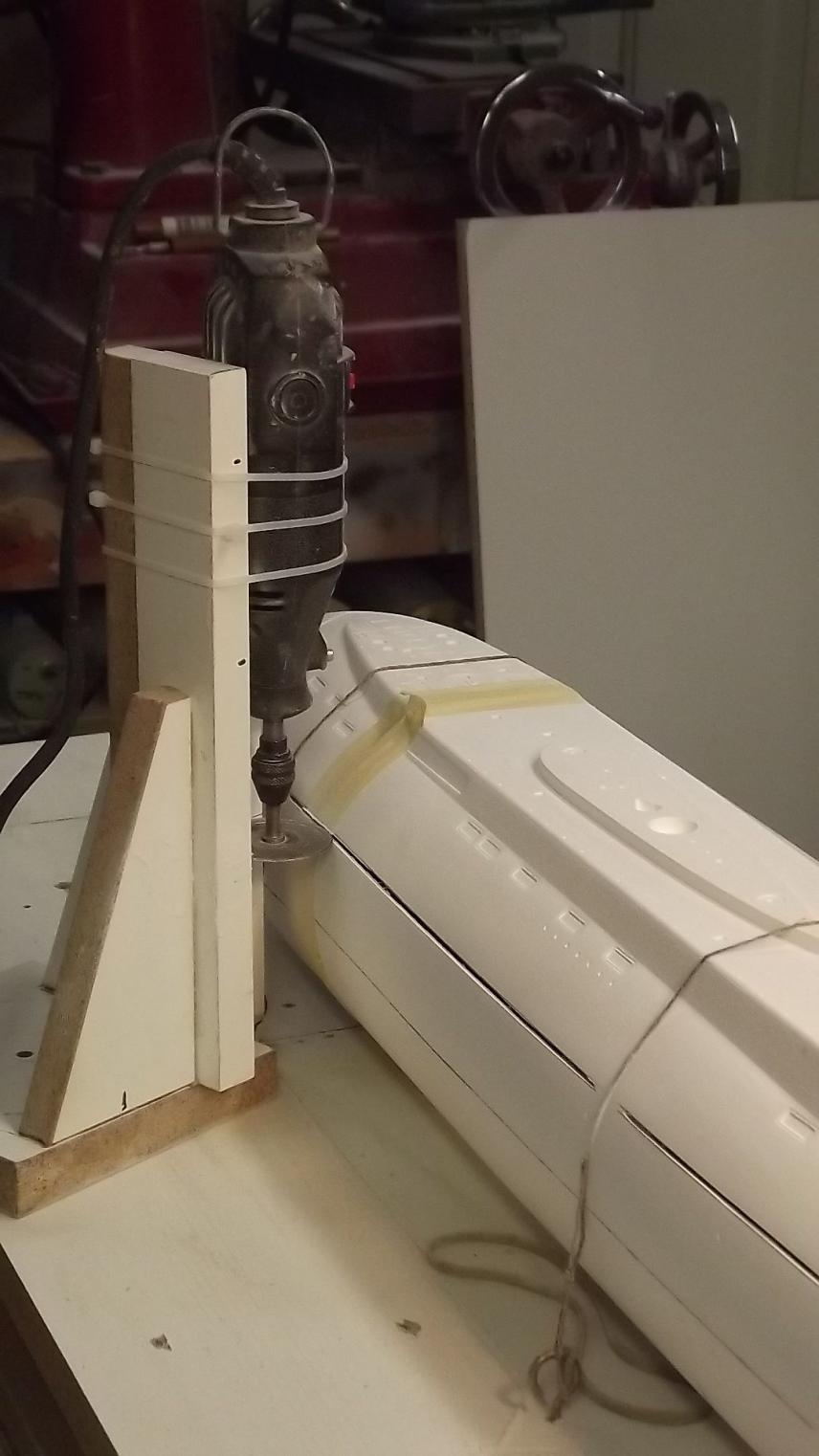

ID:	103501 The twine straps are glued at the top of the hull to keep things from rotating out of alignment as I press against the work with my man-eating moto-tool death-machine.

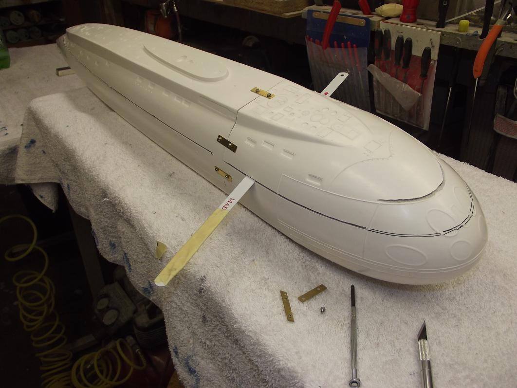

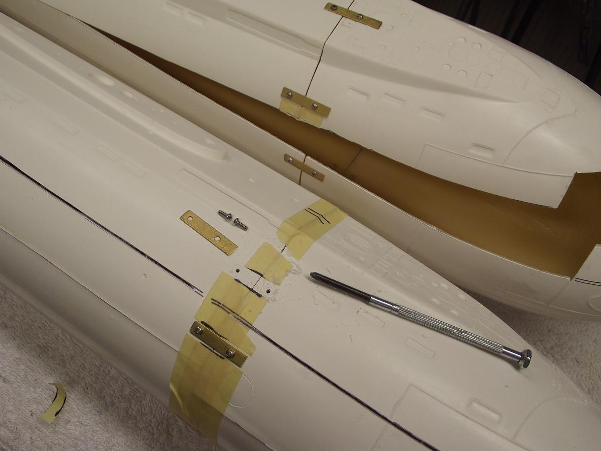

ID:	103504 Of course I did not cut all the way around the hulls -- the areas under the twine straps, and at the extreme bow and stern were left alone. Those connecting tabs between upper and lower hull would later be hand-sawed off once I strapped the radial break to hold the bow sections in place once the equatorial cut had been completed. Note the use of brass straps and machine screws to hold the bow and stern pieces together -- this done before making the final hand-cuts to complete the equatorial separation of upper from lower hull. Also, like the fine little Trumpeter 1/144 KILO kit, I elected here to make the break at the boats designed waterline -- much easier to hide this break with the book-topping and scum line. ... always thinking!

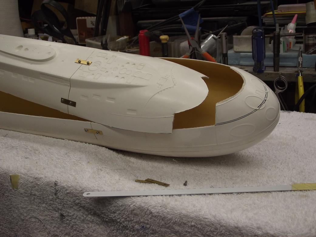

ID:	103505 The only jog away from the single-plane equatorial split was at the bow. As I wanted this to be a torpedo shooter (my boat anyway!) I made this vertical transition so I could keep all the muzzle doors on the lower hull.
ID:	103506 Click image for larger version

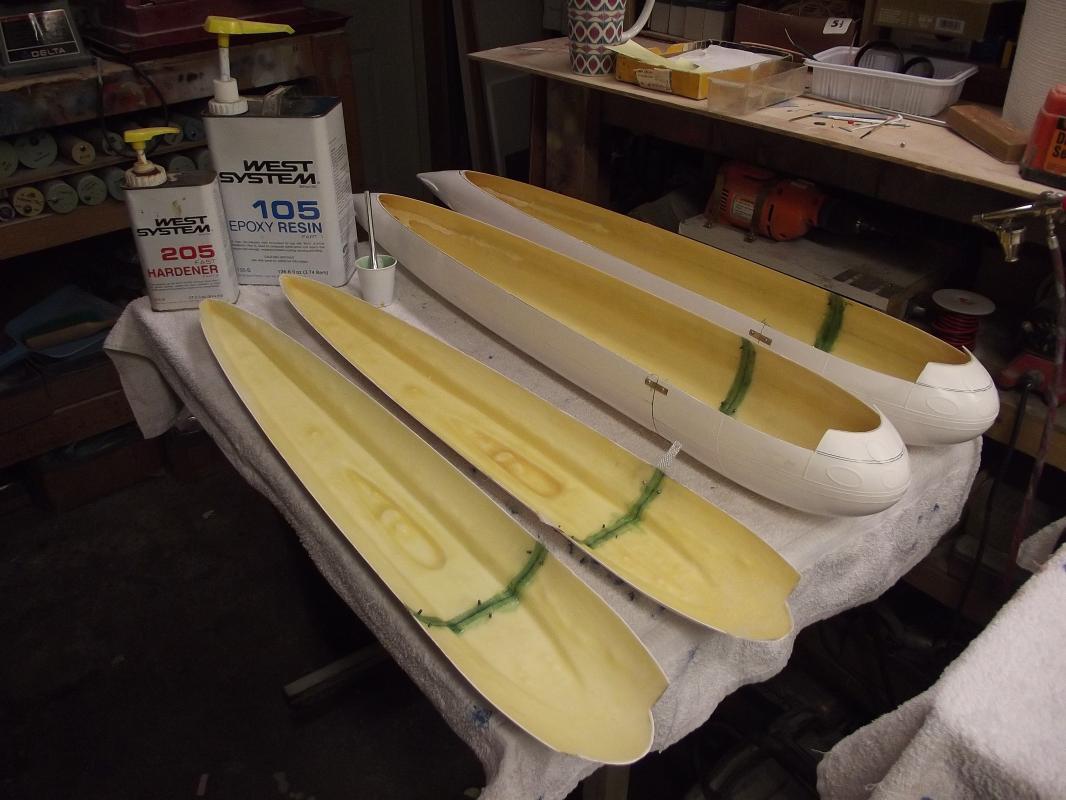

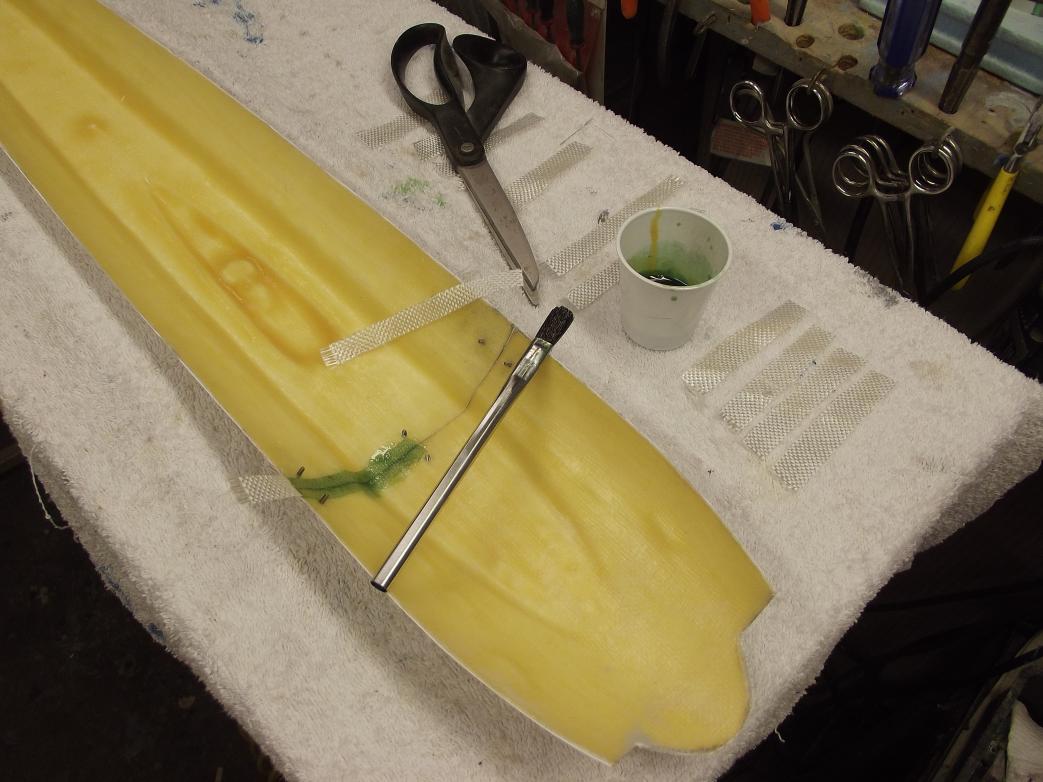

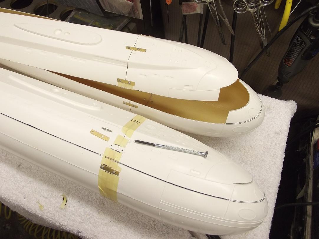

ID:	103507 All that hacking and slashing out of the way, I re-enforced the radial breaks from the inside with fiberglass tape and some hot formula West System laminating epoxy. Tomorrow, when I get up, I can take off the brass straps and lay down a wider piece of re-enforcing GRP over those breaks. Then on to the never-ending job of getting the kerf lost edges built back up and trued.
    • 3768
    Learned something new. I like how you used brass strips and screws to hold the pieces together. Nice! I am just going to sit back and learn.
      • 14001
ID:	97659 Click image for larger version
ID:	97660 Click image for larger version

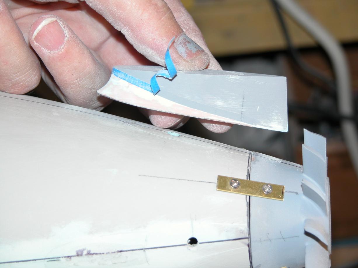

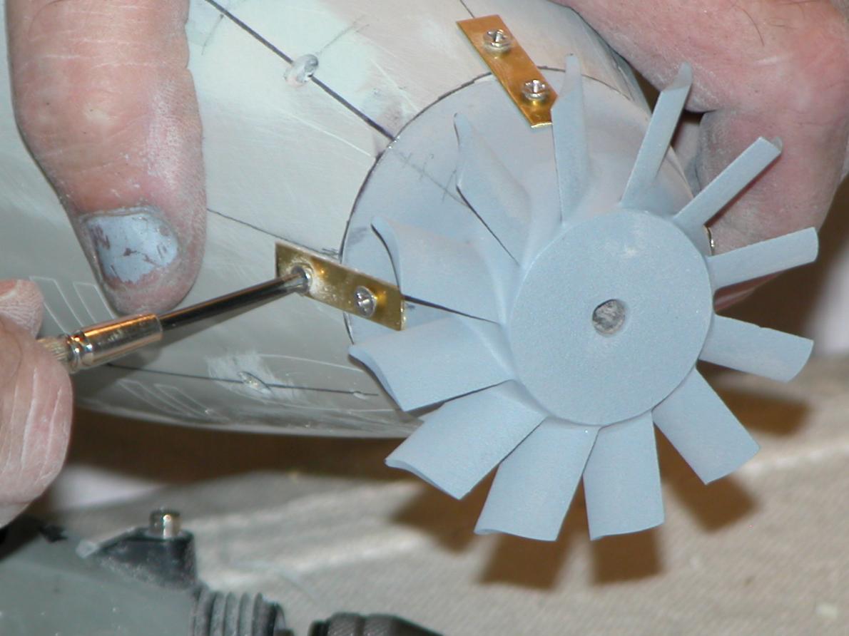

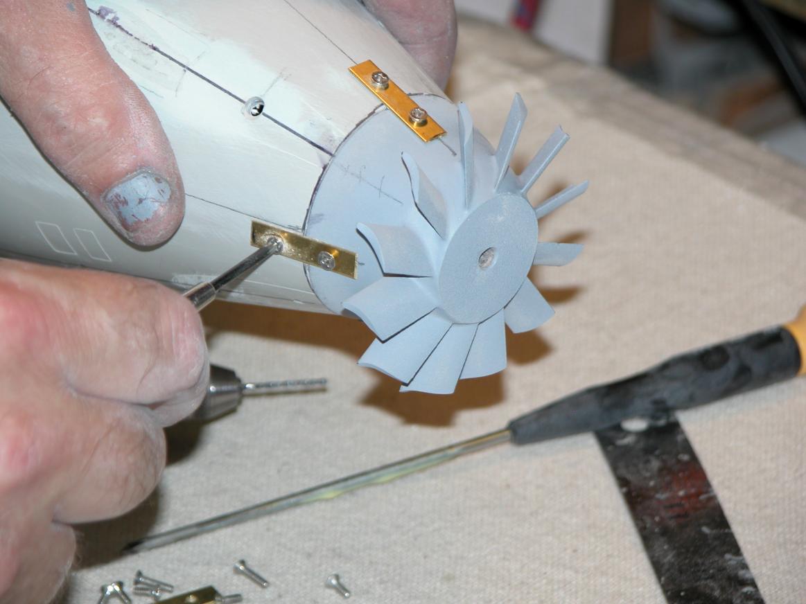

ID:	97661 Yes, very useful when you have to hold assemblies together as you affix GRP re-enforcement on the inside. Here is another example of using brass straps to hold sub-assemblies together before bonding them permanently.

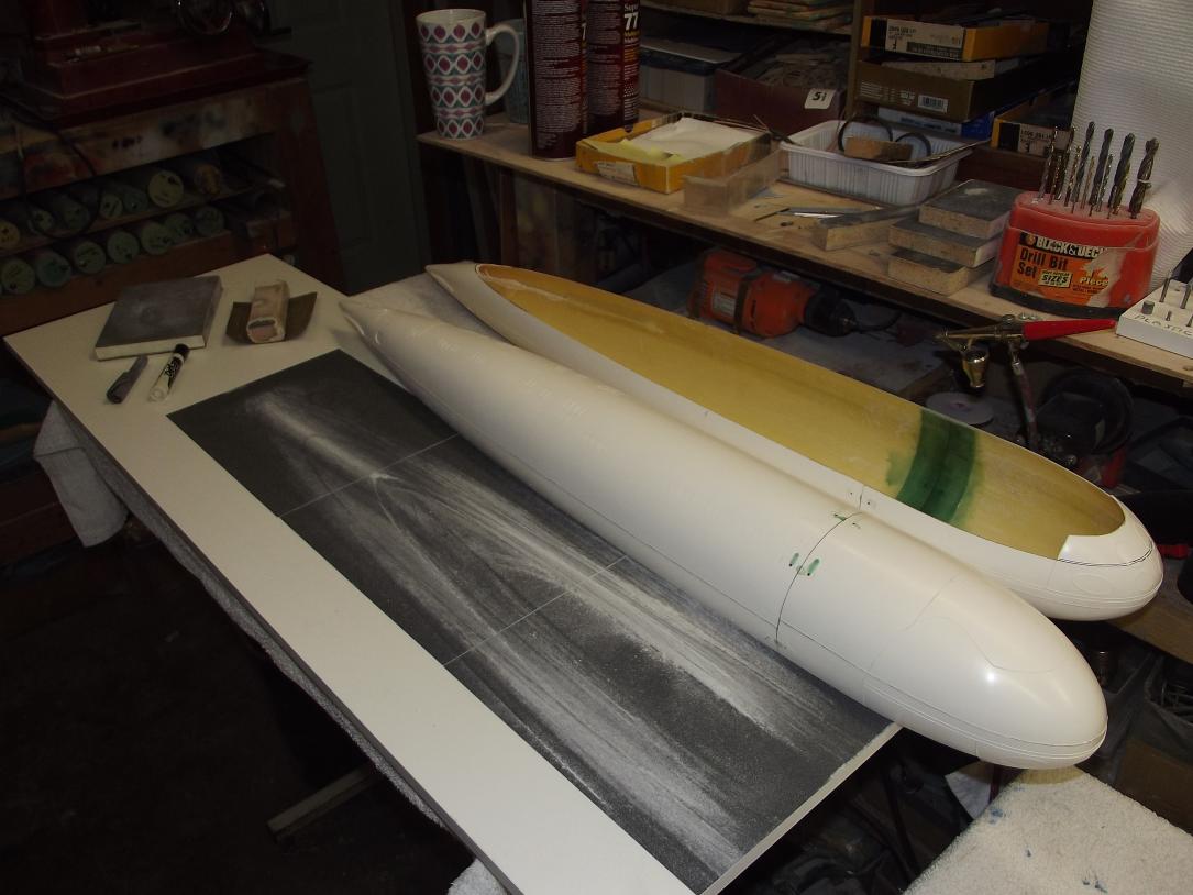

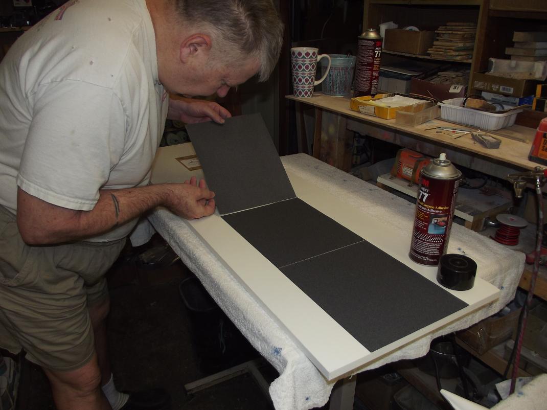

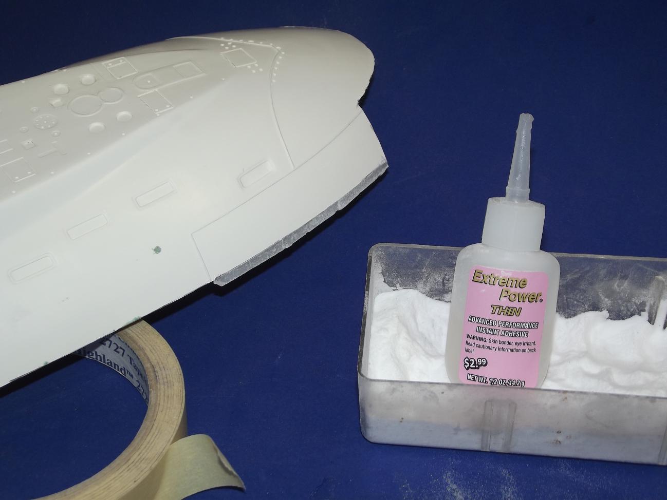

ID:	97726 I laid down some #100 sandpaper on a flat board ... a super-sized sanding block if you will, where you shove the model along the block, not the block around the model. I used that to produce the flat at the edge of the lower hull. I sanded till I was to the lower of the two parallel waterlines previously marked onto the hull to denote the 3/32" of material that would be lost to kerf (during the cutting), and sanding needed to true up the edge of the lower hull.
ID:	97727 Click image for larger version
ID:	97728 Click image for larger version

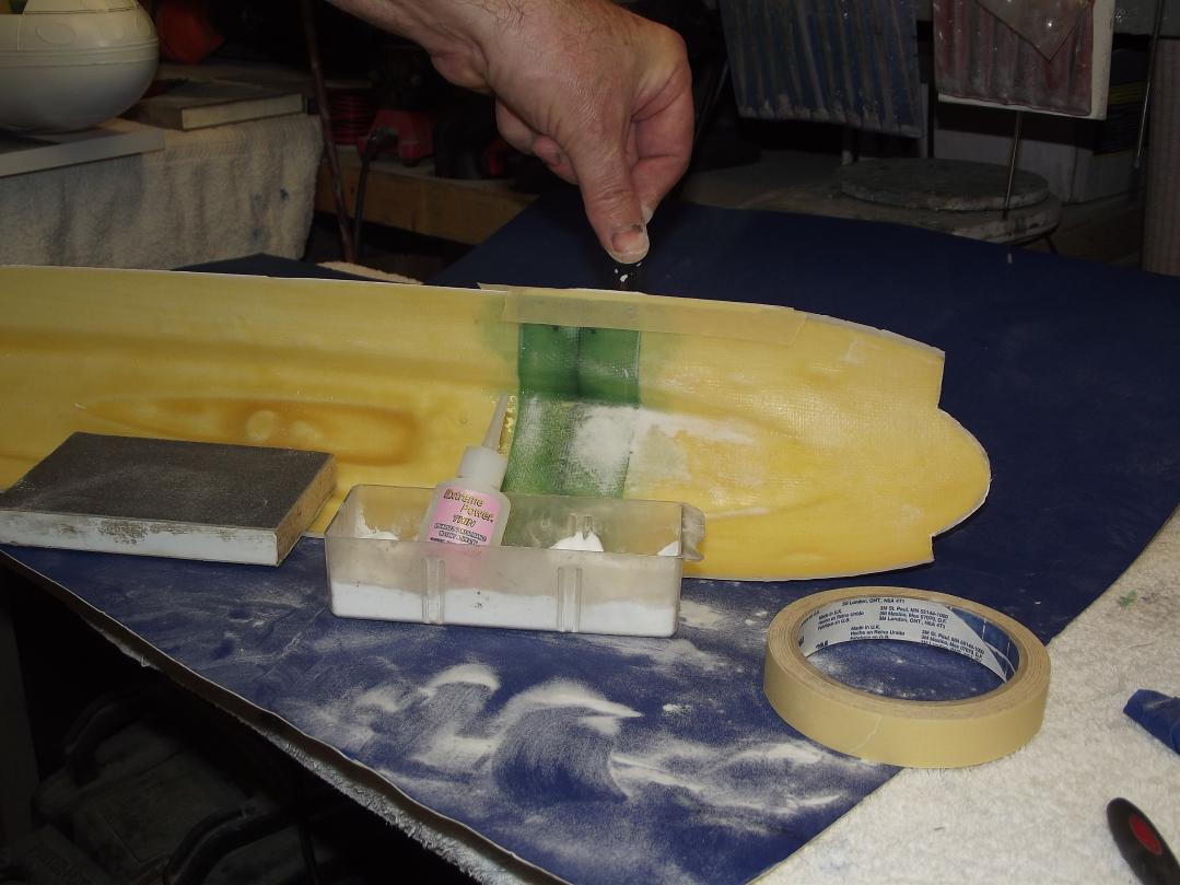

ID:	97729 I then roughed out the material on the upper hull till its edge was about even with the upper marked waterline. And then set about the task of building up, from CA and baking soda, the edge lost to kerf. After the build-up I block-sanded that edge till it was true. Then test fit the upper and lower hulls for a look-see at how tight the equatorial seam was. Going back to the CA-baking soda trick and sanding as required.

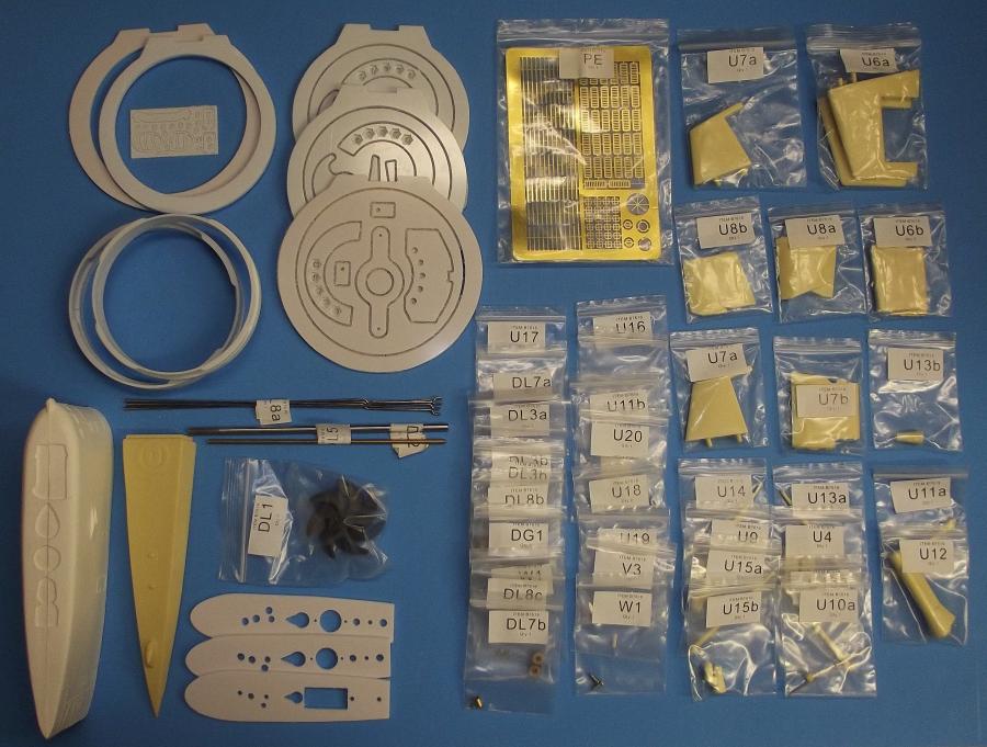

ID:	97740 Here are the other items you get with the kit -- I omitted the nice (if you can make out Mandarin) instruction booklet, and GRP hull parts. Comprehensive.You get an acid-etched brass fret, some water-cut plastic structural parts, and parts to build this thing as either the Project 877 or Project 636 class. But the propeller provided (cast resin, carbon re-enforced?) is right-handed, not left-handed and only represents the wheel used on the 636 boats. Damn!.... gotta build another ****ing propeller master, tool, and metal parts! IT'S NEVER EASY!!!!?????

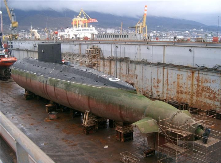

                      I have never seen a pump-jet with such a high inlet/nozzle area ratio! WTF is going on in there? I've seen yard pictures with a rotor and stator, but that only leves me wondering if there were multiple rotor-stator stages in that tunnel looking shroud. It appears to be the later Project-636 desgin of the KILO, but kept in national service -- not exported. Or ... so I've read.
                      Good catch. NASTY! Just the way I like 'em.
                      Stop tempting me with this neat **** -- I'm falling behind again!!!!

                              [ATTACH=CONFIG]30370[/ATTACH] [ATTACH=CONFIG]30371[/ATTACH] [ATTACH=CONFIG]30372[/ATTACH] Yes, very useful when you have to hold assemblies together as you affix GRP re-enforcement on the inside. Here is another example of using brass straps to hold sub-assemblies together before bonding them permanently.
                              I must have mis-understood. I thought that these pictures of the pump jet(above attached)....(and pictured below) were part of the Kilo kit.
