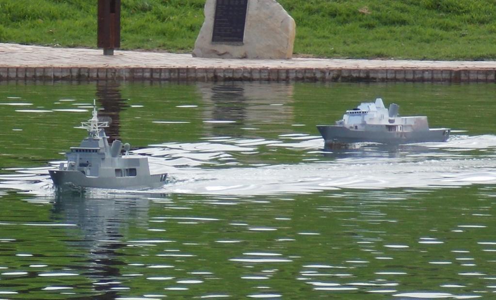

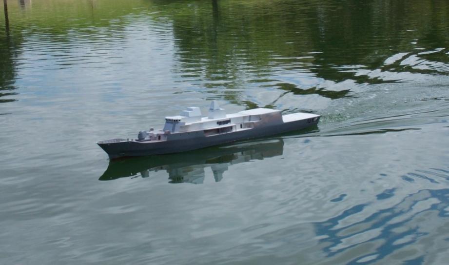

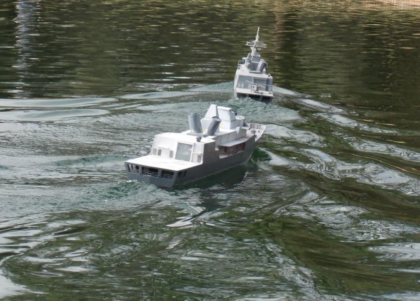

                Ah!!
                I had same issue with the ANZAC I am slooowly rebuilding for Graham, needed a bit more grunt for scale speed and tried a few combo's of batteries. Everything from two 12v 7.2ah, then 3 6v10ah (which proved to be too bow heavy...), finally settled for a pair of 7.2v6.8ah Nimh stick packs ($25 ea from ebay with aussie type 240v trickle charger) in series giving 14.4v which gives a good speed and reasonable runtime....
ID:	91703Click image for larger version
ID:	91704Click image for larger version
                HMAS ANZAC with Scott's HMAS Parramatta last year....Parra is a little faster she runs Mazda fan motors($5ea from auto wreckers....)
                Cheers Bruce
