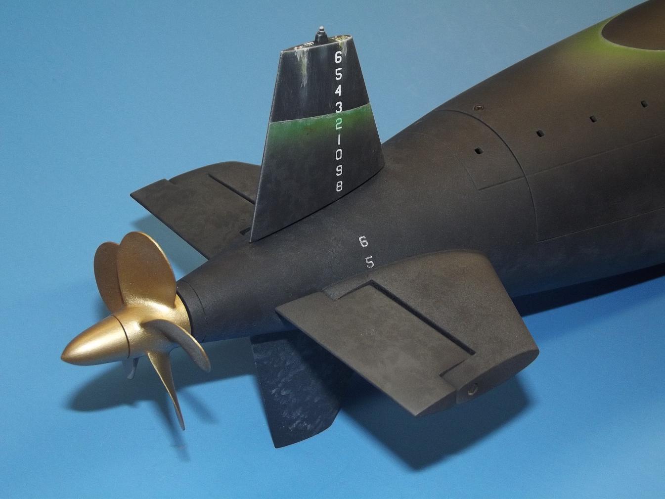

ID:	98609 That's the dorsal rudder. Which, on this model, is active and responds to roll. (Actually, the phase-2 ALBACORE did not have an active dorsal rudder, so I'm a bit out of scale with this display). A fortunate accident: the dorsal rudder servo chatters a bit when the LPB is running -- which turns out to be a useful visual cue, telling me that that pumps working when I command it to. So, I'm not going to do anything about the twitching you see in the video.
              The excellent depth control during radical turning commands -- which would be all but impossible on a normal boat -- is because the dorsal rudder works to keep the boat from rolling inboard (a consequence of sail 'foil' roll force) as the angle-of-attach shifts when rudders yaw the hull about.

                [ATTACH=CONFIG]31410[/ATTACH] That's the dorsal rudder.
                Thank you for the correction. Now that I think about it, it was dumb to call it a plane because the controll surface is vertical in orientation.

                  Not dumb, as it effects a torque about the roll axis, it would be properly called an aileron. But, I digress!

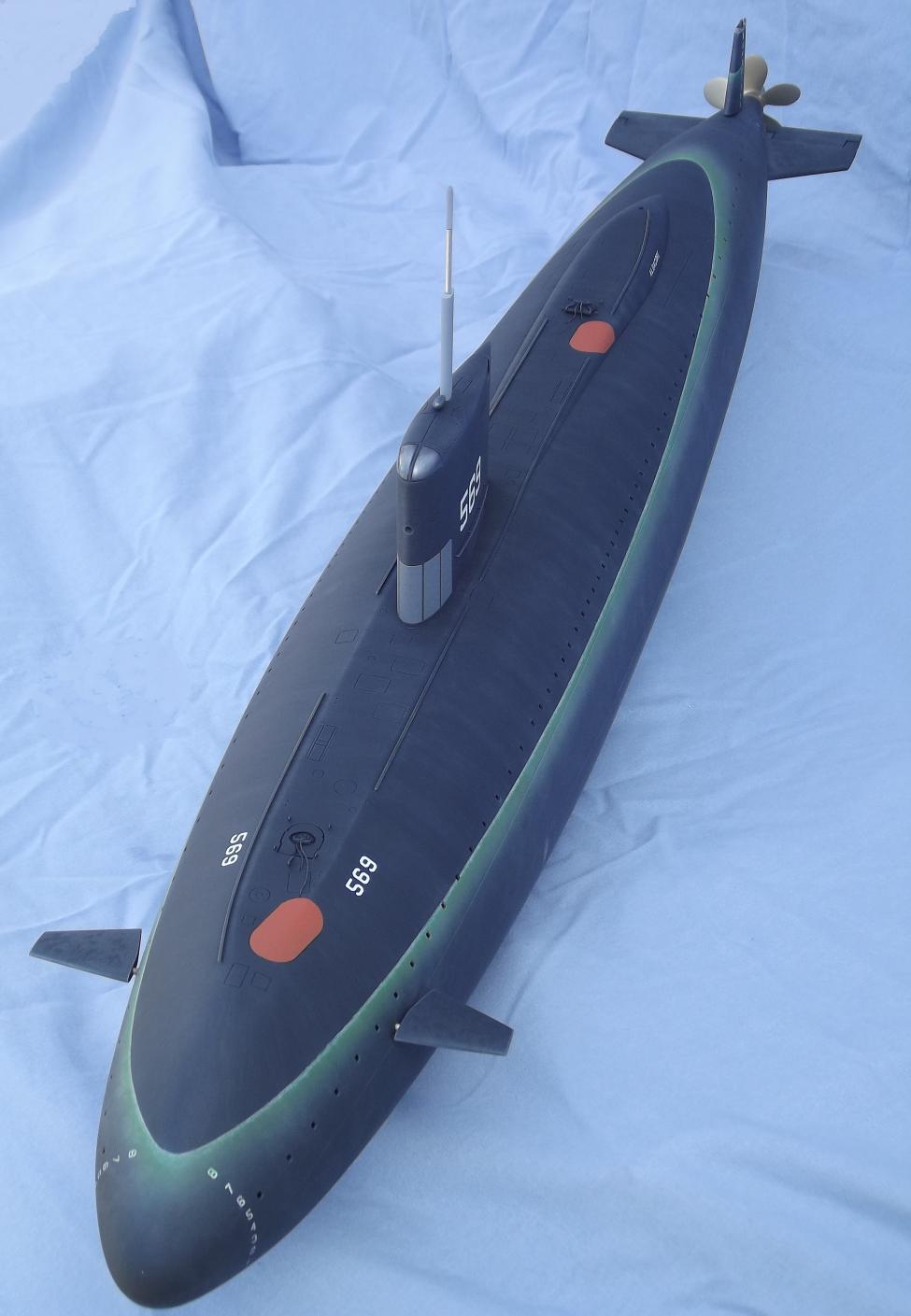

ID:	98615 The Caswell-Merriman 1/60 kit of the ALBACORE has progressed to completion of the masters, next job is the tooling. Then crank out the kits which will feature GRP hull and resin sail and appendages, with cast white-metal detail pieces.
                  And never mind what Skip or Matt think about this new 1/60 ALBACORE kit. Skip's hanging it up, and Matt has failed to crank out a new kit in ... what ... ten years?
                  With regard to Matt Thor: He had a good run (with my help) in the 90's. But he's long since run out of gas. So much promised in the last few decades. So little delivered to the buying public. So, for my part, enough courtesy waiting on Matt Thor to get product to market; enough of his many announcements of 'new' product -- that dodge is getting old! Me and Mike are plowing on.
