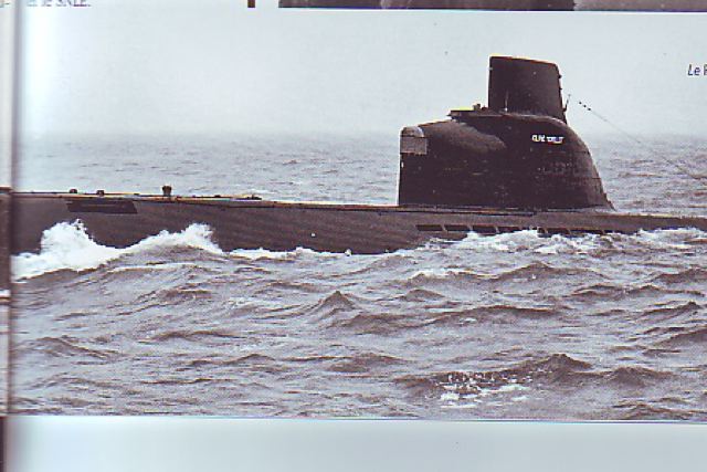

    I'm new to the RC Submarine business, so I'm starting out small. While waiting for my 1.25 inch sub-driver from Mr M., I have been researching which version of the Type XXI I would like to build, prepping the model parts and buying the necessary building hardware. I like to have the unusual models and paint schemes. I'm thinking about either building the "Roland Morillot S613" which is the U-2518 after the French got done with it, or also the U-3008 after the US modified a Type XXI.
ID:	103021Click image for larger version
