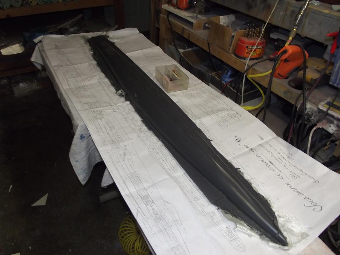

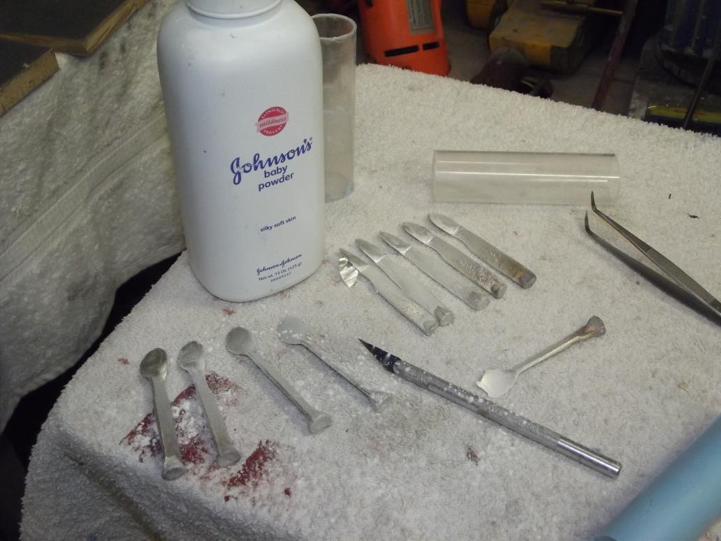

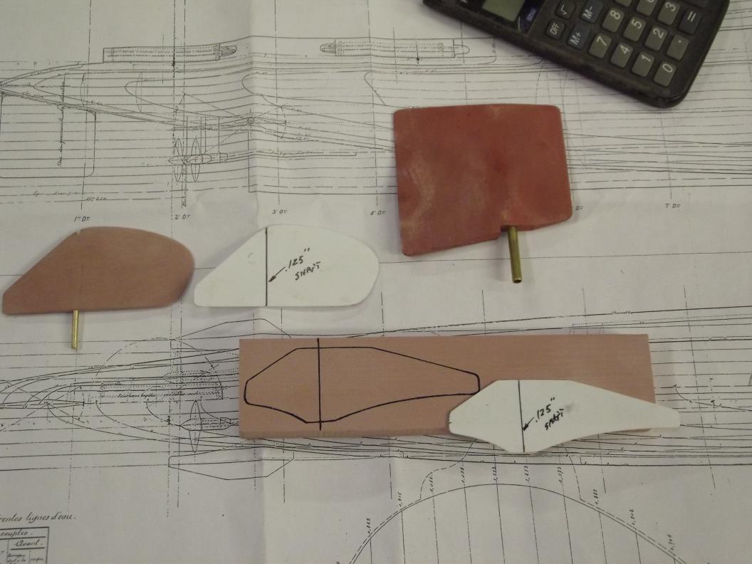

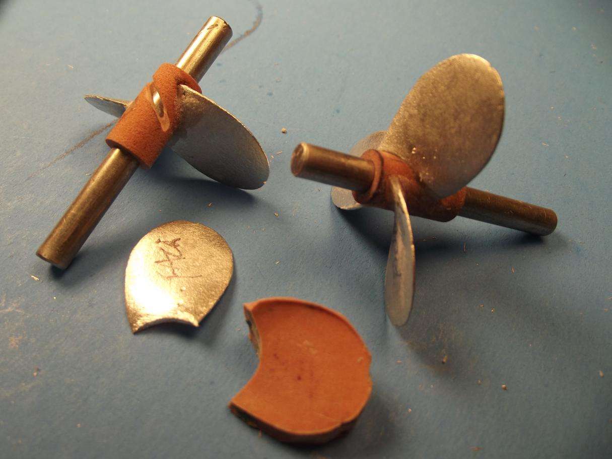

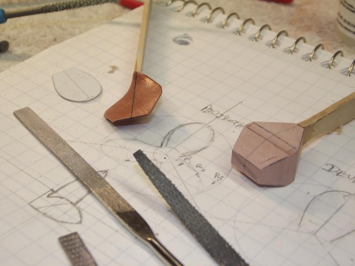

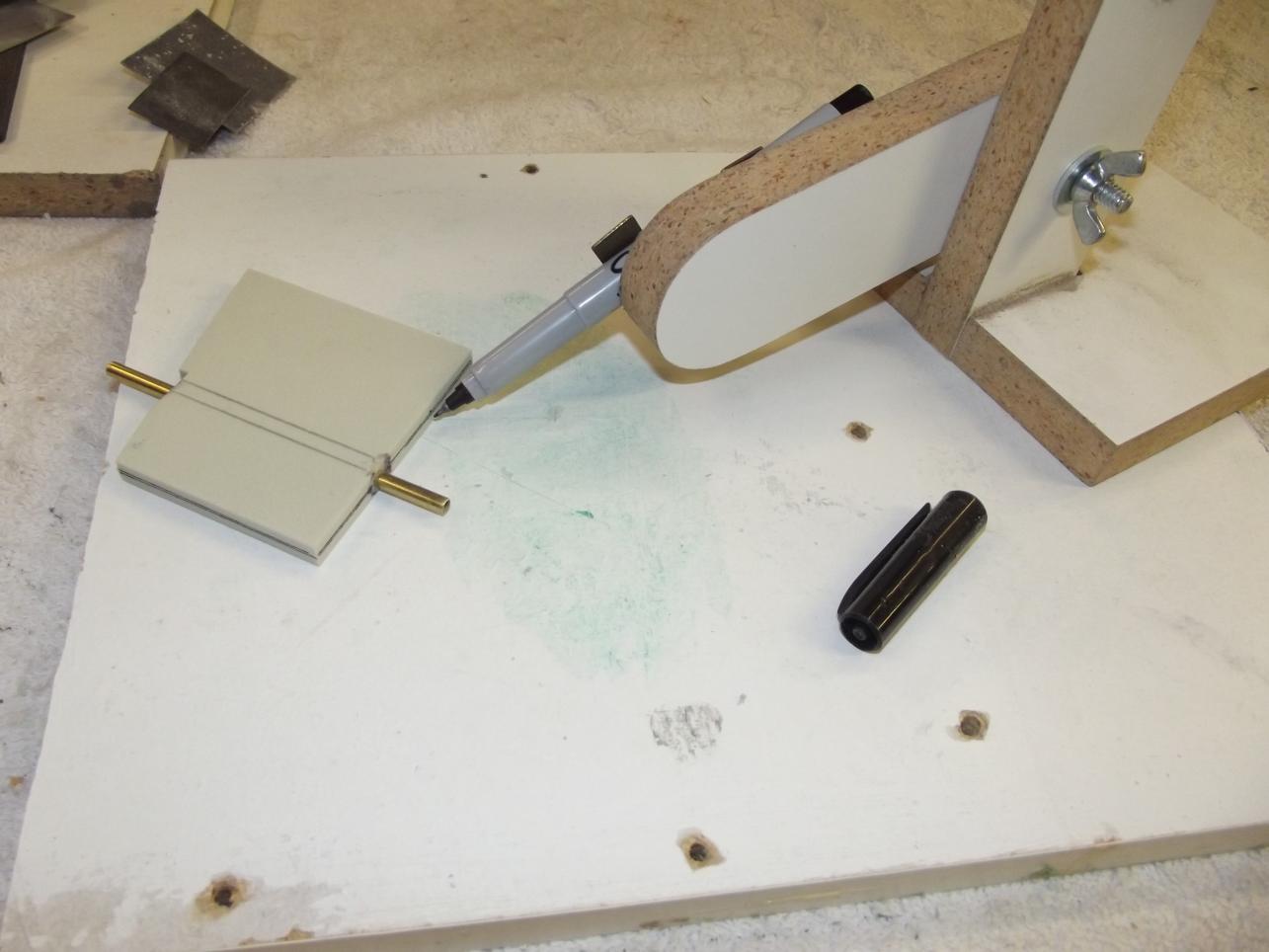

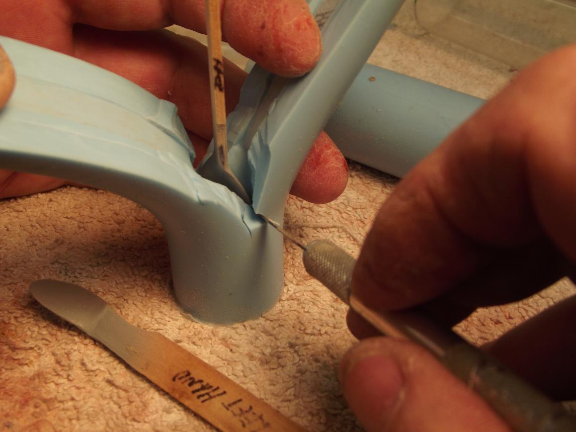

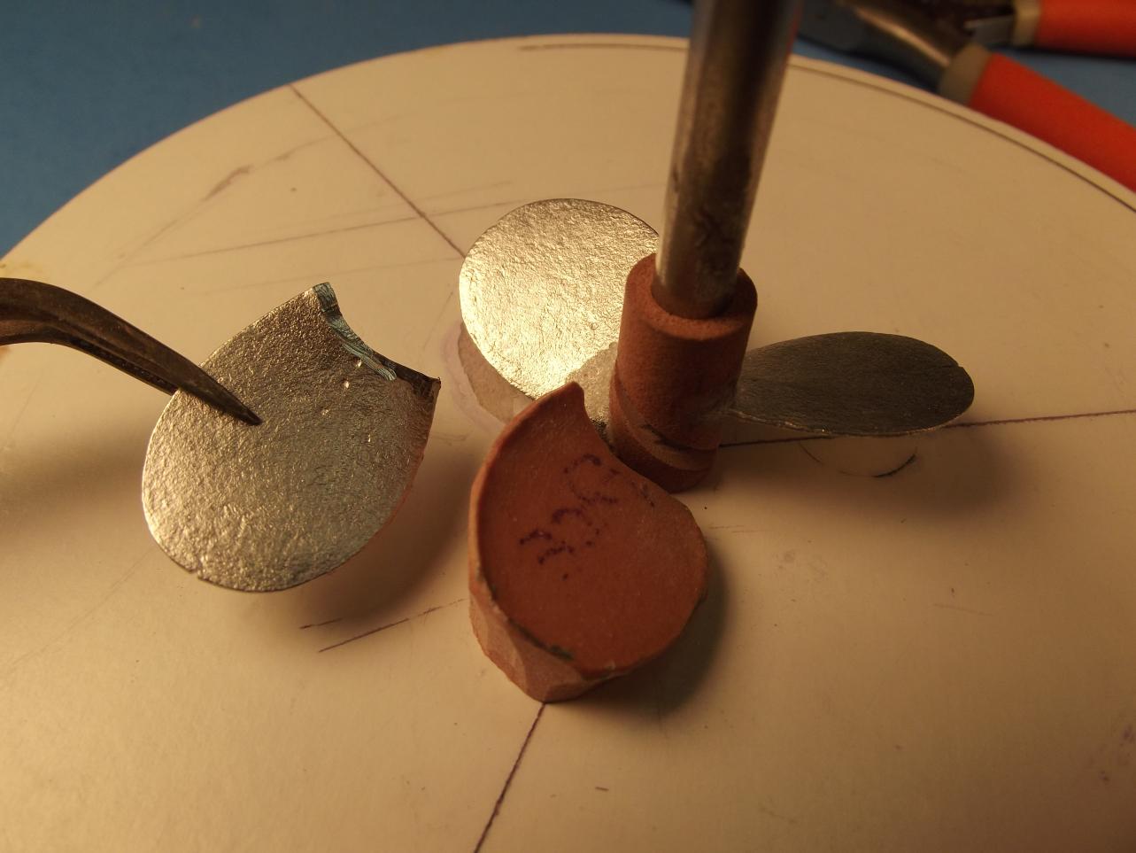

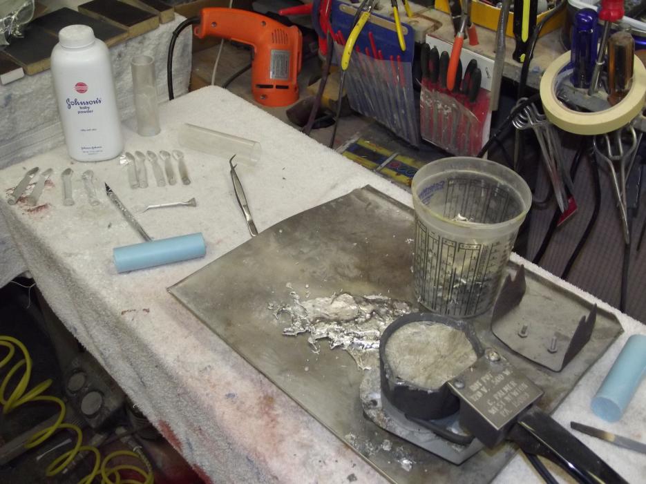

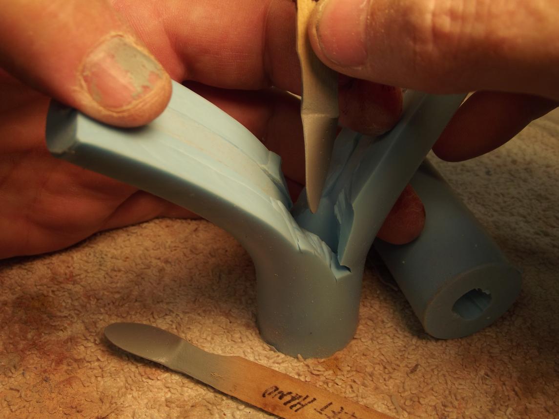

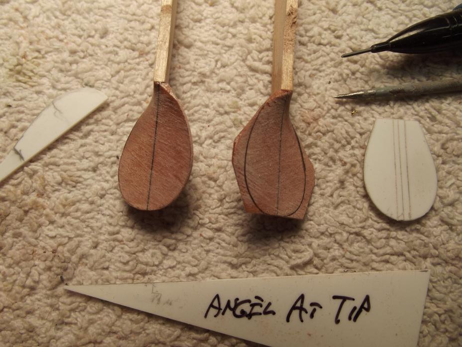

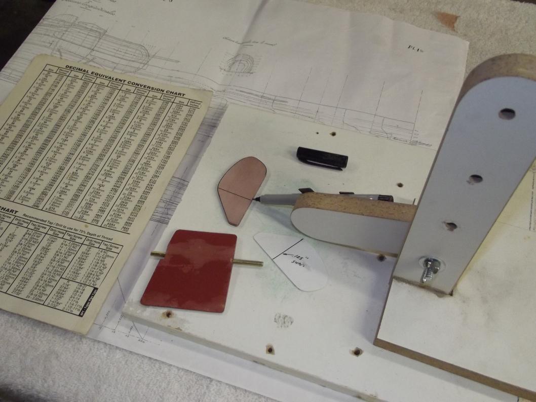

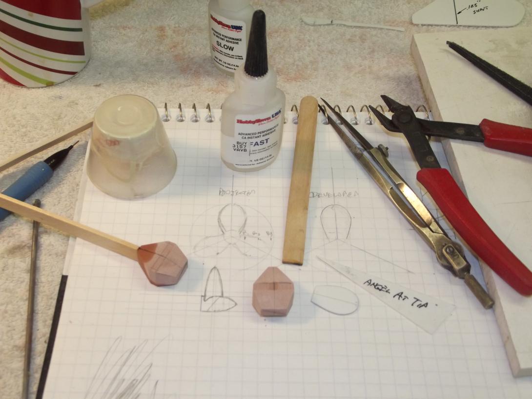

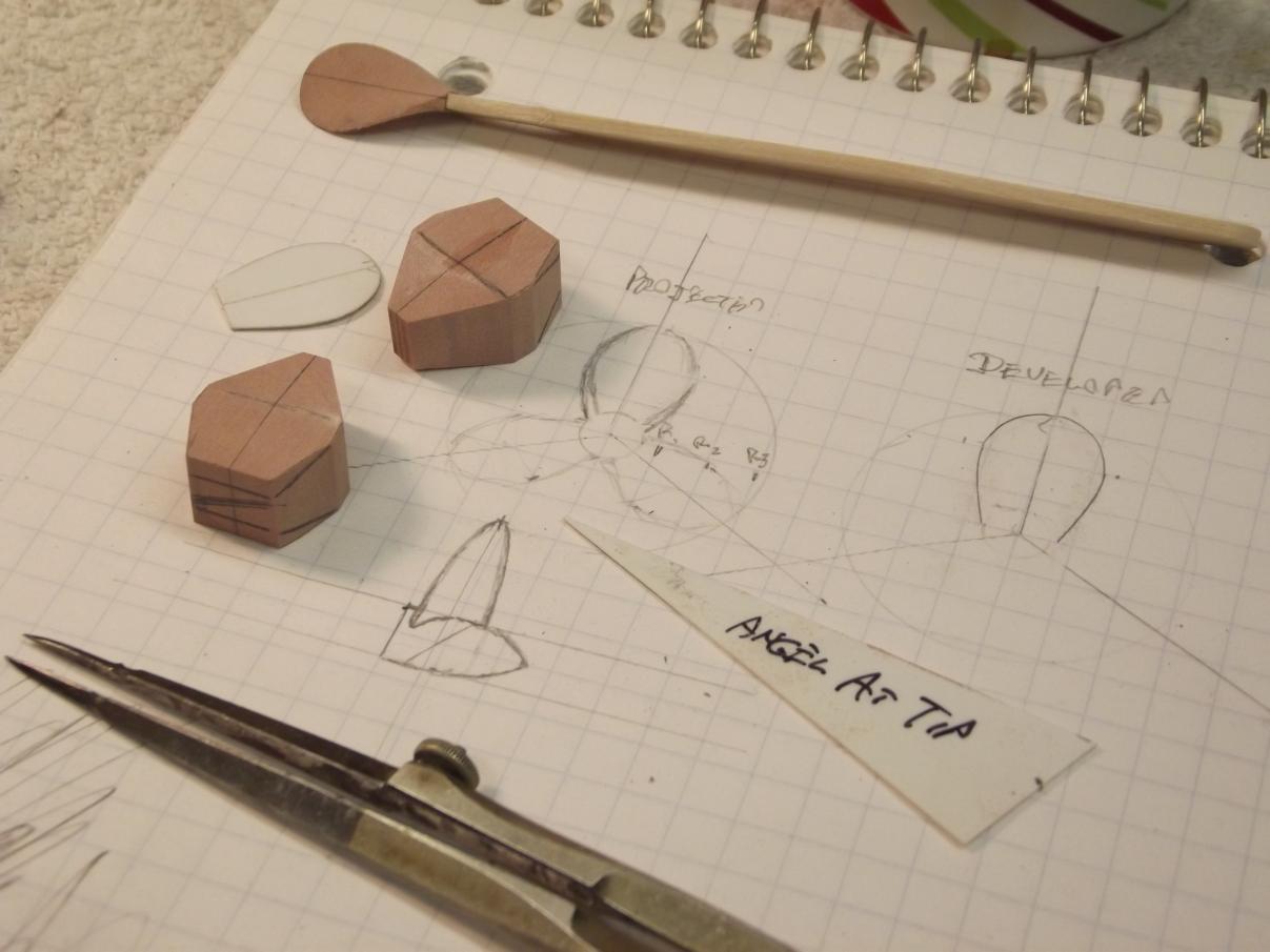

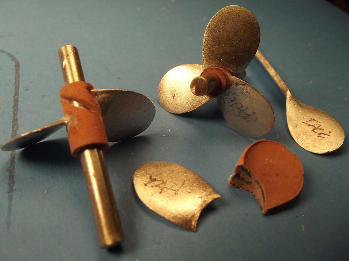

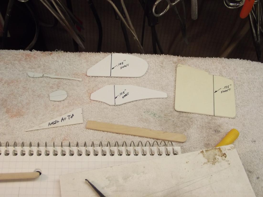

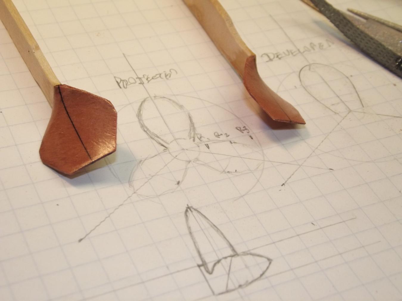

    Mike is soon to release a GRP kit of the big gun toting, SURCOUF. He's put me onto the task to produce the control surfaces and propellers for the beast. Here's the initial work:
ID:	102799Click image for larger version
ID:	102800Click image for larger version
ID:	102801Click image for larger version
ID:	102802Click image for larger version
ID:	102803Click image for larger version
ID:	102804Click image for larger version
ID:	102805Click image for larger version

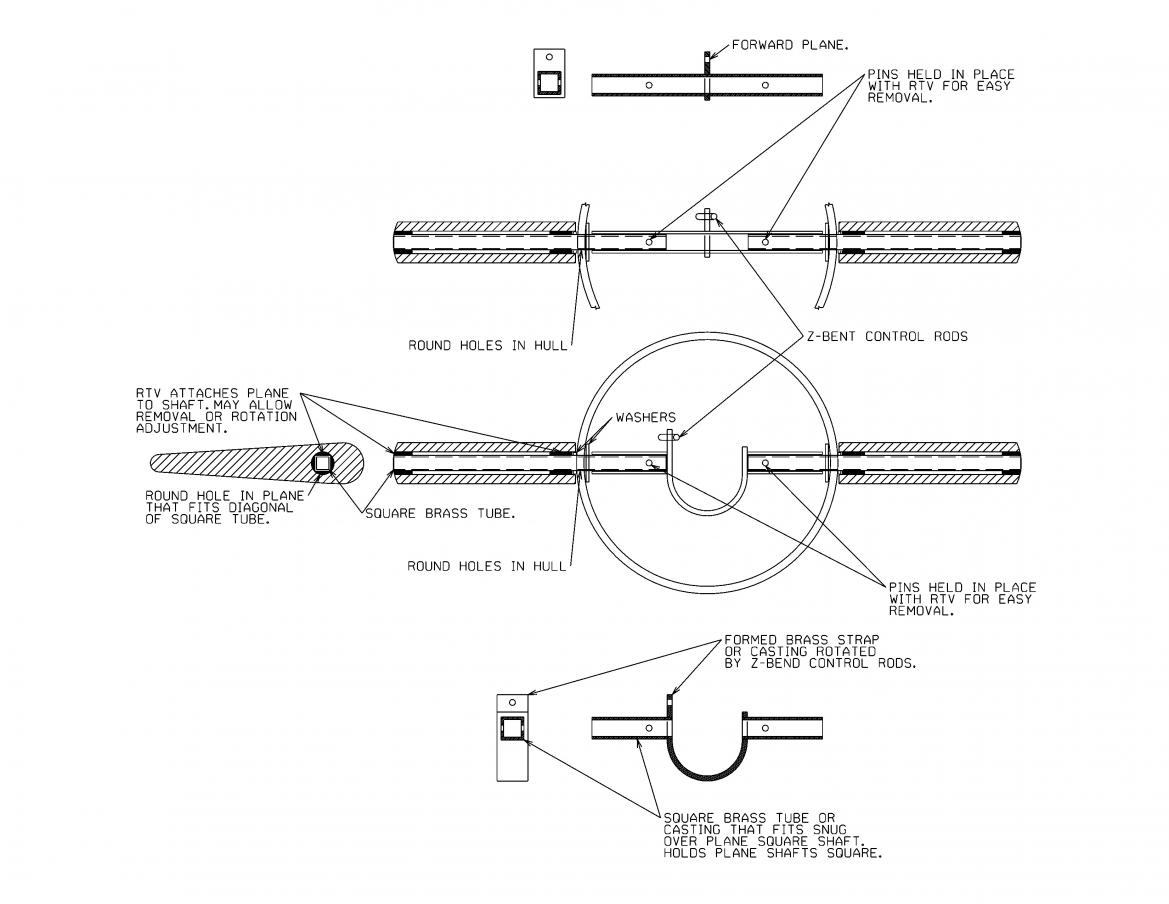

        How about putting some square shafts in those planes? Might make
        alignment easier and grub screws holding position better.
        I have an idea...film at eleven.
          • 13982
          Machine your own damned flats!
          • Scott T
            • May 2009
            • 414
            I was thinking about ease of assembly and adjustment.
            1)The thought process is to put the yoke in. Yoke holds shafts in alignment with the square tube.
            2) slide the shafts in and put a pin through with a little RTV to secure pins
            3) slide the planes over the square shafts and attach with RTV
            To remove vane pull the pin and slide out the square shaft.
            If the vane needs adjustment the rtv may allow some rotation on the shaft or the ability to twist it off and reattach.
            Vanes could be unmounted to prevent shipping damage.
Name:	PLANE ASSEMBLY.jpg
