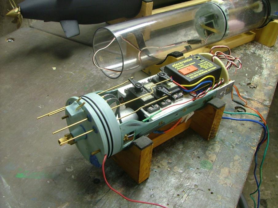

    When John posted this picture with his stand, it inspired me to make one for myself. I saw the value of caring for my WTC and got tired of it rolling on the table.

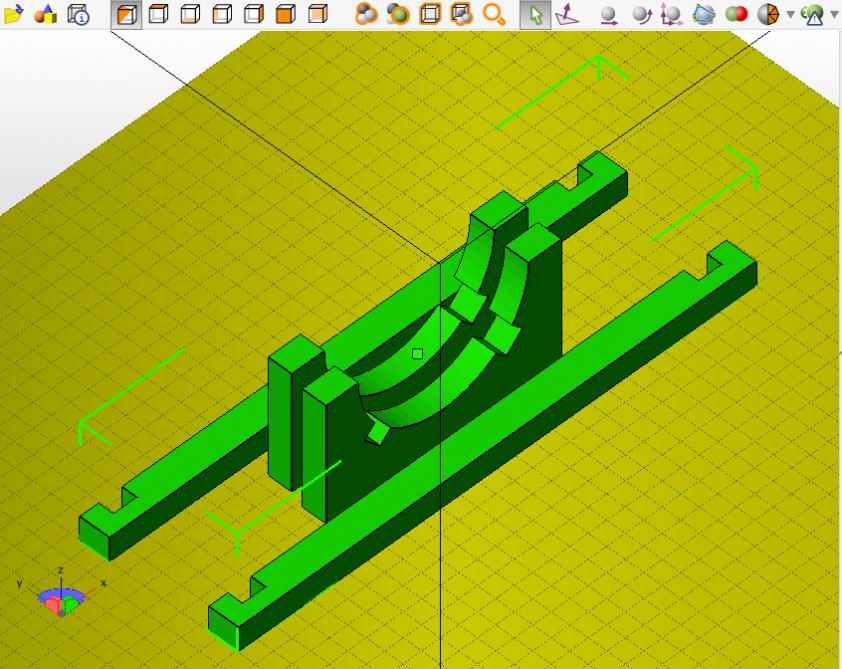

    I have been playing with a 3D printer. I drew up a quick design, it is really only two parts, a base and a support.

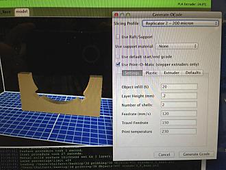

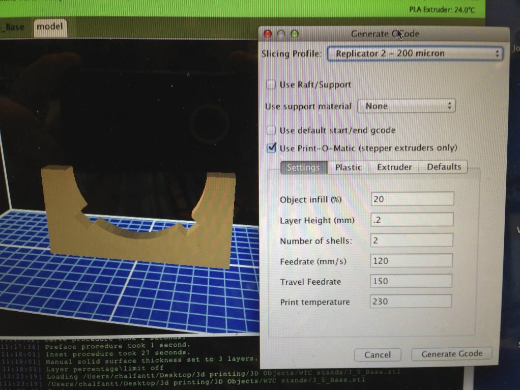

    After drawing it out it goes through a slicer that builds the instructions for the printer.

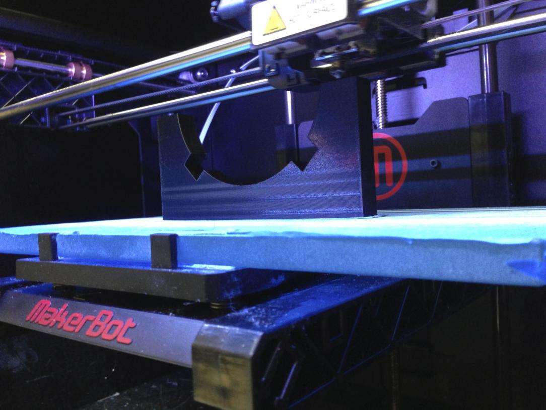

    Then the instructions are sent to the printer, and if everything is in alignment your design comes out.

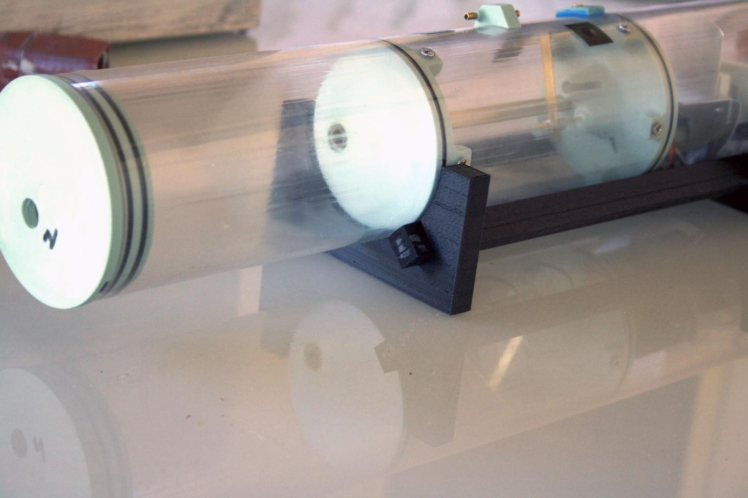

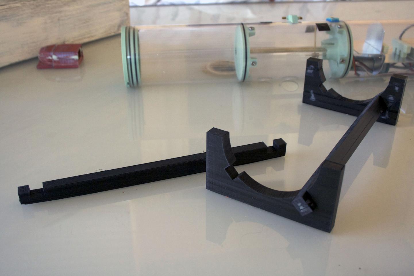

    Here it is.

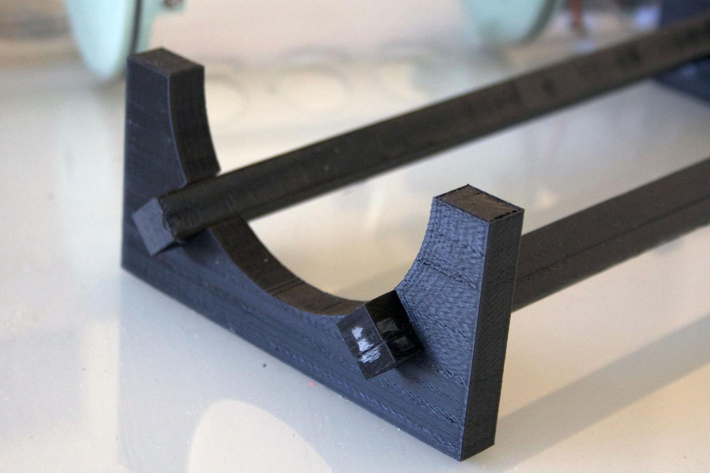

    It fit perfectly together, but as it is (printing orientation and infill or solidness will need to change) it will not last long. However, I now have a pattern I can cast or use as a pattern to cut out of wood.

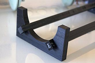

    I kind of like the tech looking black stand.

                        Something to think about with 3D printing a cradle. instead of modelling it as a solid object, think about making the inner part of each saddle with a honeycomb structure, with just a thin closing plate on each end. This will give the same rigidity as the solid piece, but will weigh a fraction of the weight, and more importantly it will take a fraction of the time and material to print. The long pieces could have multiple tubes modelled inside (think of the way plants stems are structured) to get the same strength and similar advantages to the saddles honeycomb structure.
                        If you use wood to make a cradle, to a certain extent you are getting this built in by mother nature, Frank Costin called it 'Gods first plastic'.

                          • 3769
                          Subculture, you are one smart cookie! The infill on the cradle is 20% for all the reasons you posted. Printing it with 100% infill would make it a solid block, but as you mentioned, it could be weaker and certainly wasteful since you do not gain structural strength.
