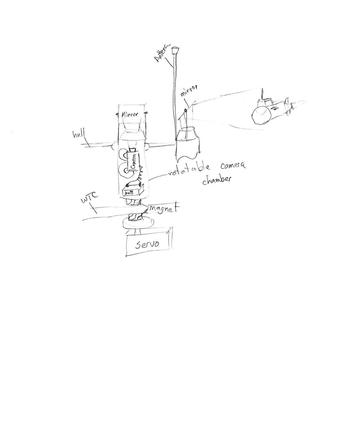

    How about a new angle on the underwater camera? Say about a 90° angle.
    Take and rotate (don't go there) the camera from horizontal too vertical.
    Then add a mirror to change the focus back to horizontal. (the mirror should
    probably be in the camera compartment) Put a magnet in the Water Tight
    Compartment on top of a servo to rotate the camera 360°. See sketch.
    Somebody edit these pictures or tell me how to make the sketch larger and
    Daves underwater camera picture smaller.
    Crash dive and prepare for depth charges!

    Neat! I like it. No time. I've got H20, Mamas and other guys ahead of you. Only reason I'm working this Type-23 is to satisfy the guys screaming for SD's and fittings kits.
    But, very novative stuff, Scott.
      • 3769
      Scott,
      i saw this drawing and knew it was from you. It really is a fun idea and one that someone could experiment with. That you for just putting it out there!
      peace,
      tom
