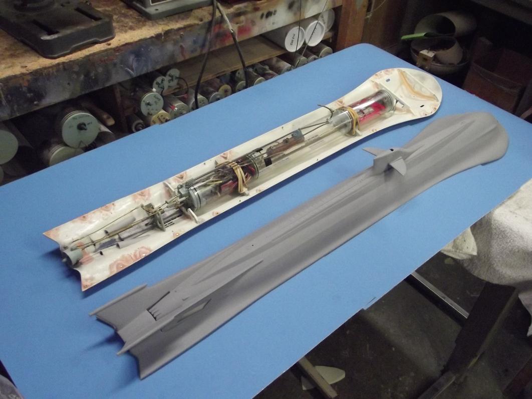

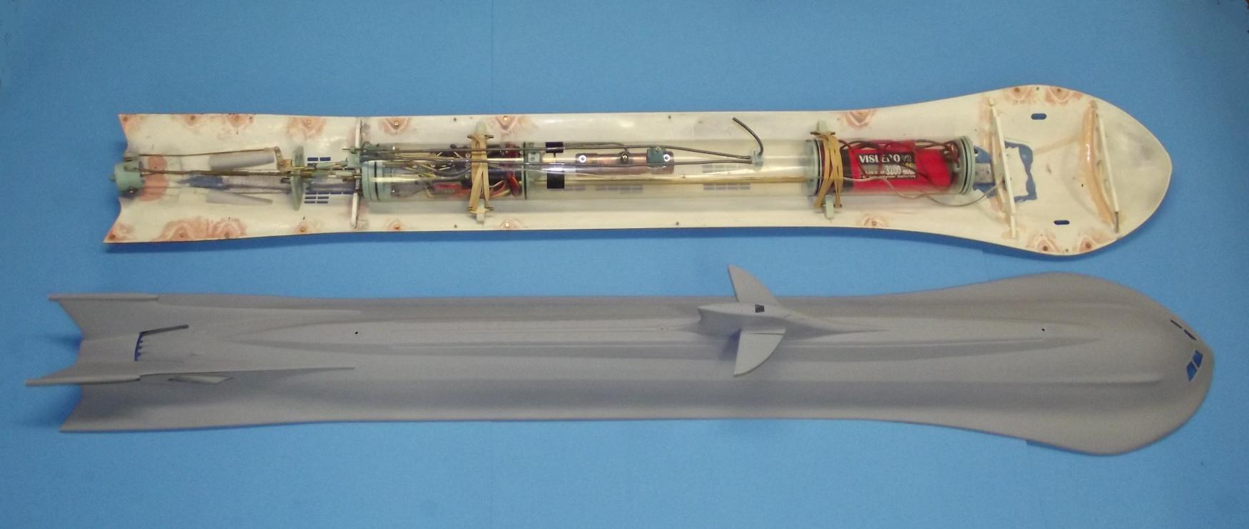

    Nothing to say but Wow! Any video fo this beauty sailing?
      • 3768
      Why concept? Has it been tested or is that the next step? Very inspiring....you do good work!
        • 13998

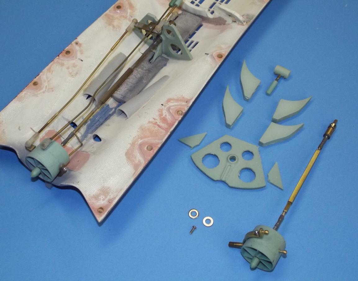

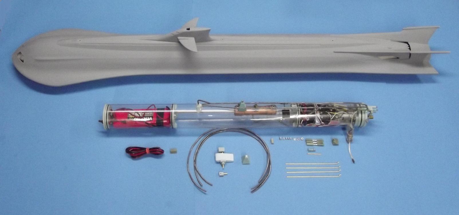

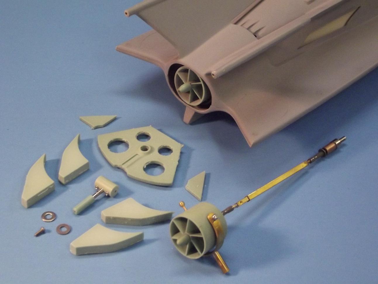

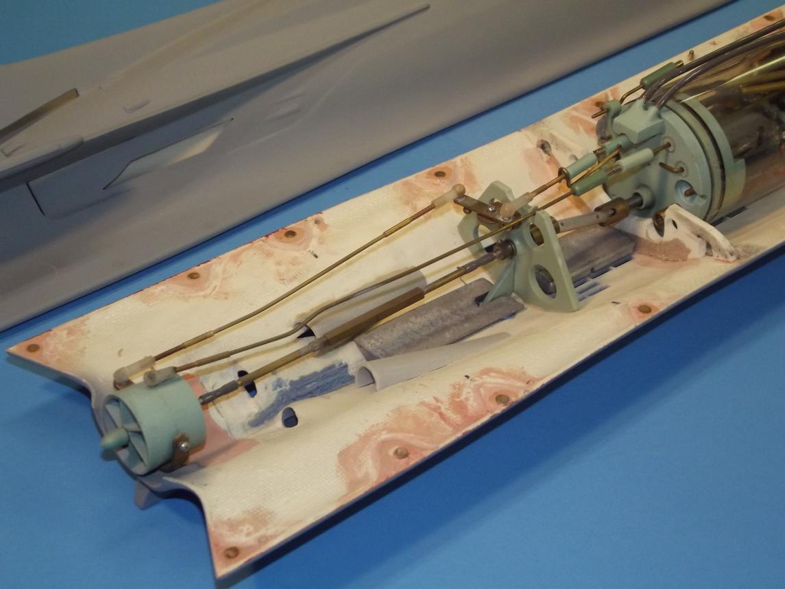

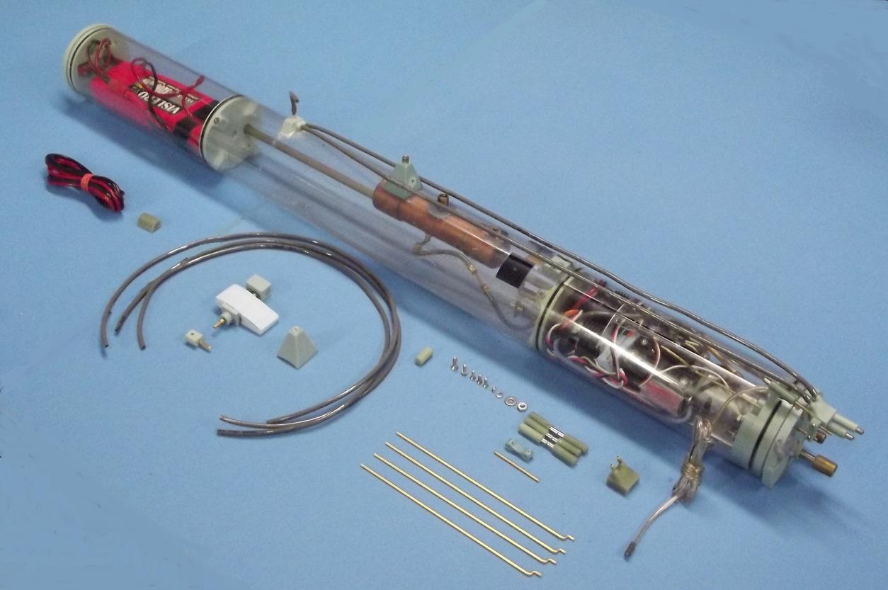

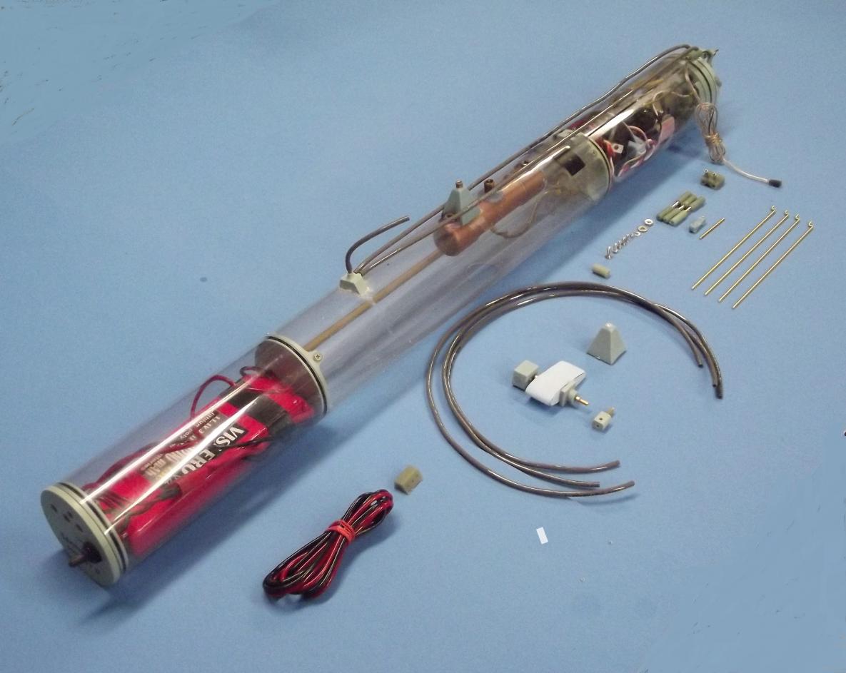

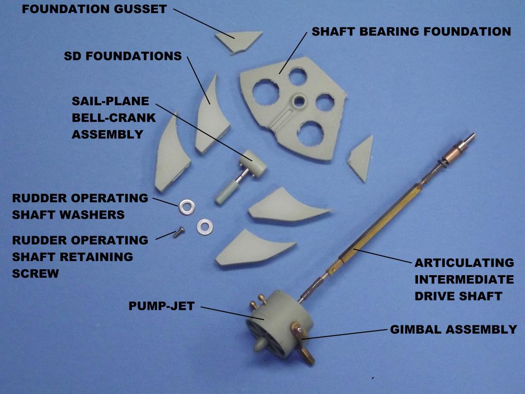

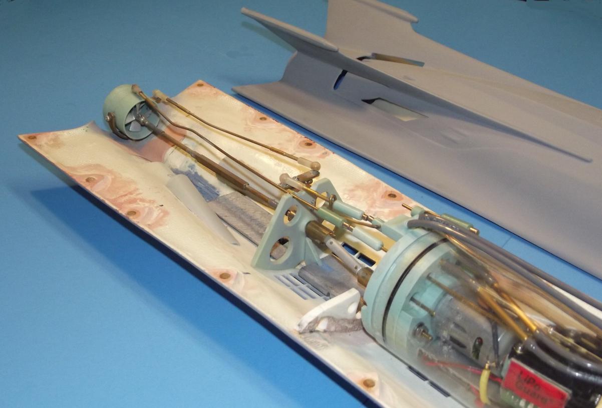

        It's a Dennis DeBoer kit -- great products, check him out. His idea of what an 'advanced' SEAVIEW would look like. I got this kit working last year and now am working up the catalog copy and pictures so we can sell a dedicated SD and fittings kit for the thing.
          I'd be interested in the fittings kit for mine, for sure. I love the looks of that thing. Dennis did a great job on that kit. I'll be interested in seeing what the performance is like compared to the original version.

            It is a very sweet design that's for sure. But I bet that bow will still make driving her a chore!!!

              Right you are, 'Neutral' setting of the pump-jet in pitch has the thing pointed up a bit to produce the required pitch-up force needed to counteract the shovel-nose pitch-down of the design. Other than that, the model is manageable in the water submerged.
