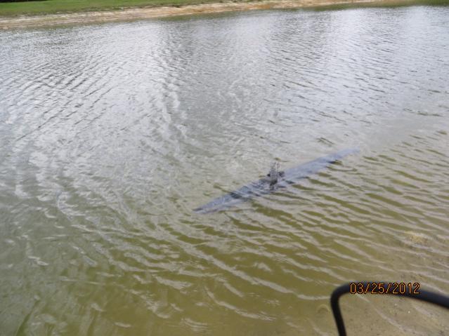

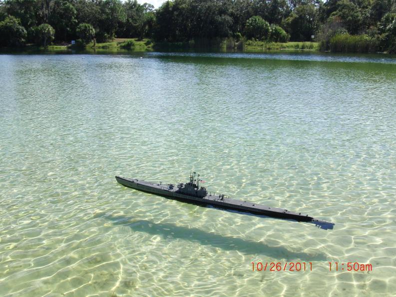

    I have personally found good success with the following basic set-up of electronics, by that I mean( No Glitching ) etc. when bench testing, and out on the water.
    IMO, and as previously mentioned, the boat runs reasonably well out on the pond, as I'm hoping continued success with the latest instalation of a stand alone BEC , which has recently been incorporated into the electronics and suggested by (Subculture)-Andy Lawrnce, Dave Meriman, and others on this site, this to further avert the posibility of electrical issues relating to the draw of power off the various electronic devises within the model itself, and rather than depending on a bec which simply may have a low Amp output. Some ESC's on the market today do not specify the output amperage of the BEC incorporated within or made to handle multiple devises operating at the same time, rudder, stern planes, dive planes, and possibly a pump or ballast servo.
    Model Description: 1:48 scale WWII Gato class Submarine
    Sub-Driver: Meriman/Caswell 3.5 Mod. 2 = (Twin Drive motor)
    Basic ( Gas ) Ballast System
    Motors: Twin- Traxxas- Titan Marine-550 air-cooled 14.4V
    ESC: Mitronics- Viper Marine-40
    Receiver: Sombra Labs 8 - 8 channel RX ( no longer available)
    Pitch Controll: Mike's Sub Work's - UPC-1 controller
    Servos: Caswell- BT100 (Standard servos)
    Battery: Venom- 5000Mah Lipo
    UBEC: RCTimer- Output 5V- 3A continuous
    Failsafe: Mitronics- Micro failsafe
    Transmitter: Polk's- Tracker- lll (8) channel transmitter- This radio is no longer available
