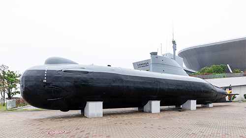

    South Korean Dolgarae class midget submarine.
    First time seeing a double set of bowplanes Looks like they swing out like those on the Type 209.

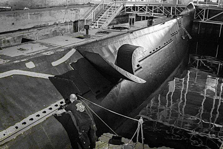

    Yes, same device on Narval and Arethuse class french SSK.

      Most interesting, I haven't seen anything like this before. On the french boat the forward most plane seems reasonable for surfacing but the rearward plane looks like it is very steep, almost like running into a wall ??

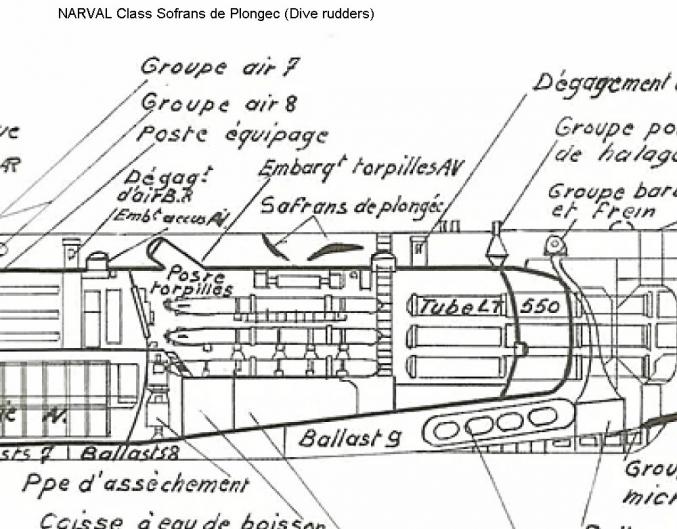

        The Dolgarae class midget submarine follows the German Type 209 approach to the same design problem of completely retracting the bow planes when not needed and extending only when needed. These are on a pivoting vertical axis, and the degree of up or down force is determined by the amount of rudder surface exposed into the flow of water over the hull.
        The French system is same in purpose, but the French slide their planes slide out horizontally on tracks.
        The Narwals are the French Navy's largest earlier postwar conventional powered subs. Where the British and Americans who had an abundance of submarines used large fleet submarines for their missions, the French had to resurrect their Submarine designs and followed their prewar practice of short, medium and long-range submarines. The Narvals where the French interpretation of the German Type XXI and where long-range subs for patrolling off their (then) far off colonies then (Indo China).

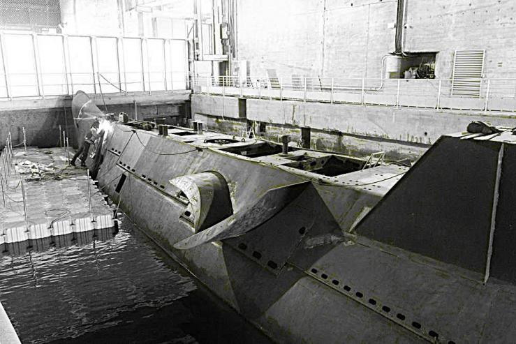

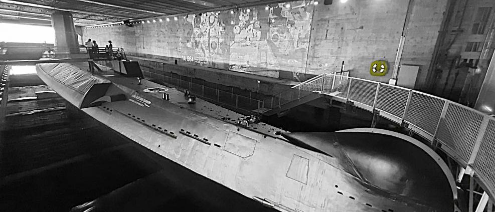

        Here are photos of Espadon being restored and upkeep in St Nazzare in one of their famous U-boat pens where she is a museum. These configurations seem odd but the seem to work. These were used on the small hunter killer Arethuse subs too, but the mid-range subs Daphné class used always extended bow planes much like the German Type VII and IX boats.

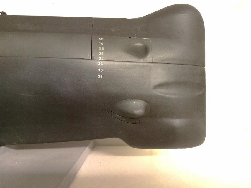

        My 1/32 Argonaute completed by Bob Martin and his team. The 'up plane' is on port side top. Because of the long moment arm from the boats center of buoyancy the small planes far forward work quite effectively.

        Espadon restoration work shows planes both sets extended (Port and starboard).
        . Click image for larger version  Name:	dive rudders.jpg Views:	0 Size:	70.7 KB ID:	196023
        Click image for larger version  Name:	restauration-sous-marin_-espadon-02-02-2021-snat-jerome-bosger-8.jpg Views:	0 Size:	69.5 KB ID:	196024
        Click image for larger version  Name:	restauration-sous-marin_-espadon-02-02-2021-snat-jerome-bosger-73.jpg Views:	0 Size:	69.1 KB ID:	196025
        Click image for larger version  Name:	peinture-coque-restauration-sous-marin-01-06-2021-jb-3.jpg Views:	0 Size:	75.5 KB ID:	196026

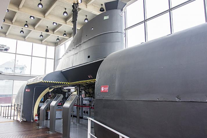

            There are a few more photos online of the Dolgarae class submarine SSM-053 at Seoul Battleship park which shows some more of the design features;
            Flickr photos, groups, and tags related to the "seoulbattleshippark" Flickr tag.
            Also some photos of one on display in Busan
            https://www.shipspotting.com/photos/3568267

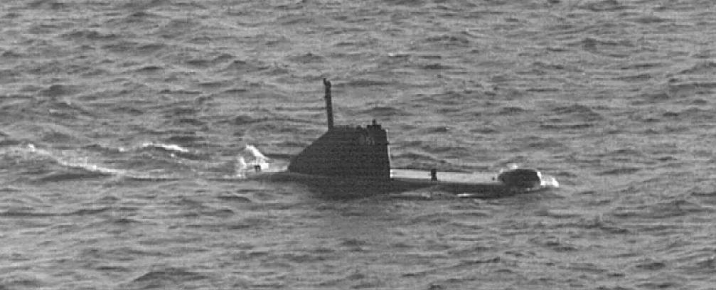

            and finally a few photos of one underway in the 1980's
            https://www.reddit.com/r/submarines/...eclass_midget/
            Clearly the design took some inspiration from the German postwar SSK's including a rudder/rear plane arrangement similar to the Type 206 and a sail similar to the Type 240 (Modification of the salvaged Type XXIII Hai and Hecht submarines used by the Bundesmarine in the 1960's)

                The asymmetric controls surface in bow on Arethuse and the German subs in the long article but in a sentence here essentially the speeds in which those subs operate the forces of rolling moments are nonexistent or inconsequential. My model demonstrates that too. On nuclear powered fast subs asymmetric bow planes then may be a issue then. Reasons again why we all find subs so fascinating.
                The V-80 Helm photo is timely as I submitted a article on HMS Meteorite to the Sub Committee Report, I will forward and add to the articles photo on the historically important helm controls.
                Excellent research. Thank you gathering all the photos. I saved & cropped, filed away.

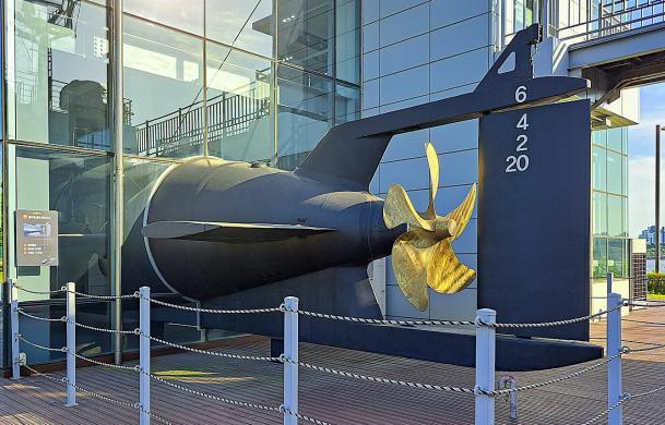

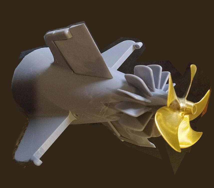

                  whats amazing is the south Korean subs props looks exactly like mine Keith Bender just made for me - the Rubis sub model project. If the shoe fits, I guess. Click image for larger version  Name:	runbis prop stern.jpg Views:	0 Size:	39.4 KB ID:	196058
                  Click image for larger version  Name:	Dolgorae 2.jpg Views:	0 Size:	54.8 KB ID:	196059
