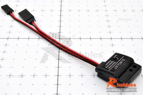

    I read somewhere that some folks were contemplating using this device as a pitch controller. At About $15 it seemed like a plan for a utility operation, so I bought one, just to try it.
    Doesn't work worth a darn folks.I plugged it into a Sombra Labs SL8 mounted in one of my Sub-drivers, and added a servo. Nothing but a load of chatter.
    Is it really meant for subs?

      Did a Google search and found this; http://www.r2hobbies.com/eng/proddet...od=rcps2812001
      It's designed for drifting not pitch control.

        That must work like a heli gyro, referencing to the last commanded position. You could try fitting it to the rudder on a sub, if you have one that is a bit skittish, might be interesting to see how that works, but for it to work as a leveller it will need some tinkering.
          No it wasn't. Something about cars if I recall, but someone had suggested it might work.

                Yeah, the things a damper, not a position sensing and holding device.
                Old-world equivalent would be a rate-gyro; an electronic shock-absorber, if you will. It can not sense the gravity line, so it can not steer you perpendicular to it. Angle-keeper, it ain't. Not good for stern planes, not good for ship type stabilizers, not good for stabilized gun barrels on the move.
                This gadget senses changes in direction and velocity about one or more axis and produces a damping signal to the servo to steer the vehicle in or out of the direction you wish to damp. For a car this thing will mix the sensed lateral drift (skid) with the steering (yaw) servo to avoid or lessen the skid.
                It's a rate gyro. Useless to us.
