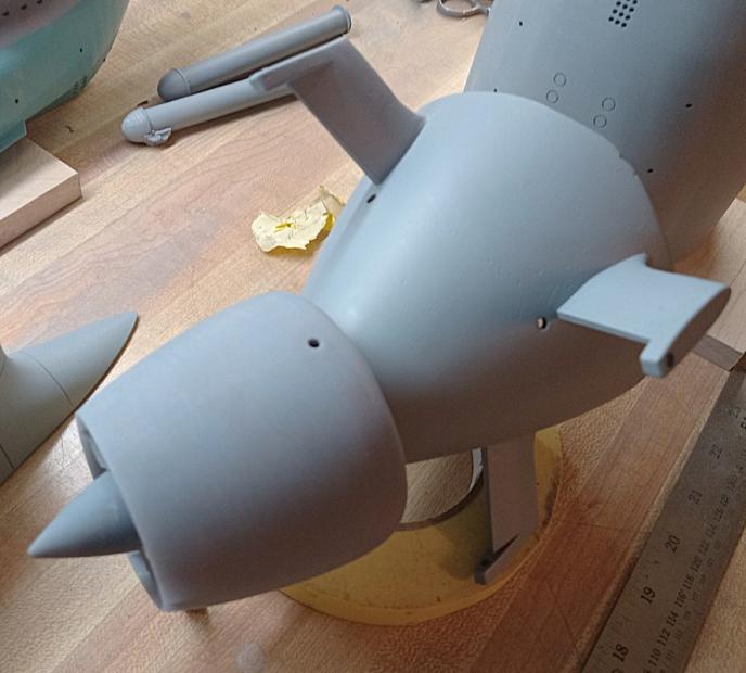

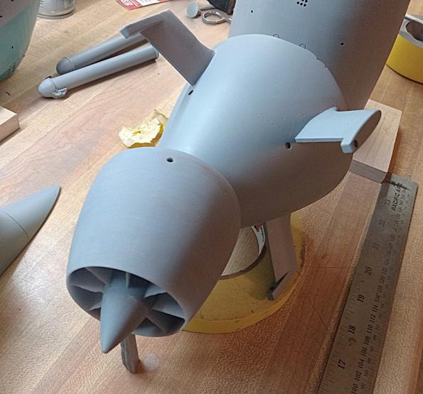

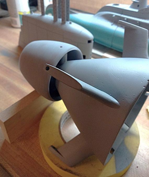

    My Suffern Model project developing building now in another thread here is using a swiveling pump jet I devised. The propulsor and shroud swivels like a rudder left right only. It will act like a rudder and thrust vectoring too. Posting here are early successful trial tests of my swiveling pump jet designed by me and Randy Sanders. I call it the Sanders swiveling PJ. Just a rudder servo turns everything, including the propulsor. The shaft for propulsor is connected via a telescoping drive shaft barrowed form RC car part. Bench tests while drive shaft turning very successful. Very smooth.
    Placing the battery way forward and balancing the center of buoyancy the rudders on Virginia if small would have a long moment arm may work too. My D&E Skipjack had the battery in the dry compartment farthest forward and Merriman's arrangement made the boat incredibly maneuverable as the 1 to 1 scale boat must have been. the contribution of CG/CB and moment arms. For what it's worth.
