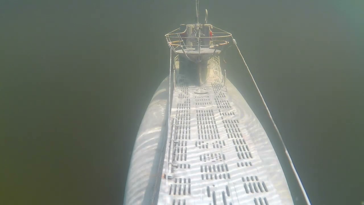

    I eventually filmed a little bit with a go pro type camera and that is where I ran into the clearly self imposed problem number 3)

    Excellent footage. Loved the oop's drop at the end. And a fine sense of humor on display in the editing room.

        Thank you David for the kind remarks. I did have to swim for the camera but at least I was able to find it.
