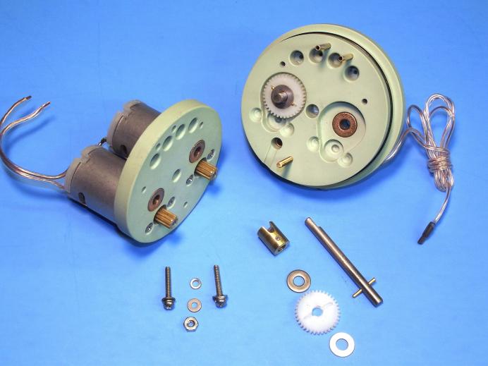

    A 555 geared 3:1.

      what size drill bit did you use for the steel shaft/plastic gear assembly? It’s gotta be one tough drill bit as small as it is.

        1/16". Low speed, use oil.

          The 555’s come in a very wide range of winds, some low revving some really high, so be mindful which one you select. I suspect Dave is thinking about something like this one https://www.componentshop.co.uk/mabu...-dc-motor.html
          At 3:1 reduction that would give an unloaded RPM of around 1700RPM at 12 volts, which sounds about right for your boat and prop combination.
          A brushless equivalent would be a 28-35mm outrunner of around 350-400kv, with a similar reduction of 3:1.
