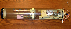

              I would like to see some better pictures of it, if possible?
              Is it like this, except with 2 motors and shafts installed:

                  The 3.5/2 does have 2 motors doesn't it? Or is it just 1 motor geared to 2 prop shafts?
                  Rick L.
                  • Nuke Power
                    Banned
                    • 277
                    The mod 2 comes with two 12volt motors with independant 3:1 gear reductions.
