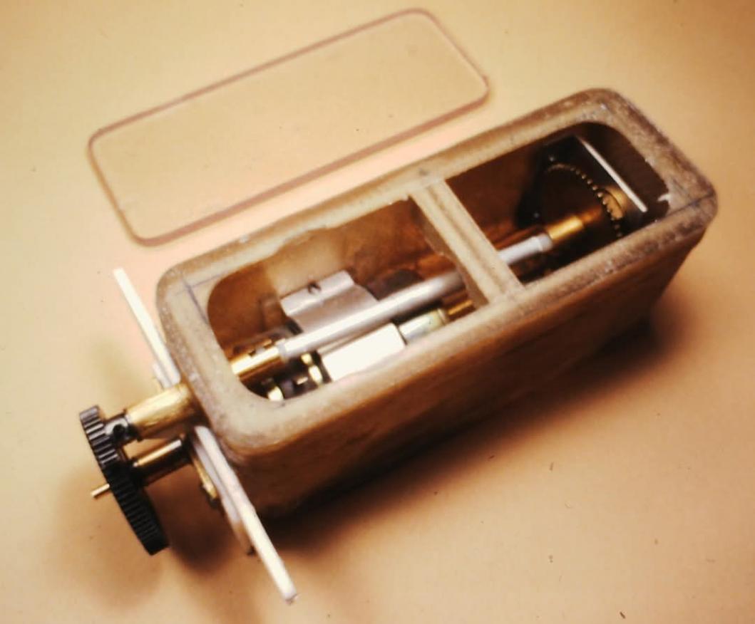

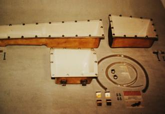

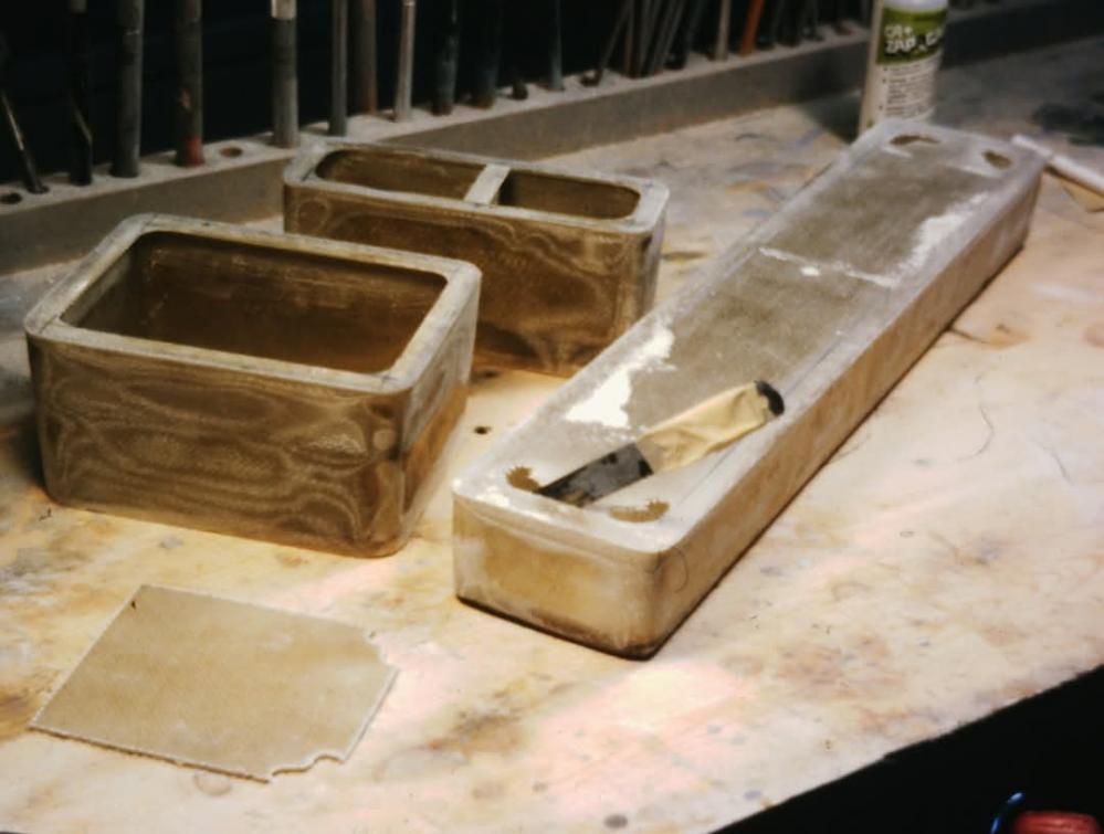

ID:	187000 GRP watertight boxes.

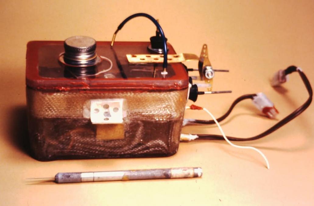

ID:	186998 Clear lids were attached with RTV sealant.

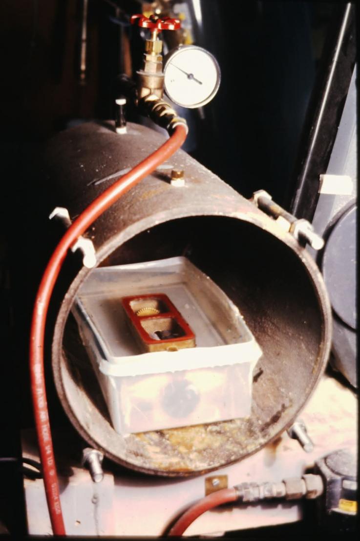

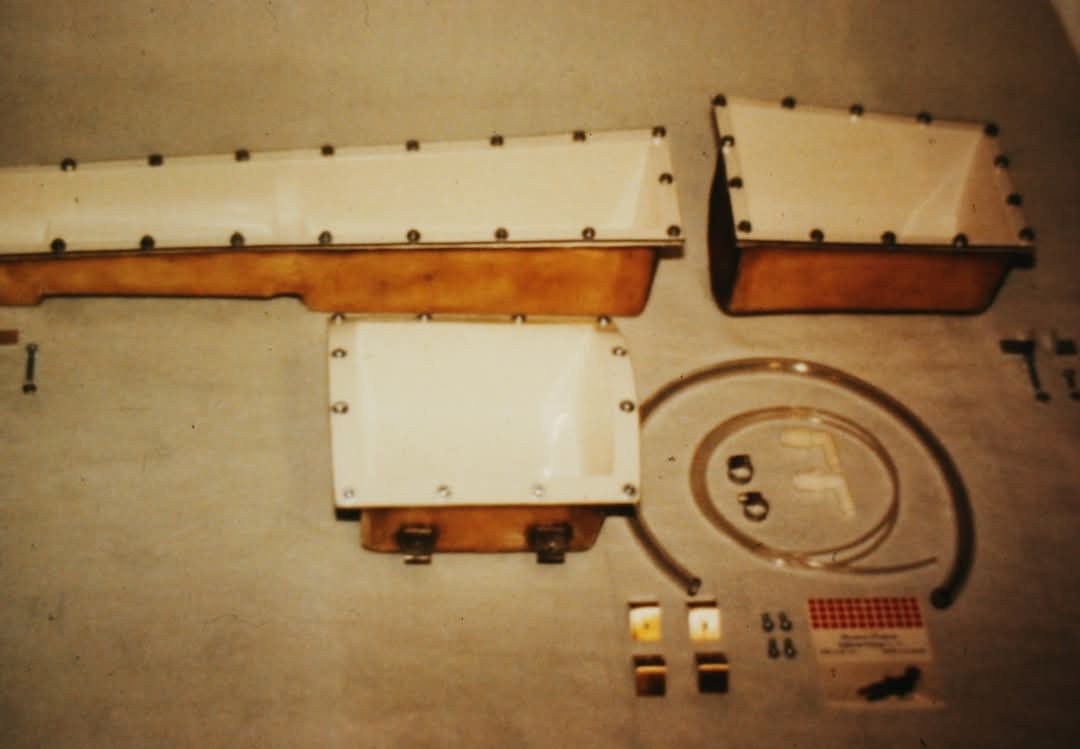

    rated to 2 atmospheres (33 feet)

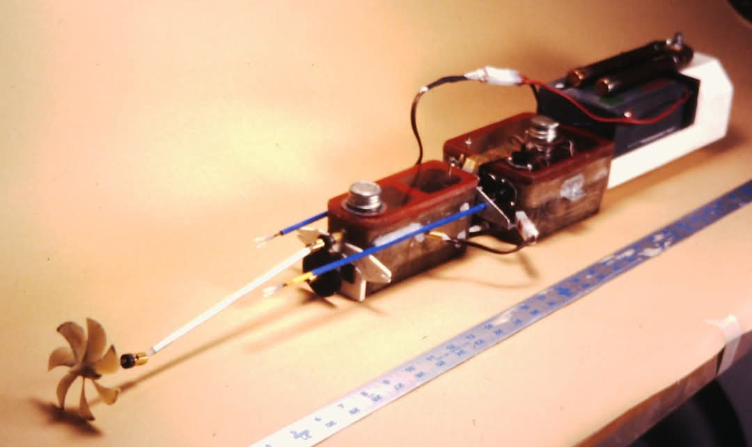

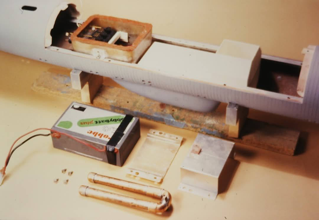

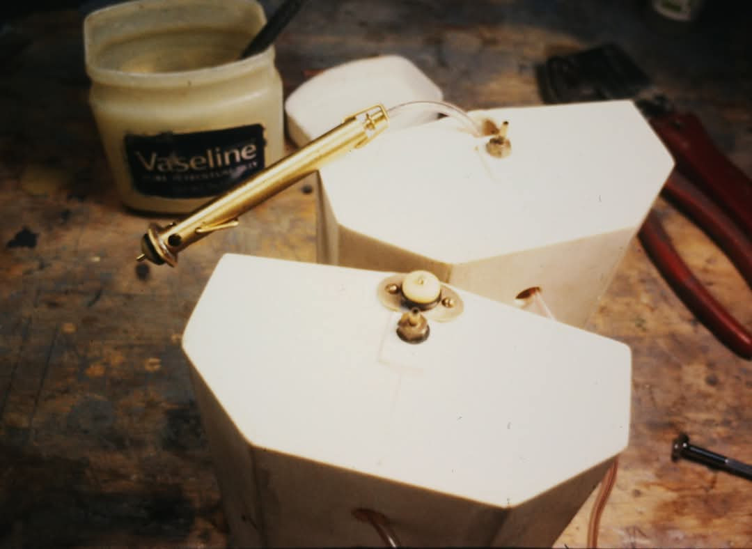

ID:	186996 electronics box was installed with lid on bottom. White box is the ballast tank

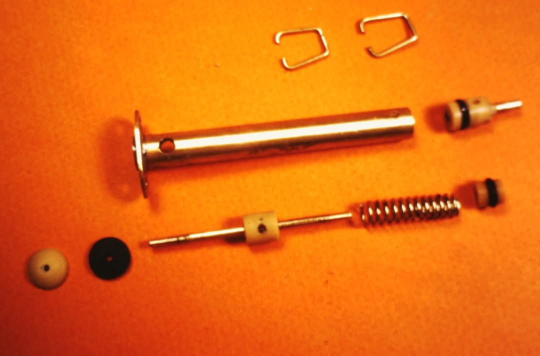

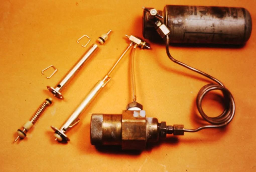

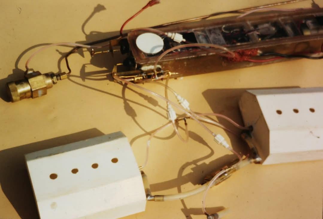

ID:	186987pneumatically activated vent valve

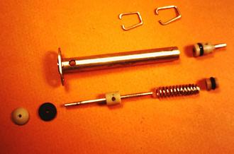

ID:	186991 Valve components

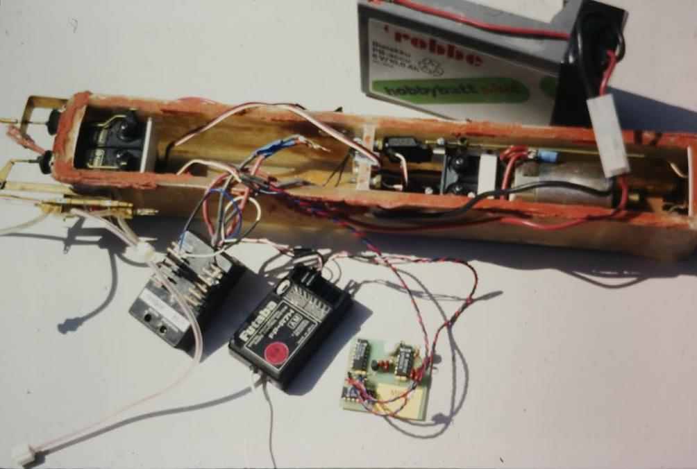

    Other iterations of the WTB.
    • 13977
    Yup. Our first r/c submarine. We learned a lot from that bad boy.

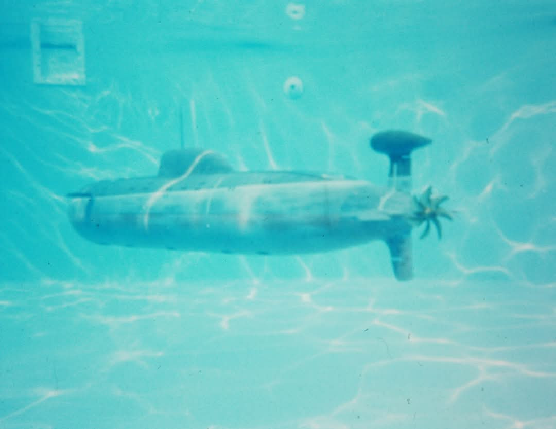

      Why did you go with a pneumatically activated vent rather than a mechanical (servo)?
        • 13977
        I didn't know any better at the time. Don't permit complexity to be the enemy of a successful outcome.
          What did you use to seal your driveshaft and control rods?
          • SubSteve
            • Apr 2022
            • 143
            Definite Blast from the Past! I remember wrestling with some tech from this era on an early Engel Patrick Henry. I recall the no-hardware box lid and thought it was a great way to reduce the number of potential leaks, but was still accessible, albeit with an Exacto knife. I installed the top half of an aluminum 35mm film container on the lid to provide access to a power switch and charging jack. Your receiver and speed control are also familiar, amazing how much smaller and cheaper those components are now! Thanks for the post.
