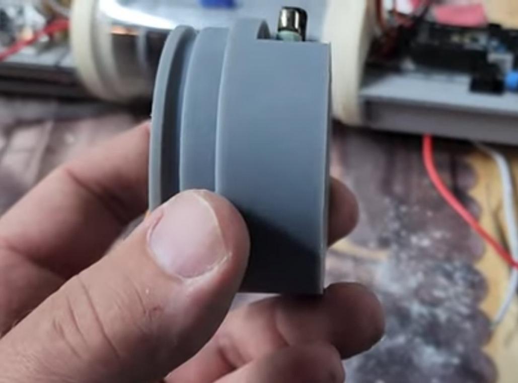

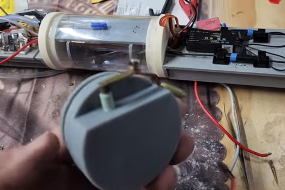

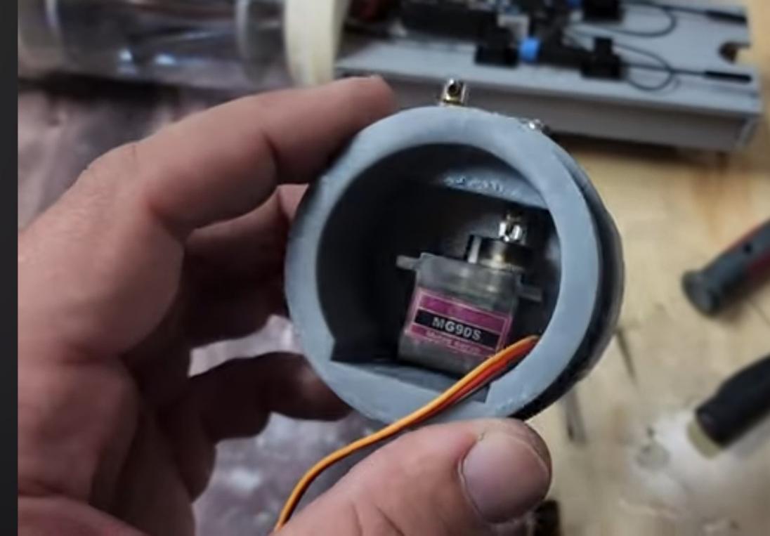

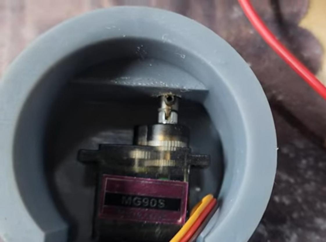

    Was watching one of Bob's video the other day. He shows an endcap for an Arkmodel Type VII with rotary servo output instead of a linear one.

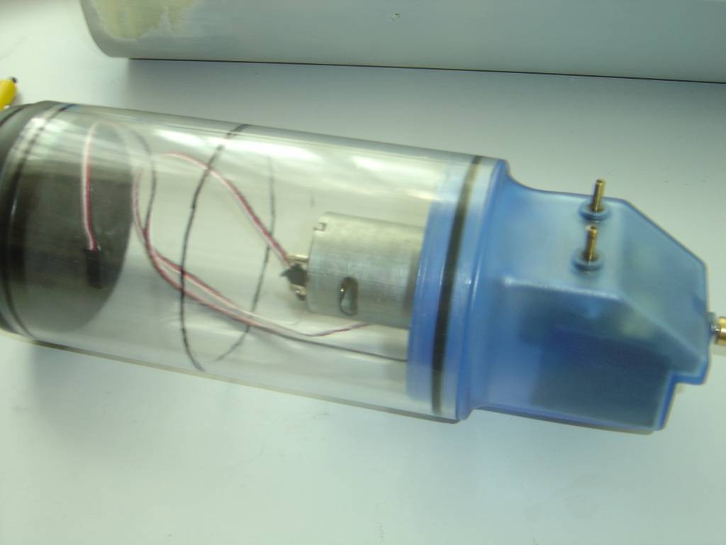

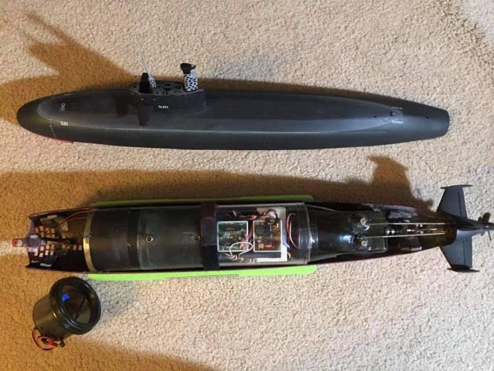

ID:	180148 Reminiscent of the Small World Model WTCs which utilized a similar rotary seals for their servo output. Click image for larger version
