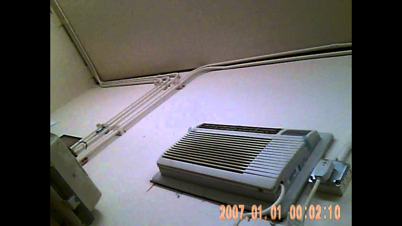

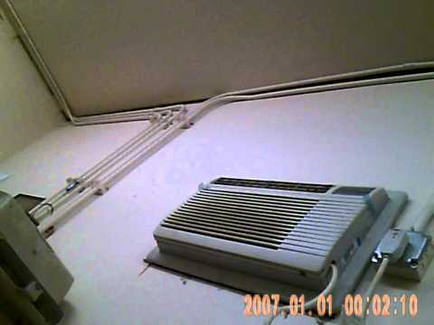

                        Here is the test video. Works well. Now, next weekend Ill have it mounted on my Oscar and well shoot some diving video. Oh, in case you are wondering this is inside my office at work which is my new workshop for my hobbies. You have to learn to adapt to new circumstances whether you like them or not.

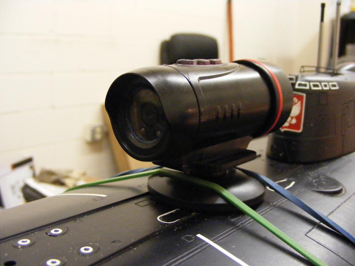

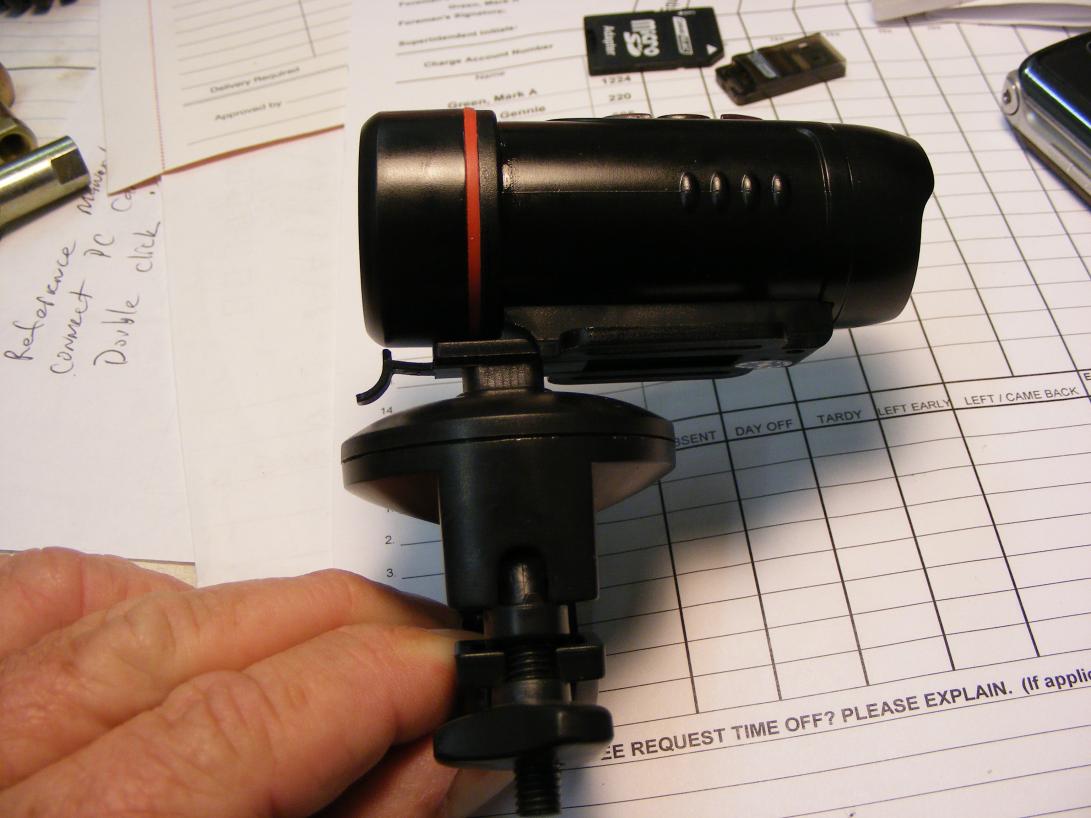

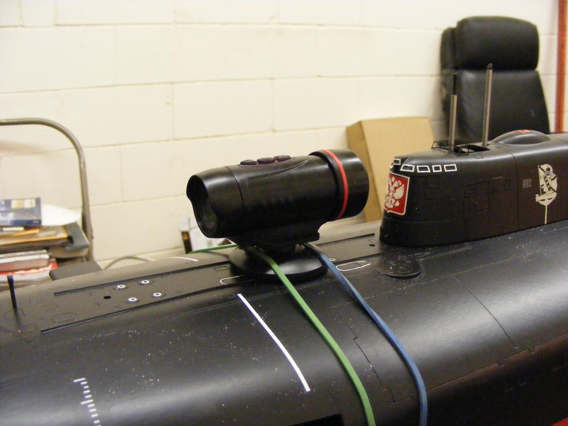

                          Thanks Subculture for the info. I think I will try the second link there as I am not using Vista. Back to the camera, I took the camera mount and kit bashed it. I then cut it apart and using only the upper part of it I cut grooves in it on the bottom to correspond to the safety rails on the front deck of the Oscar. Then I sawed grooves on top of the mount to index a pair of large dia. rubber bands. I'm now ready for next weekend!
ID:	64997The camera and lower mount before I cut it down. I have just barely engaged it here. It slides further to the right and snaps into position.
