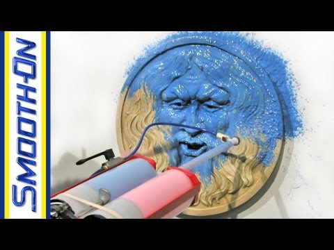

Totally amazing. Can this be done at home on a much cheaper level without spray booths and all the protective gear?
JasonComment
Last edited by redboat219; 08-13-2023, 11:47 AM.Make it simple, make strong, make it work!Comment
No. However you can carry out slush casting, which will give a near enough result. Basically mix up a two part PU resin pour it into the mould and slosh it about until you have an even coating over the tooling, keep the resin moving until it solidifies.
Bear in mind that the end result will never be as strong as an epoxy glass composite.Comment
