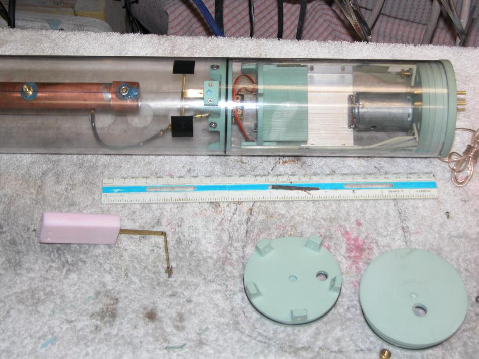

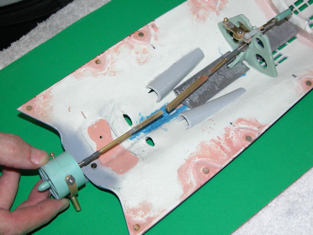

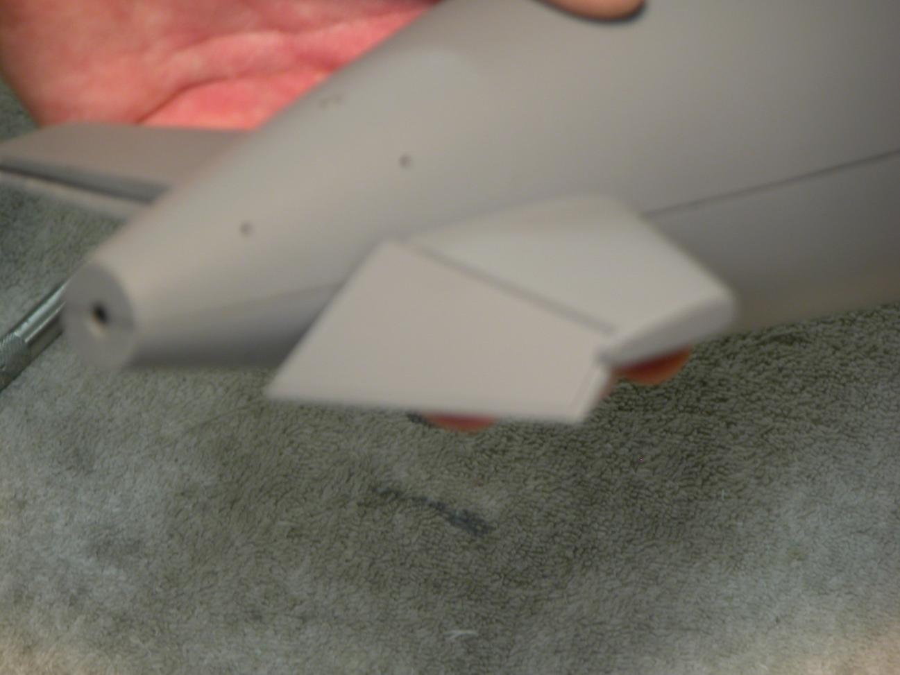

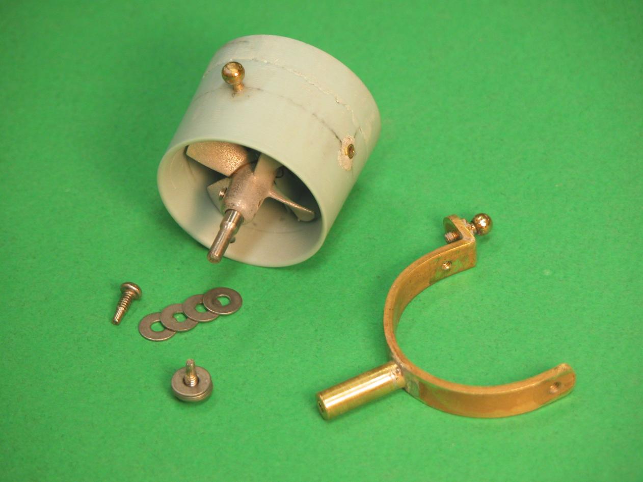

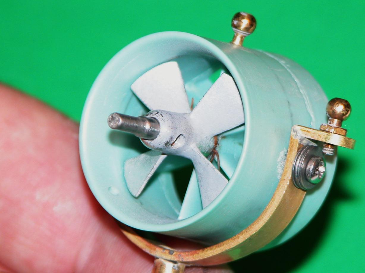

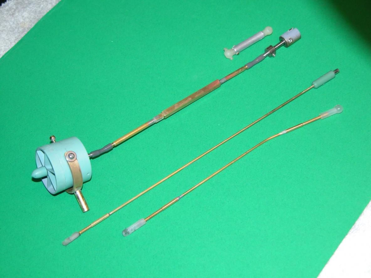

    The 'flexible' tube between PJ and moving nozzle presents too much drag on the linkages. And I've already came up with a fix: I dumped the nozzle, and put the pump-jet to the gimbal -- much improving turning radius and pitch response.
    The attached photos illustrate how my SEAVIEW propulsion-steering-pitching mechanism now works.

          Dennis' Concept-2 SEAVIEW, the one I've built up and recently got operating in pretty good form, is still in primer gray. But, I've finalized the design of the running gear and means by which the thing is pitched and yawed. I'm reasonably happy with the turning radius, and depth control is now assured, but something you have to stay ahead of in your mind.
          Yes, Mark, with the sail planes active I can maintain good periscope depth up to a critical speed, then things get weird. Speed is fair, considering the relatively small PJ employed.
