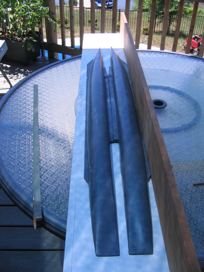

    Firstly, I bought a 5' x 1' melamine shelf and screwed a piece of 1" x 6" soft pine to it at right angles.

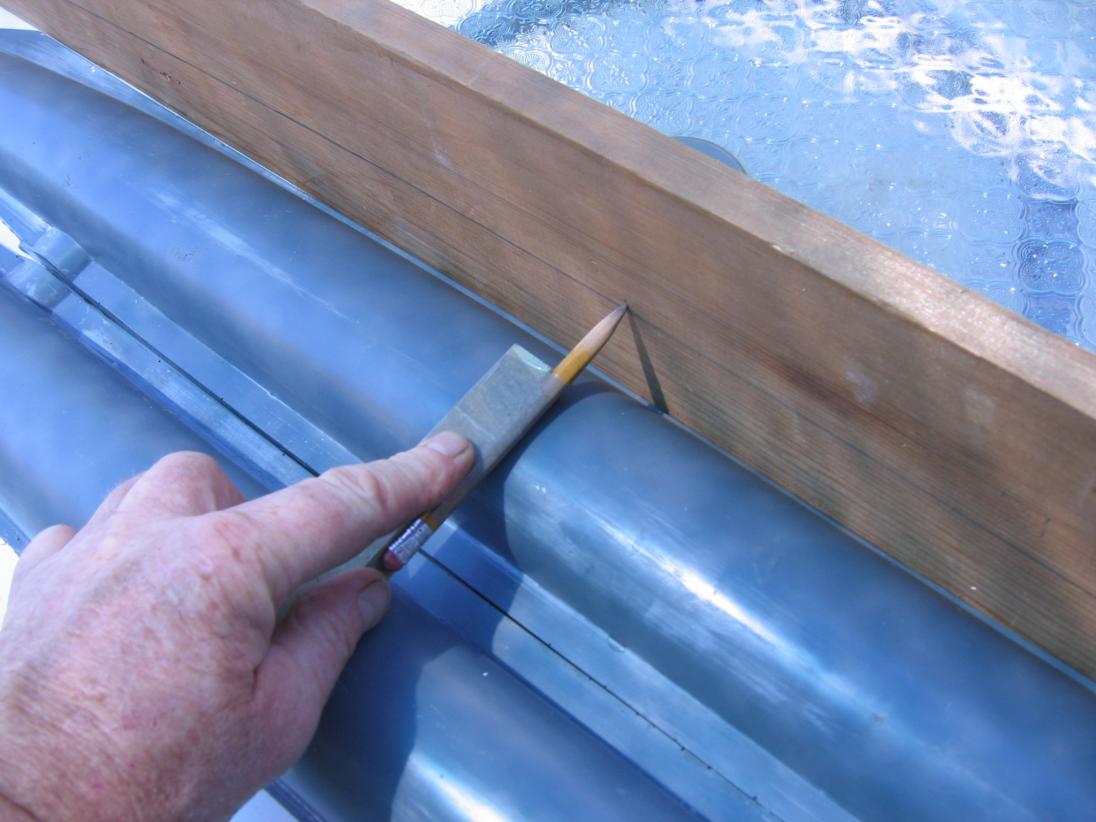

    The object here is to copy the profile of the model onto the pine board. I needed to be able to draw the line evenly and pondered how to keep the pencil horizontal as I dragged it along the side of the boat. After sleeping on it, the light bulb came on. If I placed the second half of the model alongside the first, I could strap the pencil to a long rod and place it over both models, which would keep it level. It worked like a charm.
    Next job is to cut out the profile with a fret-saw.

                  Mike taught me a trick there ... the use of the two halves as a means of holding the stick-assisted pencil parallel as he marks out the vertical plane parting board. Good stuff, Mike.
                  Now, repeat after me: "These are not the Droid's you are looking for ... these are not the Droid's you are looking for ..."
                    Yes, I know - I'm impressed with me too!

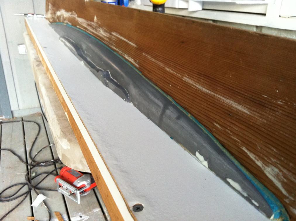

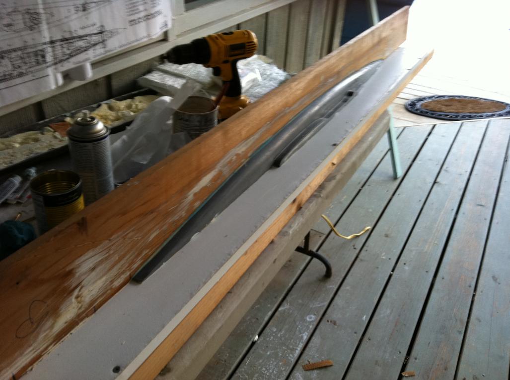

                            Firstly, I filled the hulls with Crazy Foam, and placed some blocks of wood into it, to enable me to screw into the hull and pull it onto the melamine board.

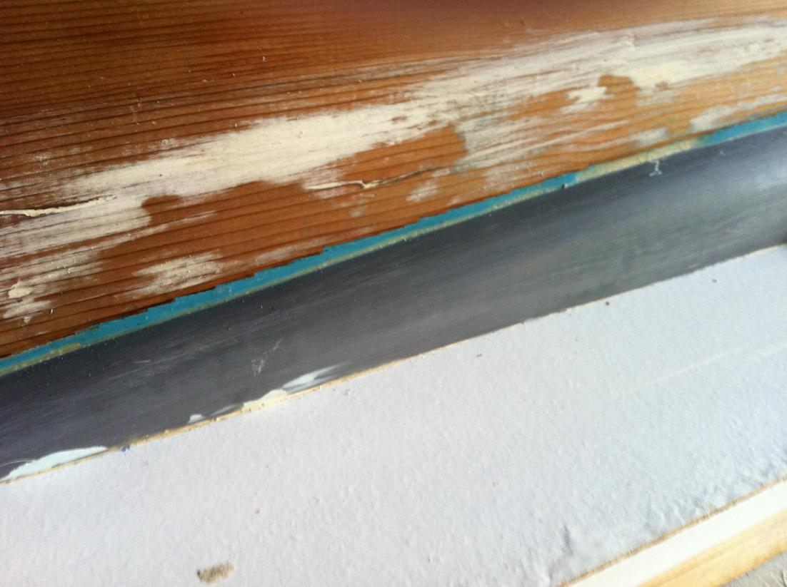

                            I cut the profile out of the pine board and screwed it on top of the 1/2 hull. There was a gap between the board and the model, so I filled that with modelers clay and smoothed it out.
                            Here is the completed article, duly coated with Carnuba wax and silicone.
                            The next job is to lay up epoxy and fiberglass tape in stages, to ensure the edge detail of the mold is captured correctly.
