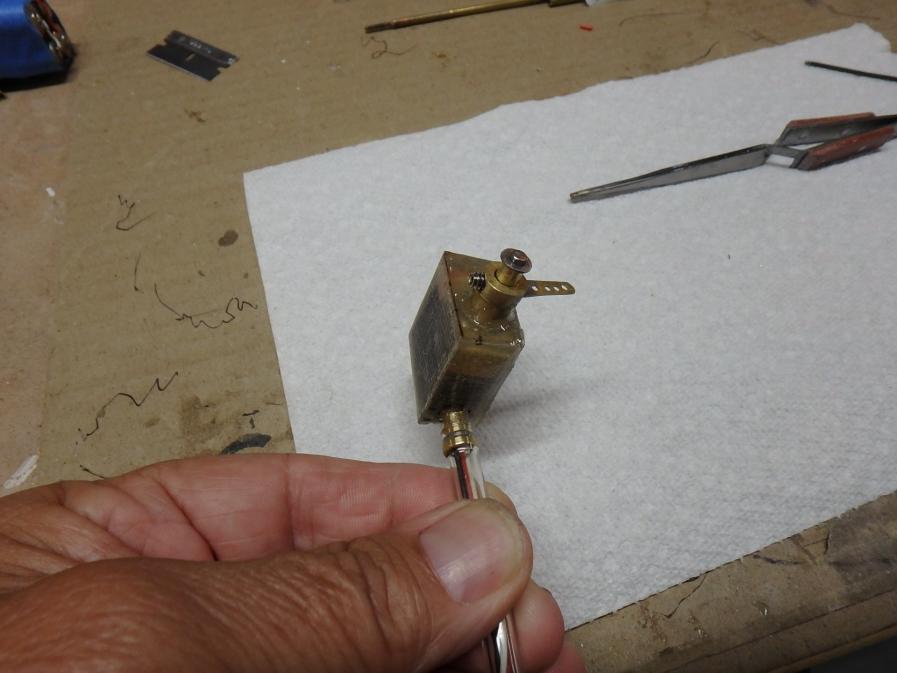

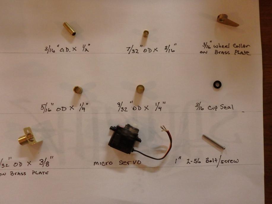

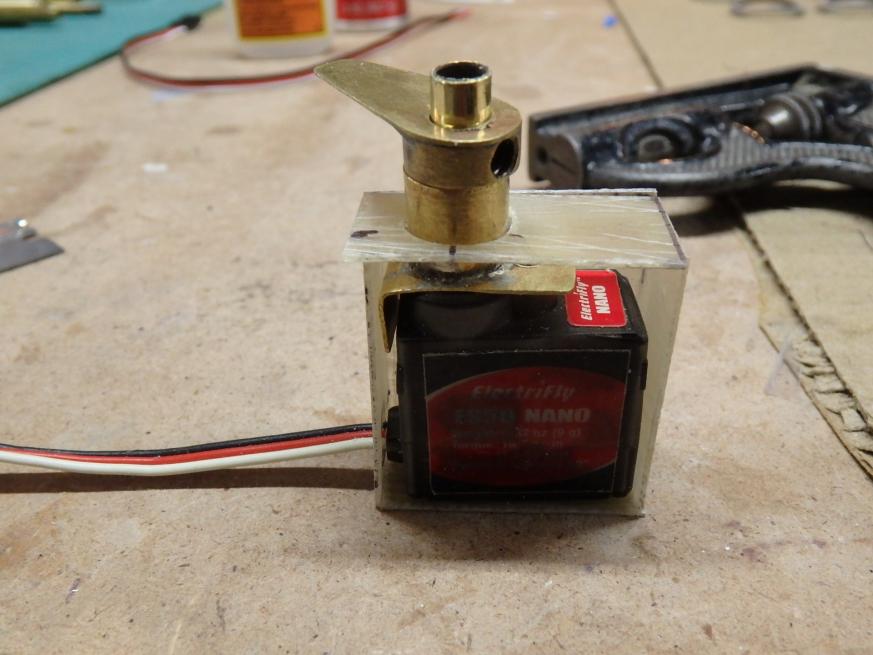

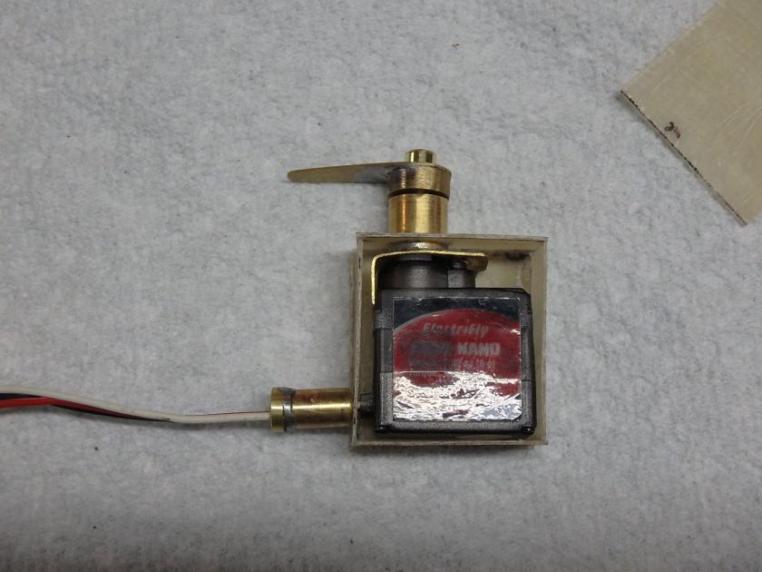

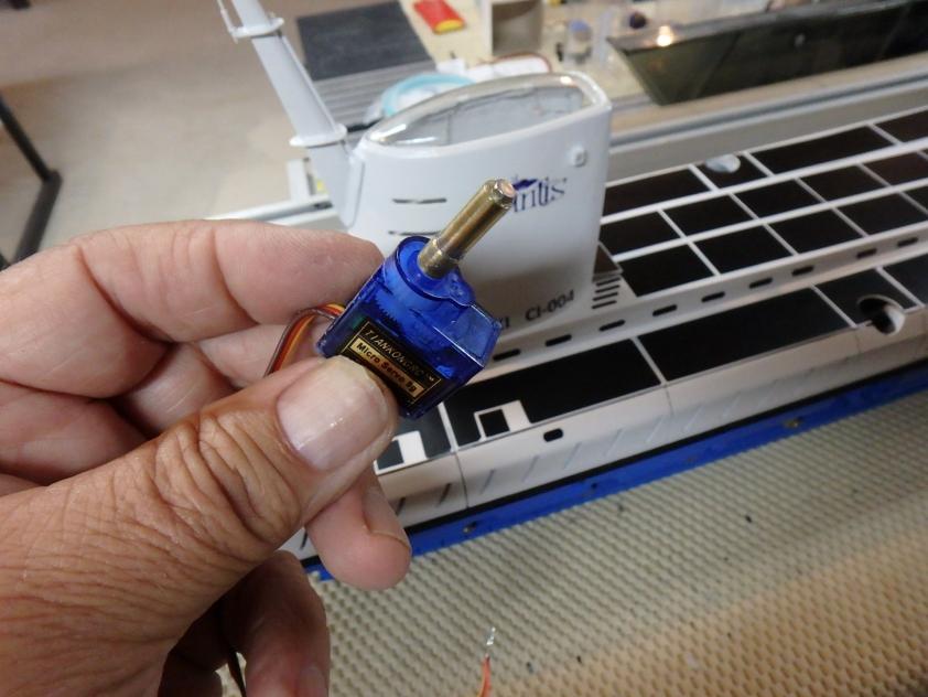

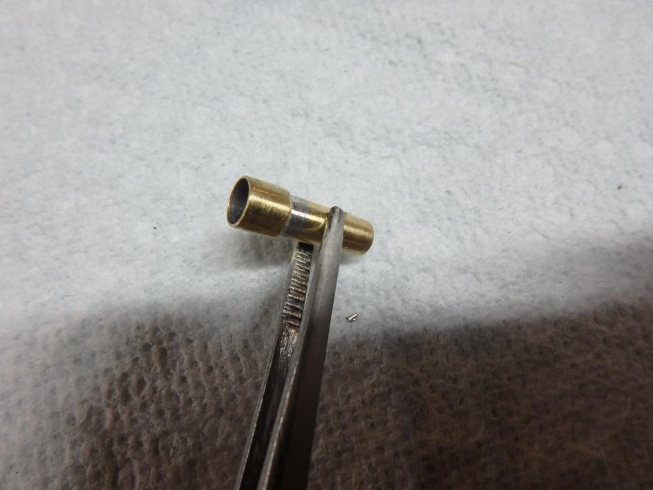

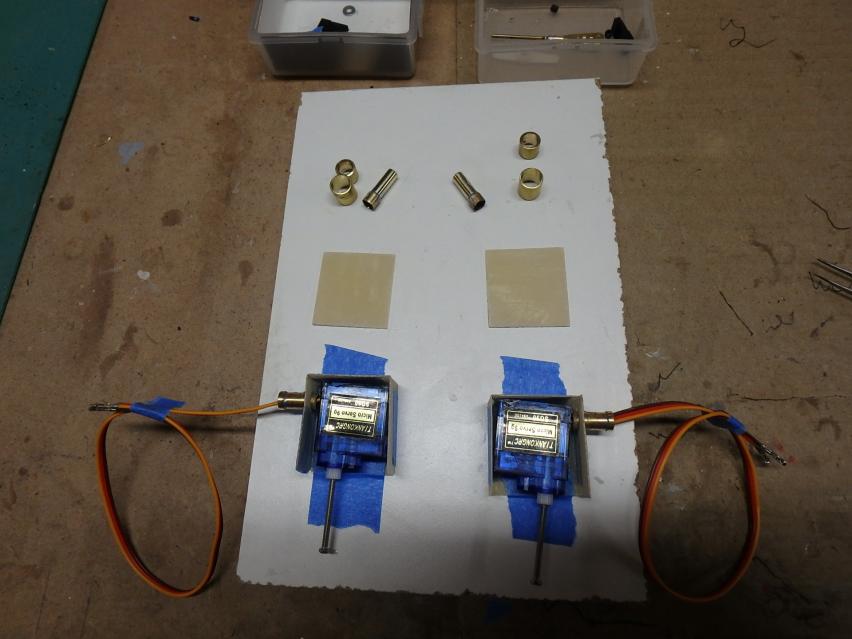

    I am trying to obtain a waterproof (IP67) servo and they are backordered till September 22. and its only an IP 67! So I decided to do what I do and make one...I wanted to use readily accessible parts-concentric sizes of brass tube a cup seal from Nautillus Drydocks and regular soft solder (well within any good modeler's wheelhouse) and the servo is sealed inside a fiberglass box with 5 min epoxy
    The finished product is 1/3 the size of what I am presently using and 1/2 the weight.
    Time will tell-it will shortly be sitting at the bottom of a 4ft 2" Diameter PVC pipe filled with water to test it at Depth...Stay Tuned!
    Update-I stopped the test after 5 days boredom set in and I needed the servo arm back...

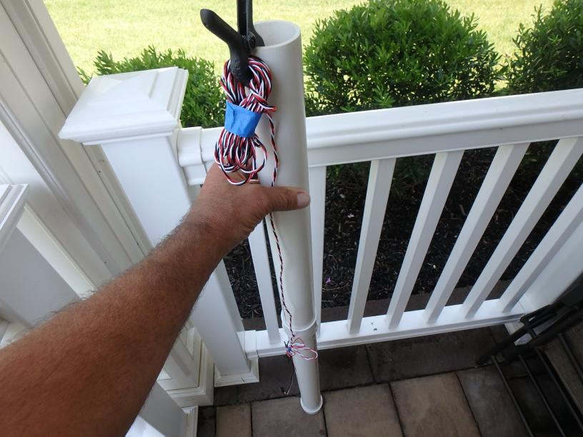

    So-the prototype servo has been operational under 4 foot of water for 48 hours-I guess that I can claim at least an unofficial IP67 rating-I am shooting for one week watertight. As a matter of fact I am so OK with the results thus far that I have started to fabricate the two servos that will go into the model...the prototype was a crunchy bottom of the scrap bin find from 2003 and I want two modern matching servos-
    4ft column of water in a 2' PVC tube-the servo is at the bottom and periodically I test it in situ with a servo tester-I can hear it responding to the inputs without having to remove it each time.
