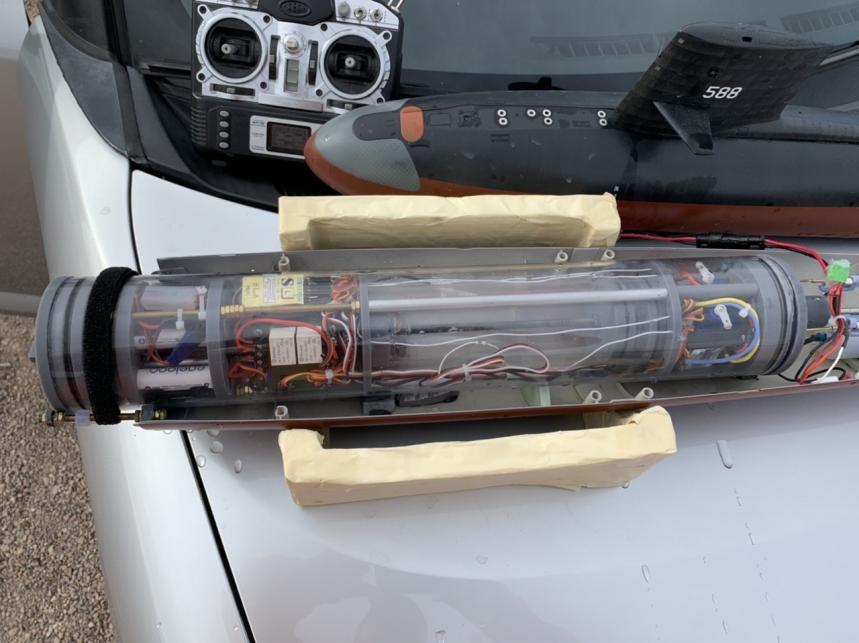

                        I got one better and it is what I am moving to more and more. Just keep the antenna in your dry space. I have done elegant zig-zag and just waded the antenna in there (and I read all the experts that talk about crossing your antenna) they all worked. If you are going to use your antenna in the wet, put a rod in your bulkhead and solder your antenna to each end. The rod should extend interior and exterior to the bulkhead. That way once you seal that rod in, water will not creep back into your dry space. David used a threaded rod and used nut and washer to fasten the antenna down.
                        Here is my current Skipjack no exterior run great signal.Click image for larger version  Name:	E95A9374-CBEB-4730-B097-8A087724705E.jpeg Views:	0 Size:	65.5 KB ID:	160362

                          Just visualize the wave coming off your transmitter antenna like in a NCIS show animation and visualize that wave cutting across the antenna of your model... The more of the full wave that cuts across that receiver antenna, the stronger the received signal. If the antenna is curled up inside the WTC I would think the reception is not as strong as if the antenna was presenting itself in its full length or as full length as possible to those waves.
                            • 3767
                            Bob, no argument from me. I am not smart enough to understand all the science in radio propagation or reception. Maybe the crumpled antenna or the one in the Skipjack above have reduced range, I just never saw the difference in the waters I ran or the distances I went. This is my experience, your mileage may vary.
                            • Bob Gato
                              • 898
                              You know Tom you probably right... The old megahertz radios had so much non line of sight power.. with a correctly set up non glitchy sub, you'd probably never see the difference.. except maybe past 6 feet down.
