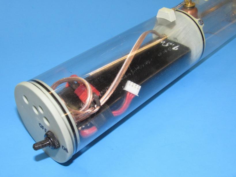

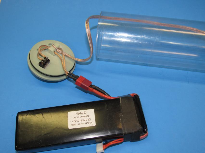

    Lithium-polymer in the dry is the way to go -- though it's not what you asked for. Why? Because you don't need to give up much internal volume to them as they have the highest power-density (so far) of any chemistry currently available to us.

      I have done it all. Dave is right. Gram for gram, LiPos have the highest energy density and hence biggest bang for the buck. I have, however, found that in some cases, running wet just makes sense. I use SLA when I can, and if space is a bigger concern, a water proofed NiMh. To date, I've been too chicked to waterproof a LiPo, but an upcoming build will have a little 1500mAh in the wet.
