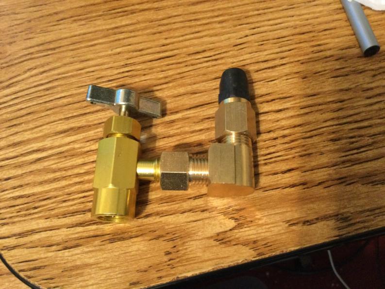

Hello $3.99 12oz Can R134a
Here you have, ;0)
Parts....
R134A Self-Sealing Can Tap with Right Hand Thread, R134A Valve Tool Bottle Opener with 1/2" Acme Female R-H Thread and 1/4’’ SAE Male Connector, Fits for R134A Automotive Air Conditioning Charging
LASCO 17-6783 1/4-Inch Female Flare by 1/4-Inch Male Pipe Thread Brass Adapter
Anderson Metals 56116-04 Brass Pipe Fitting, 90 Degree Barstock Street Elbow, 1/4" Male Pipe x 1/4" Female Pipe
Plews & Edelmann Amflo 126 Straight-On Air Line Chuck with Shut-Off - 1/4" Female NPT
