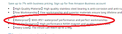

ID:	149804 I am glad that you are doing your own testing and checking-you can't believe what's written in these ads-I don't have to say but IPX1 and waterproof should never be in the same sentence! ..it's obviously a mistake and the motor appears to be pretty water resistant. (This was from the first link above)

              LOL, I noticed the IPX1 written too before I decided to pick a couple up to test.
              And you’re correct, never believe anything written in these ads. I find so many errors in them constantly. Especially when multiple sellers are offering the same product. I usually try to trace the product back to the manufacturer and see what data on the product they offer.
