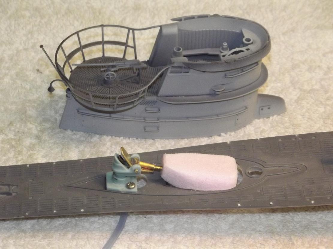

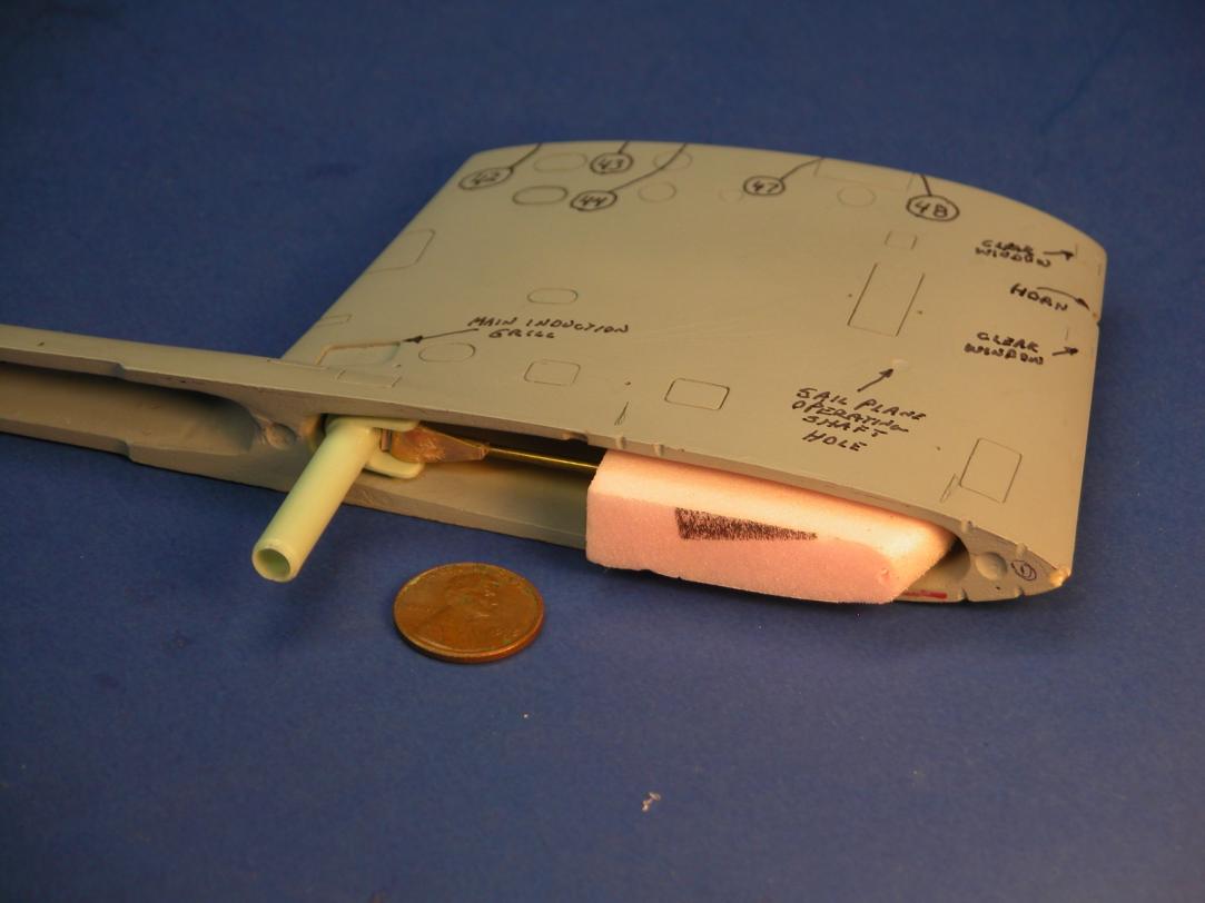

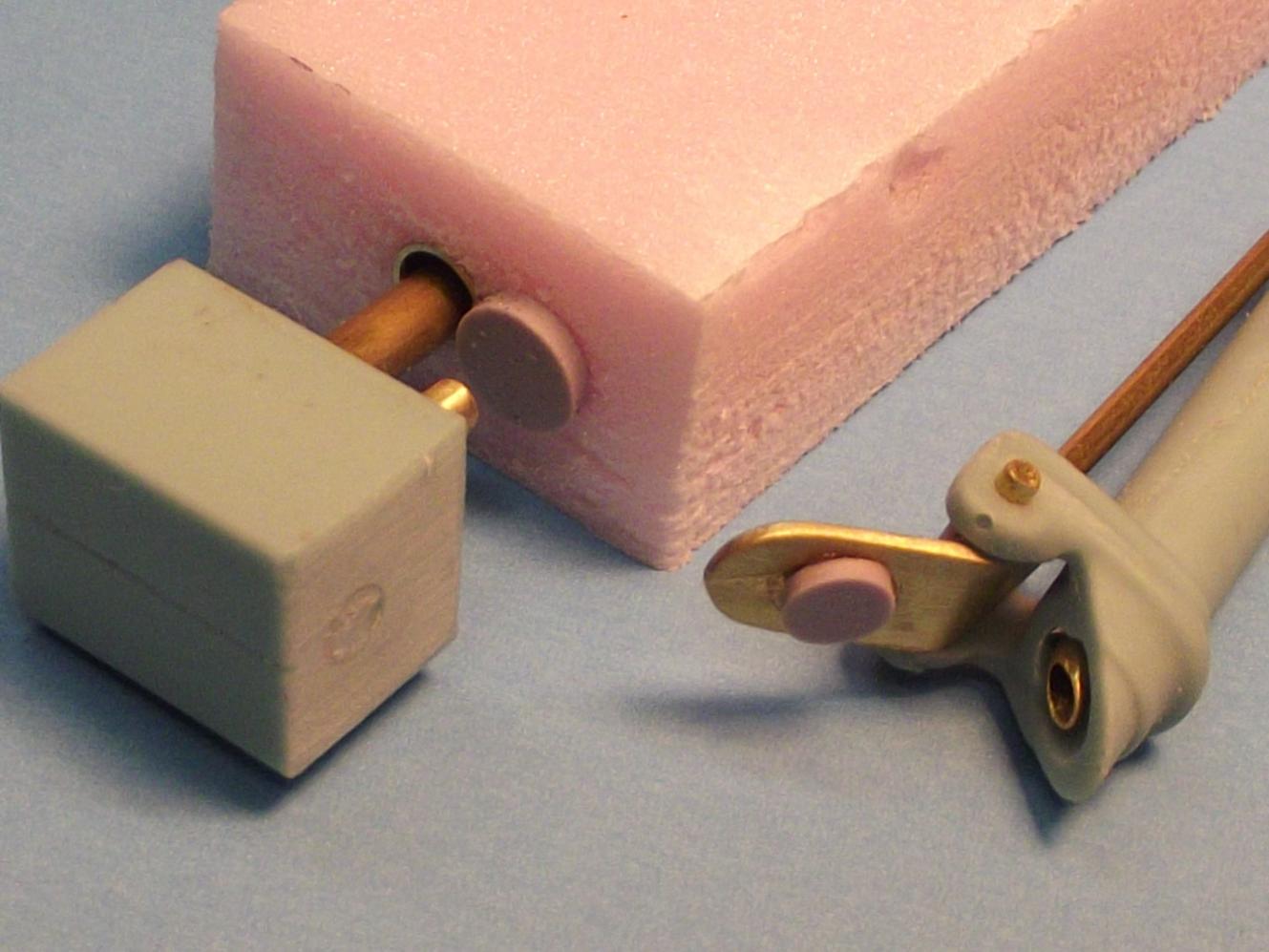

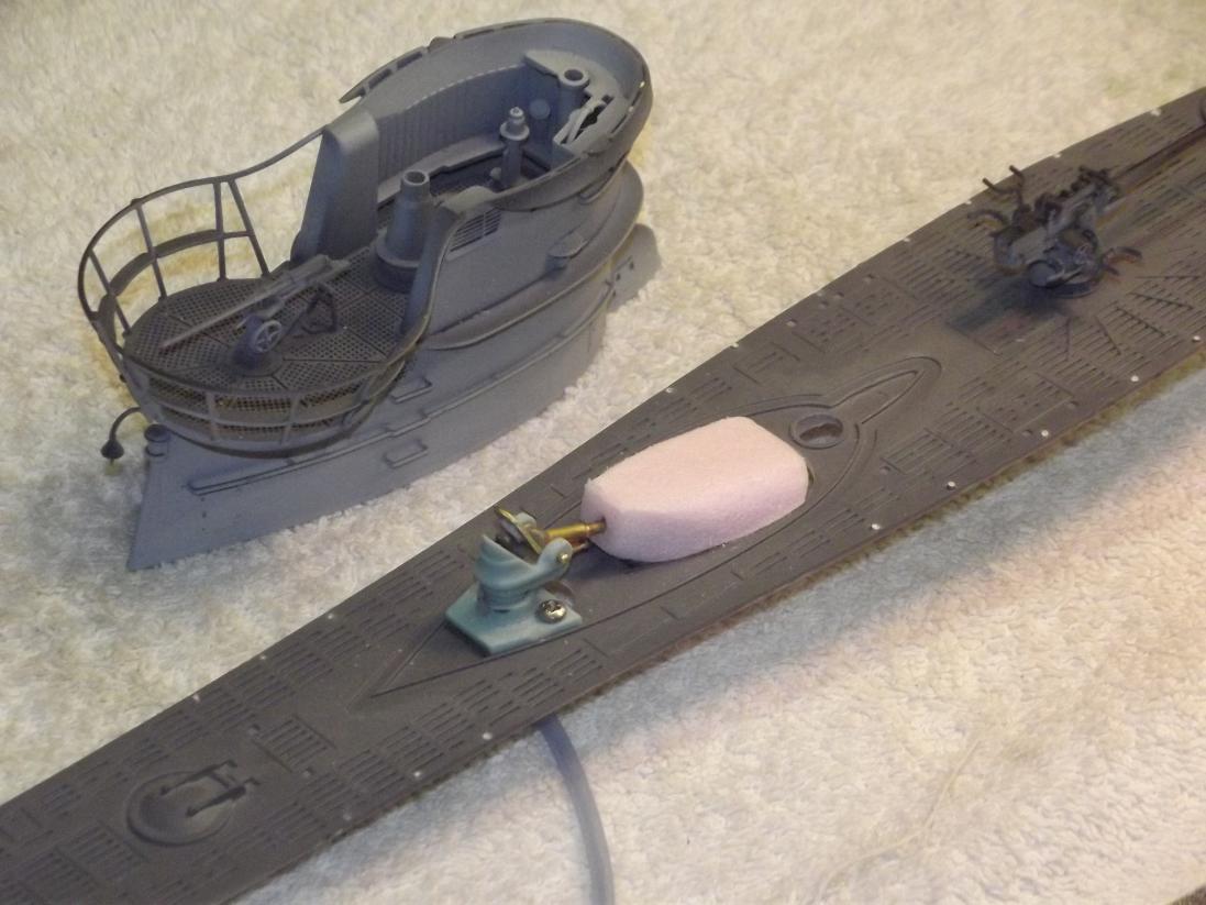

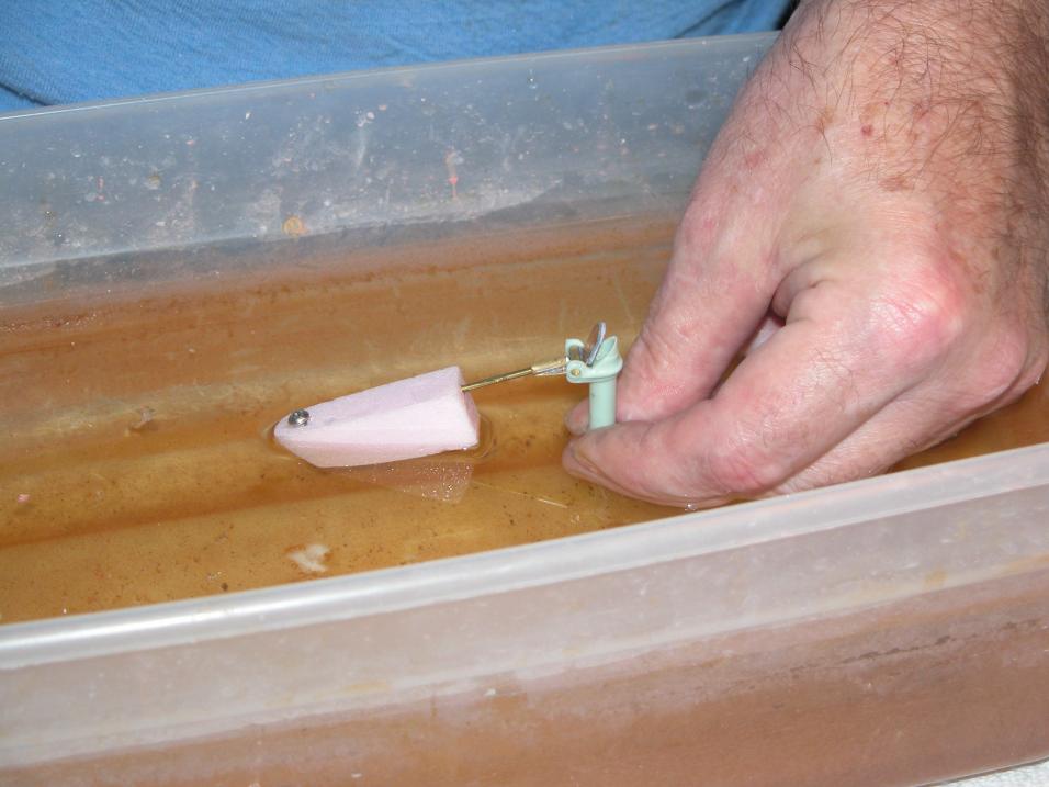

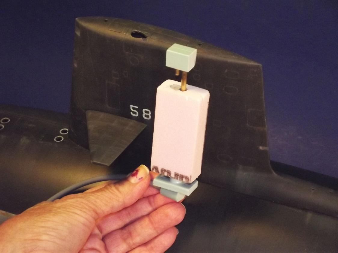

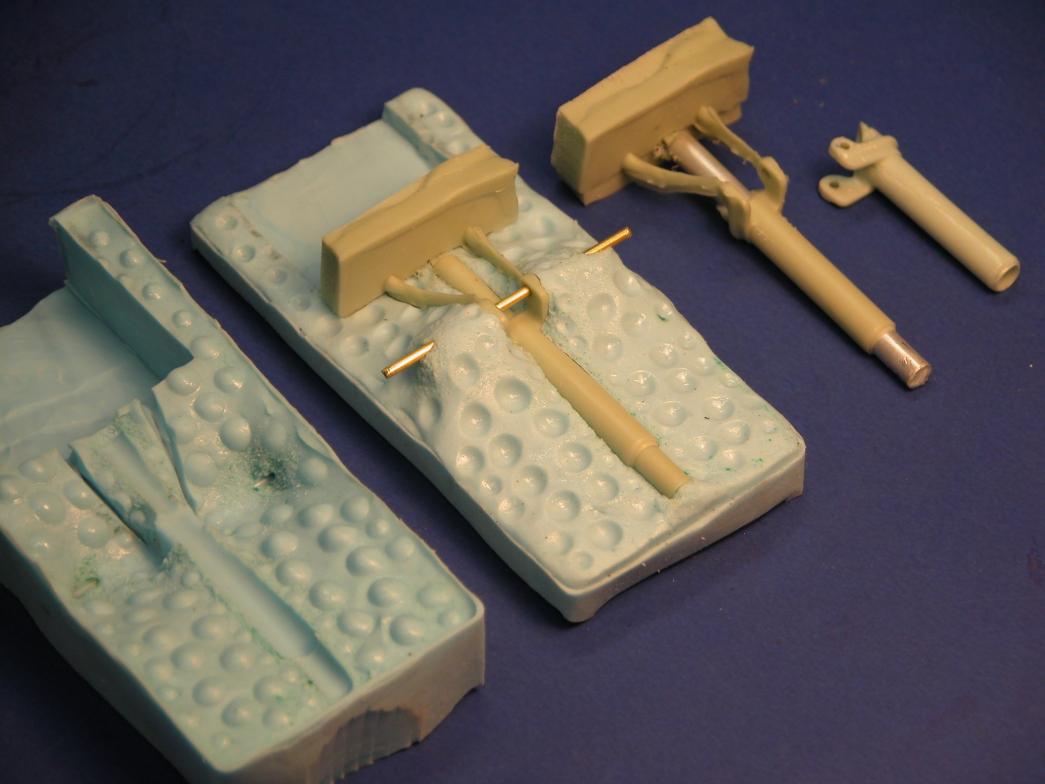

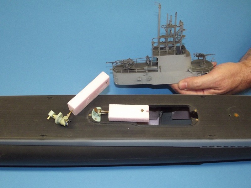

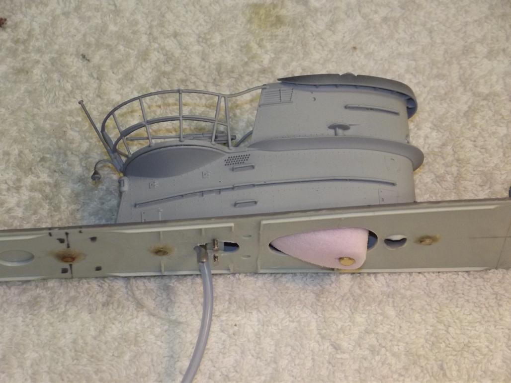

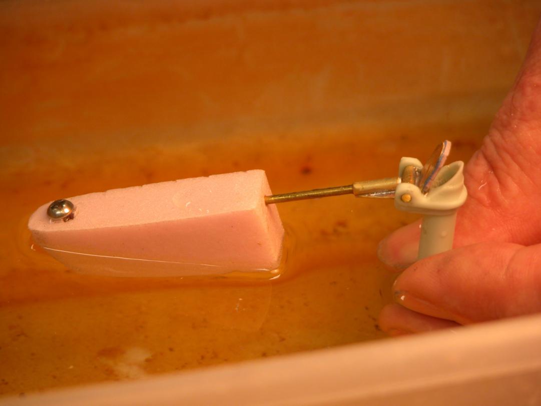

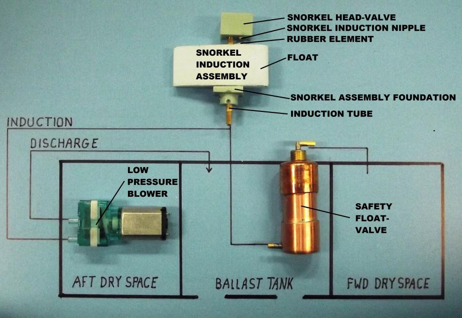

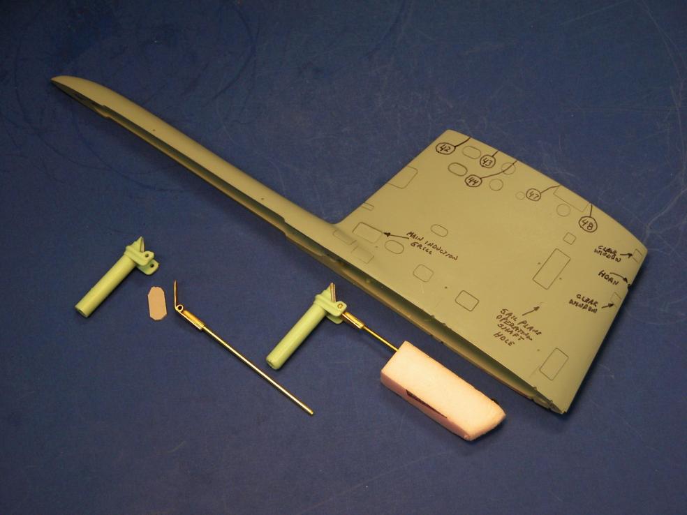

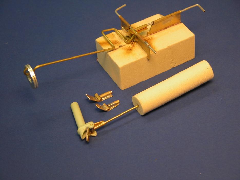

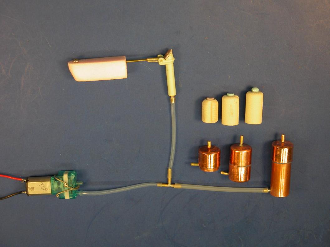

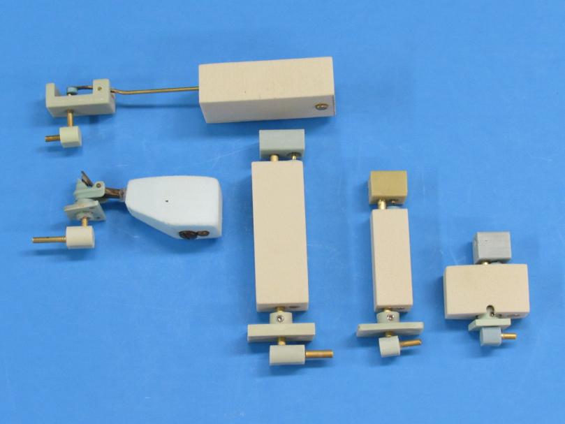

    Our SAS type SD's are sold with a snorkel (float) valve. But, if you need extra snorkel valves for multiple hulls using the same SD I'll send you extras, no sweat.
    Yes, the partial vacuum created in the SD when blowing using on-board air acts on the snorkel valve rubber element and intake nipple to hold them up against one another tight. The force is a function of differential pressure between atmosphere and inside of the SD; as well as the internal area of the intake nipple. I minimize the intake nipple area (only .030" inside diameter) and add enough weight to the base of the float to insure gravity will overcome the 'holding force' presented at the nipple-rubber element. Through experiment I determined the amount of weight the float has to be to still 'float' when displacing water, yet having the oomph to pull the valve open on a nearly evacuated SD cylinder once the snorkel mechanism is above water.
