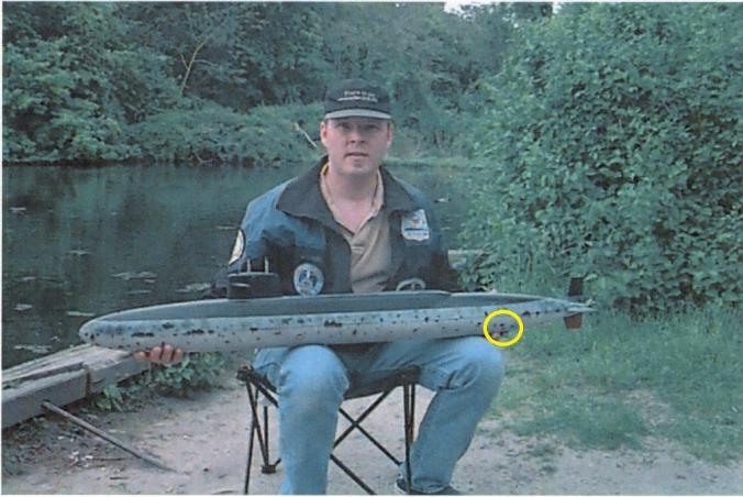

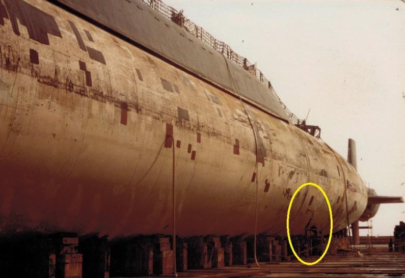

          Even though we were authorized to take photo's of GRANT in Drydock (good old Los Alamos) this is as close as I dared to taking pictures back there! Sorry for the quality, these old pictures are fading, wish we had scanners years earlier to have preserved them. I left them as simple holes on my 1:96 boat for drainage.

          v/r "Sub" Ed
