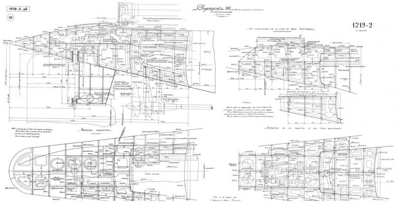

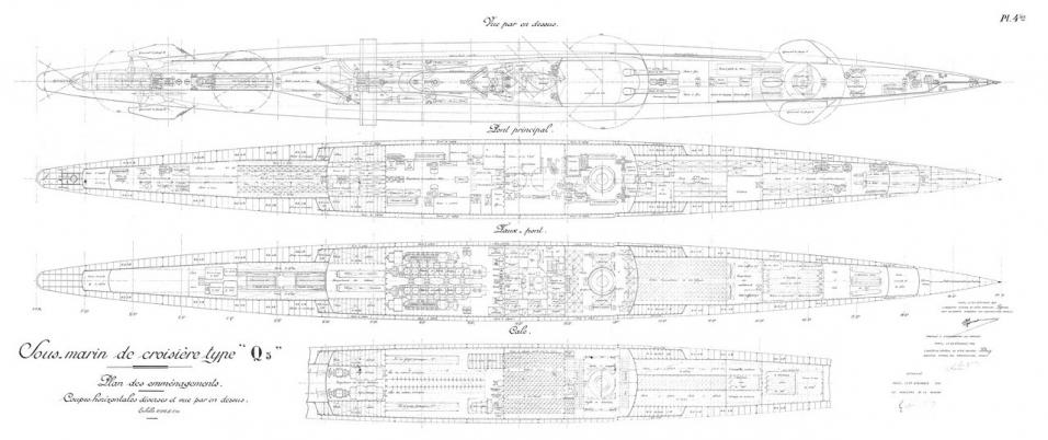

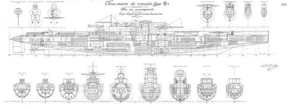

                The large 3 bladed props the starboard side is offset forward of the port one aft. the starboard prop is left-handed rotating counterclockwise when viewed from behind. The port prop is right-handed and rotates clockwise The prop shafts as explained above are parallel, and closer. The thrust lines combined are closer to the center line. This should make more noise I'd expect, but the sonar of this period probably would be inconsequential. to distinguish apart but it did allow the prop thrust more concentrated at the center line to flow over the rudder aft behind these props.
                Th arrangement was common on French submarines of this period. The Rubis drawings (Saphir class minelayers) are arranged this way tooo. It's a unique feature of French submarines then 1920's to 1940''s.
                This practice continued till the Cold War Daphne Class which were separated apart more. the Daphne's were based on the single prop , the 4 Arethuse class subs. The Dauphines were enlarged medium size fleet submarines.
                Welcome to French subs...lol
                Click image for larger version  Name:	SURCOUF1929-C003-2.jpg Views:	0 Size:	54.9 KB ID:	187049
                Click image for larger version  Name:	SURCOUF1929-C004-B-2.jpg Views:	0 Size:	52.9 KB ID:	187050
                NOTE ON THE SAPHIR CLASS drawing below the Prop OFF SET IS REVERSED! The starboard Prop is offset farther aft in this class. In Surcouf it the Port side.
