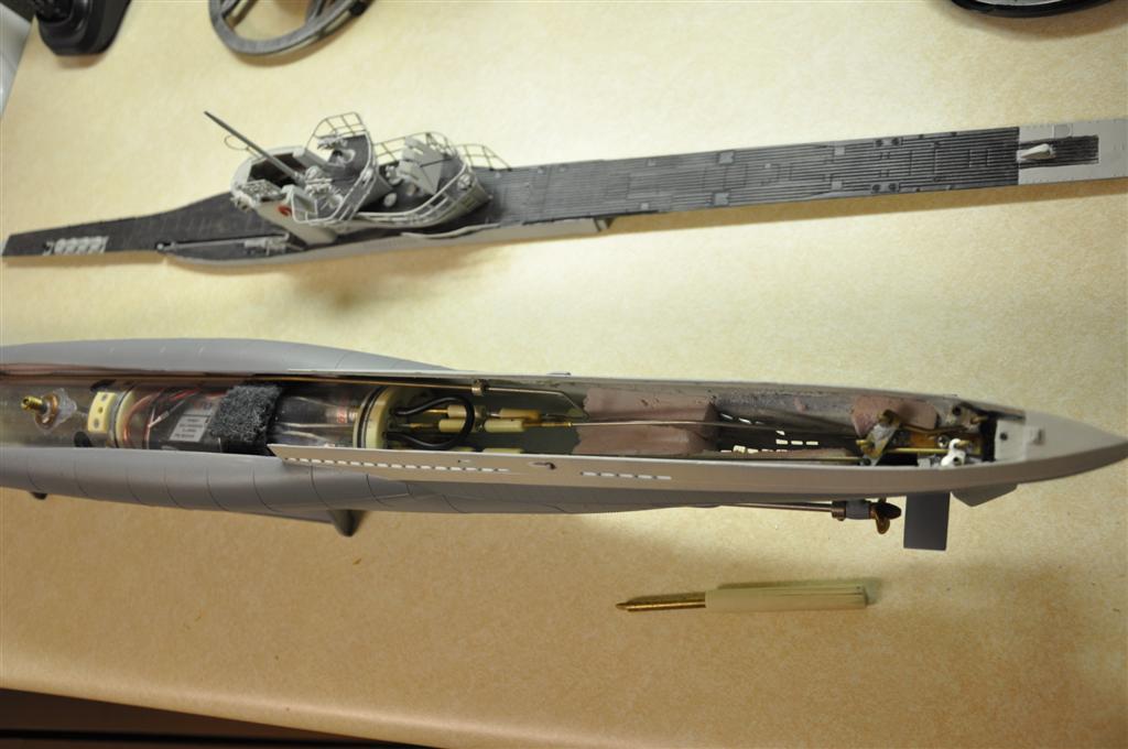

          #34
          Position the sub driver 10" from the bow of the boat and you should have success. To make the saddles for the sub driver I simply layed the SD endcap ontop of the sadles drew a line and then cut them out. You can see in the photos how I chopped my top. I also reinforced the entire upper deck with styrene plastic. If I were to do this again I would do it a bit more sparrignly or perhaps use a lighter material like carbon L frames. Keepin the weight off the boat and as low as possible is the key here. The only weight you want ot add is keel weight because this boat needs the stability . Let me tell you something though, once you get her together she will be a screamer. Driving the thing reminds me of watching the nautilus from the league of extrordinary gentlemen. Its like a knife through butter :)

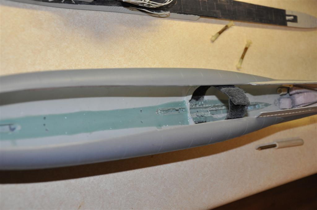

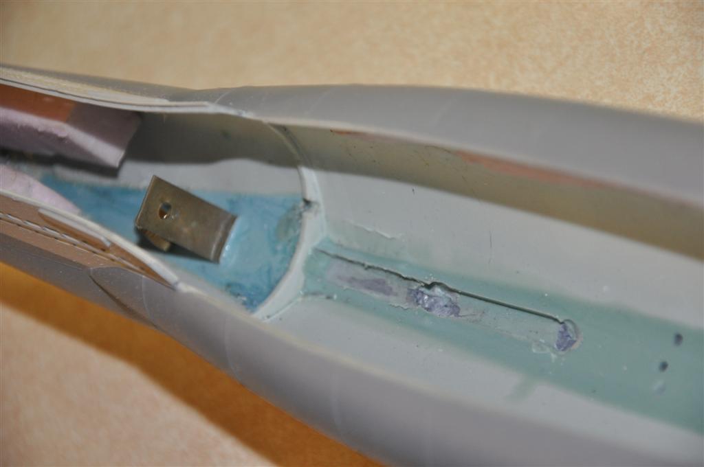

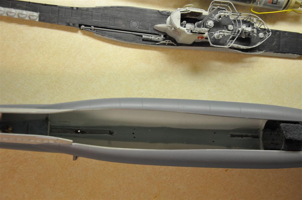

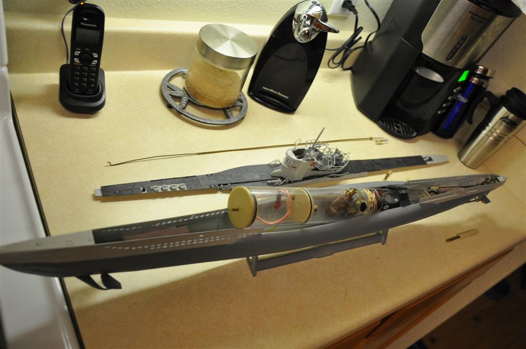

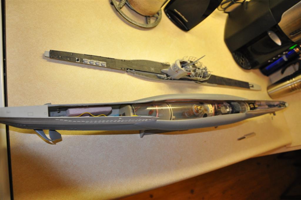

              #36
              Thanx for making me take it apart toppack it was quite happy how it was :)
              Here are some shots of the removal and the saddles installed. Since I am sure you are going to ask toppack..... The long slot holes you see are from the removal of ballast bars. Initially David and I loaded the keel up with weight. We then discovered that we couldnt jam enough foam in to counter act it so we had to dremel some weight out. The rear end is especially sensitive to weight. I wold beging with the mid section. The fwd section is very capable of supporting 2 lipo packs in parallel though.

                #37
                the plastic bulkheads go exactly where the model book revel supplied tell you to put them.
