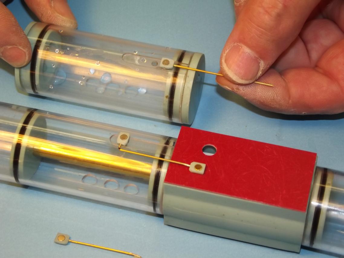

            • 3767
            Maybe a electric magnet. When your batter dies it releases the buoy or failsafe cuts off power.
            • Scott T
              • May 2009
              • 414
              David did create this magnetic coupling on a Subdriver.
