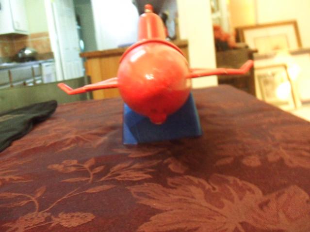

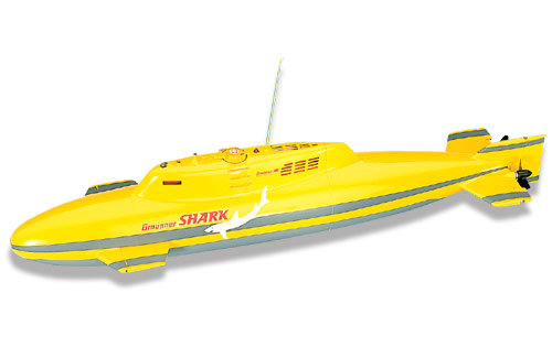

    That has changed now and small is back in with a vengeance,the wonderful Graupner Shark with its dual drive and sleek lines make it a blast to run at full!But she has a problem when she goes that fast one that really makes her a bit tricky to operate safely for she will drill her self into the mud,I almost lost her at the springs the other day she went out of control and went right into the mouth of the spring and by sheer luck got stuck a few inches in in a crevasse,a few inches more and she would have been unreachable!
    The reason is that long sail it causes the bow to dive on turn much like the Skip Jack did.

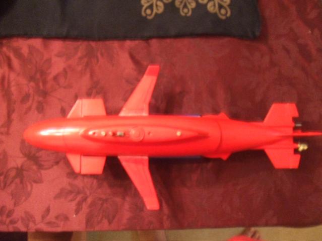

    Well I could not eliminate the sail so I decided to install wings or large horizontal stabilizers I found on a airplane model,the problem was how to install them so that they would be perfectly aligned and at the right angle.First crazy glue was applied on the wing then once dried Epoxy bead all the way around then 2 large wood screws one per wing screwed in from the inside out hold the wings in place.
    The epoxy and the rest was done after extensive testing in my Koi Pond thClick image for larger version
ID:	100548ere the water is clear and not deep,so I ran her at all speeds and maneuvers and found her to be very stable no more diving at high speed turnClick image for larger version
ID:	100538s.Now she even leaps out of the water and skims over the surface like a plane trying to take off I can then make her dive nice and controlled Click image for larger version
ID:	100539even at high speed.

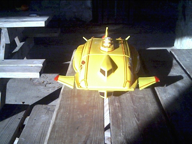

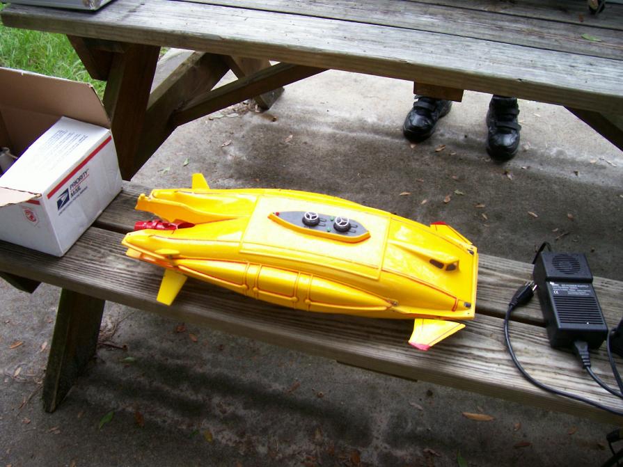

    The other sub is one of my old favorites the Octura ZX ,a modifieClick image for larger version
ID:	100540d Deep Star VI I believe the name is,she has modified dive planes that operate like ailerons,a Jet Drive ,water cooled,about 15 LEDs 2 are higClick image for larger version
ID:	100541h intensity ones ,dynamic diving ballast system and last but not least a new casing.She can go down to about 12 ft and banks like no other andClick image for larger version
ID:	100542 is very fast!Highly maneuverable like a Jet Sky a blast to run in the caves.
    She is a good candidate for Lipos as well as she has 4 each SLBsClick image for larger version
ID:	100543 of 1.2 mah,she runs for about 20 minutes.
    All this in a sub that is under 24 inches long but is quite wide around 7 inches!One would think thClick image for larger version
ID:	100544is design would not work well in water but its fine as long as the forward only planes move in a aileron manor and only by a computerized radiClick image for larger version

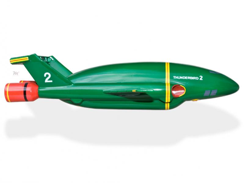

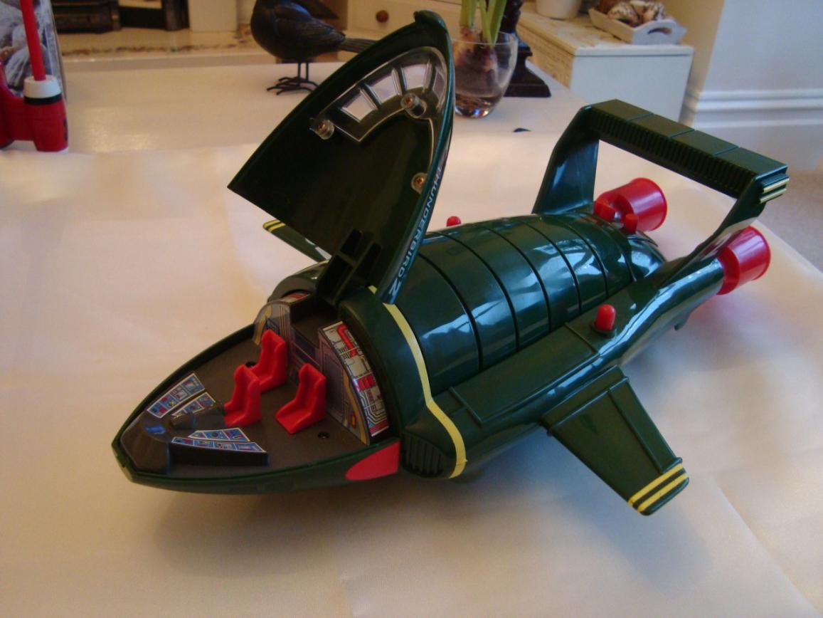

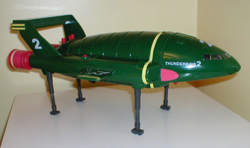

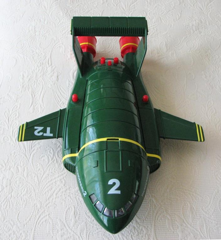

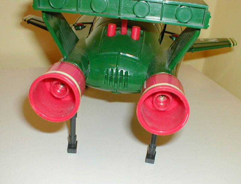

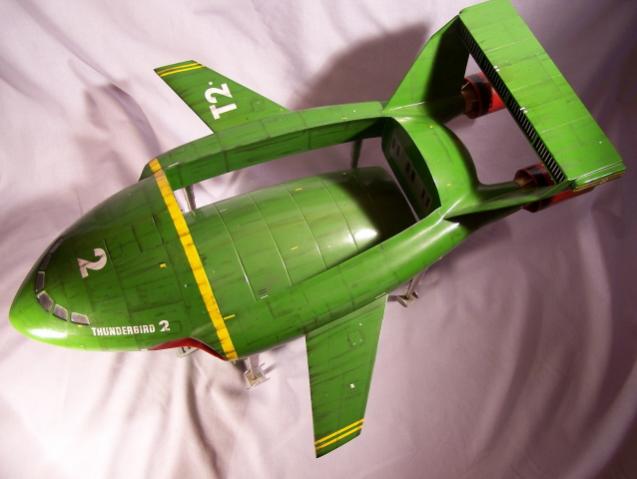

    The next Creation is not a sub but a aircraft originally better known as Thunder bird 2 from the series Thunder birds ,they used puppets bClick image for larger version
ID:	100546ack then as performers ,Oh well,still there ships are pretty cool and this one will make a neat sub,it also will have aileron planes but no JeClick image for larger version
ID:	100547t Drive or I might put 2 jets in the sides,maybe?

      Yes it would but I have not found a model large enough.
      The T2 shown is 12 in wide 7 tall and 17 long,not a bad size and very staut build hull with the center cargo hold that comes out ,I might build it in such a way that it becomes the means to gain acsses to the electronics.
      The T2 should have great hydrodynamics and manueverability and space for a simple syringe ballast system.
