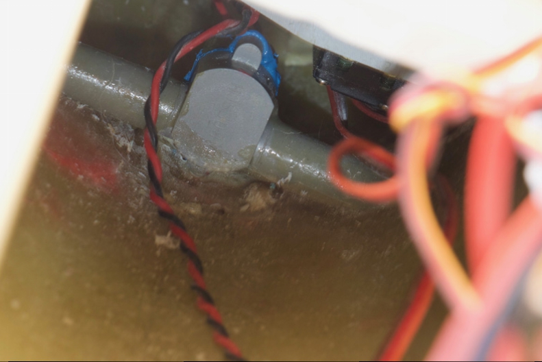

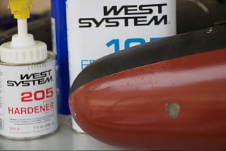

    I received this several months ago from Scott. He was the second owner and this unit needed to be finished up.
    In a water test there was some areas that were causing leaks. One are is the installed bow thruster. It was removed and the openings were fiberglassed over.
ID:	120615Click image for larger version

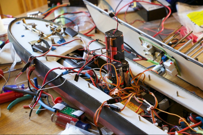

    Taking out the bow thruster was definitely a quick dive into the workings of this sub, which is a good thing actually. You learn how it works and what goes were.
    One of the issues this thing had was the bow planes not fully deploying. I cannot tell you how long it took to figure it out, but it was a lot of time. Things just would not work right. In fact, it seemed it got worse and worse every time I tried to get the unit to remember the range of the servo. Then by luck, I found the magic order to get it working.
    Now, I am in the process of gluing in velcro to attach some parts.
    Here is were I am at:
    The batteries are stacked to keep the velcro flat.

          By the time I get done with this, I hope to have the wiring in a much neater state. It was pretty tidy when I got it, but disemboweling the sub to get to the bow thrusters made me have to undo so much of the wiring, then top that with working on the bow retract and I pretty much disassembled the entire sub.
          As a side note, it reminds me of working on my first Sub-Driver. I had to take that apart and as "scary" as that was to a newbie, it really allowed me to confidently understand how it worked and dispel the false fears associated with it.
