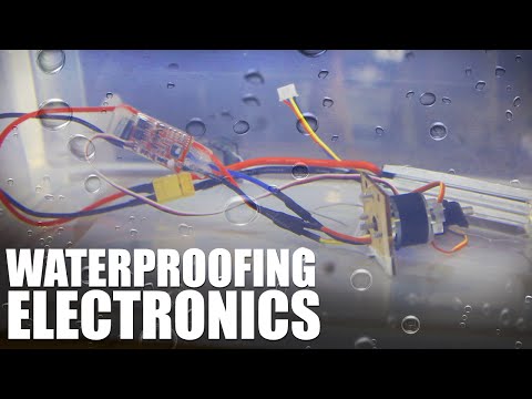

        You can do it too!
          You can do it too!
          In the day it was marketed as, Stumph (spelling?).
            So, why not use it in our subs? It wouldn't hurt, unless it will cause a reaction with the polycarbonate tube. If it did not cause a reaction, it might save equipment if someone did something stupid like not put an end cap all the way on or some other mistake at lakeside?
              What are we talking about? Use what in our subs?
                I've used stumph, and it works, but I found that wet gear (other than unsealed chokes, potentiometers and the like) only need a fresh-water soak-down followed by a blow-down, followed by denatured alcohol soak followed by a blow-down good enough to get the electronics back up to speed.
                Iron-core chokes rot on the spot -- but today almost all RF stuff is crammed onto a sealed IC chip, so it's not an issue in post 1990 gear. If the servo pot gets wet it will die within weeks.
                Long-term immersion will generate mung growth between IC chip board contact points -- this has to be scrubbed off with a lacquer laden acid-brush to clean away the shorting minerals and duck-****.
