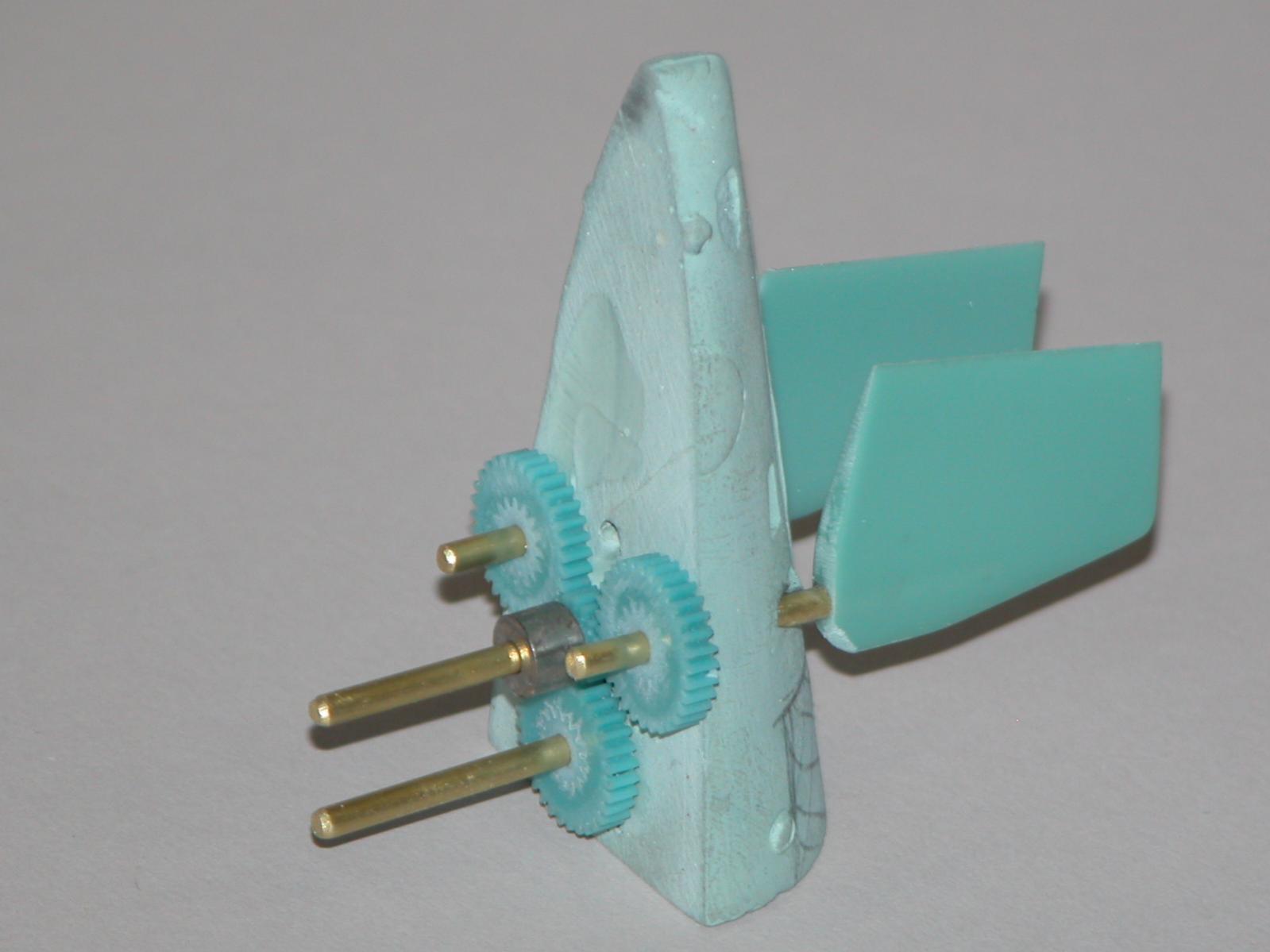

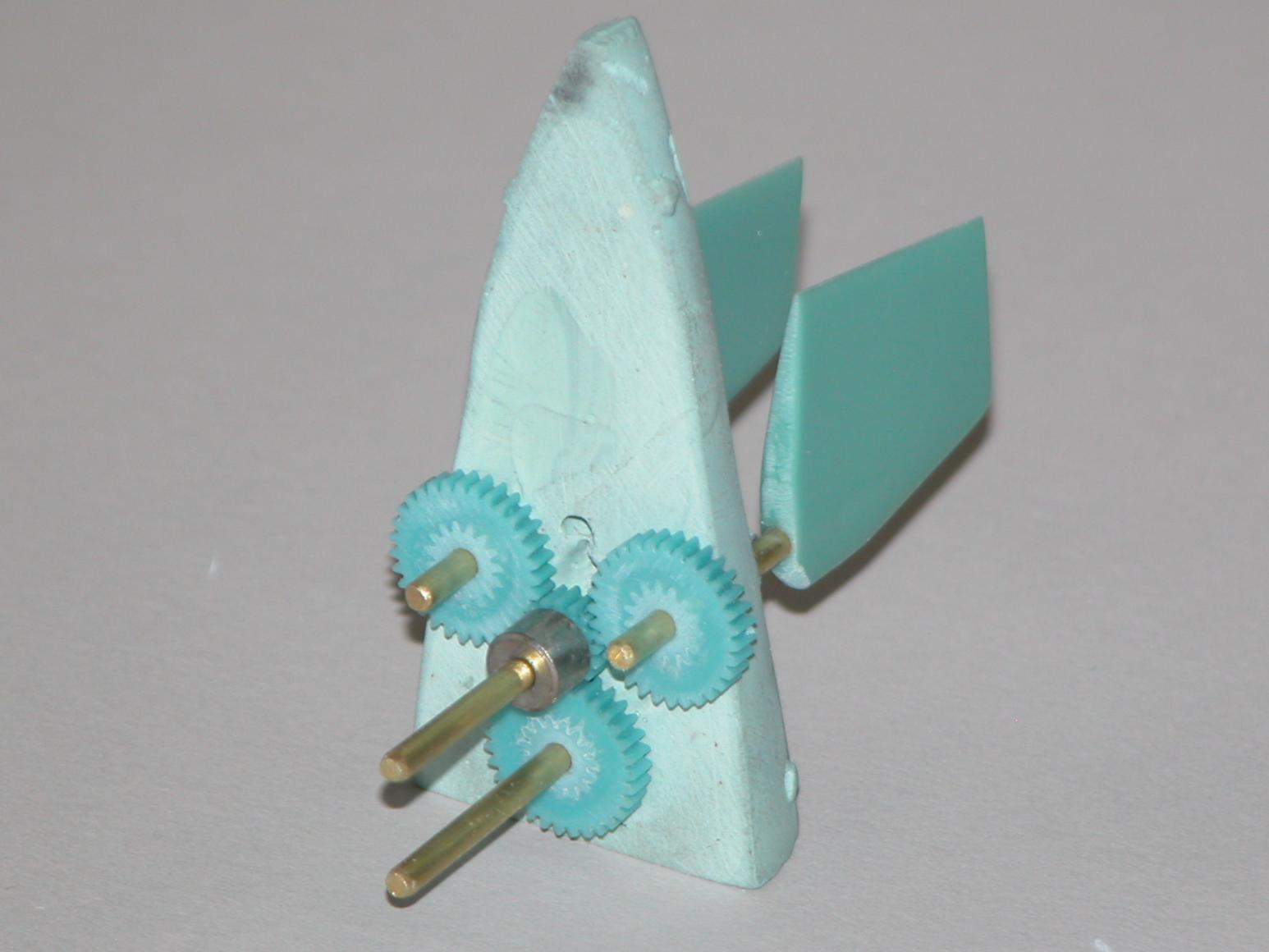

    Hi Dave
    I love watching your thought process while I sit back and critique every step, makes me feel like I am part of the process!
    Why do you need a large driver on the intermediate "idler" gear?
    Would 3 gears ( 1 driver/ idler) and 2 driven with a longer moment arm on the driver do the same trick?
    I am not doubting your design using gear ratios just wondered if the 3 pcs. would accomplish the same goal with less parts?

      Dear pain-in-the-ass, nosy, idiot, can't-mind-his-own-business, squid-throwing, beer-guzzling, Canadian twit:
      (What's with this damn things filter thingy, anyway. Can't seem to keep you bums from the great white north off my screen. I'm busy here!)
      Yeah, Rick, I tried going with the three same sized gears as you observed, but got into gear reach problems without the little idler gear in the center.
      You've caught me doing stupid stuff before: wait a minute while I go and check the three, verses four, gear arrangement again ...
      .... Oh, Nuts!
      You're right!
      After a more carefully gear tooth count I find you're absolutely right: I can fit just the three gears in that train and achieve the objective of the device: turn the rudders through 80 degrees without component contact with the inner hull. I initially tried that but found (mistakenly, as it turns out) that I would run out of teeth to the gears attached to the rudder operating shafts. But, that's not the case at all. Damn you!
      Oh, not to worry. I'll just hit the delete button and no one will be the wiser that you pulled my butt out of the fire (again!), Rick. Can't have people thinking you're smarter than me, can we?!

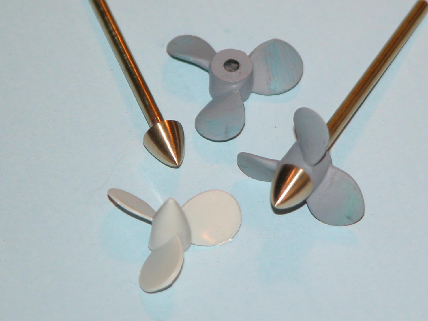

                  More pretty pictures of the type-7 masters ... and friend
                  • Nuke Power
                    Banned
                    • 277
                    David David David. When I left you that kit was in a pretty good condition to hit the market. What did you do that it is taking so long? I see you decided to go ahead and do the propellers anyway. Is that just because you are the prop master??? If it was a matter of poor thrust I would disagree very strongly.
