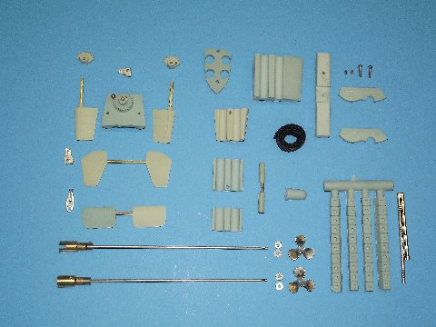

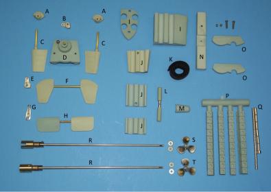

    • A -- rudder gears
      B -- rudder bell-crank
      C -- rudders
      D -- rudders foundation
      E -- bow planes bell-crank
      F -- bow planes
      G -- stern planes bell-crank
      H -- stern planes
      I -- forward T.T. nest foundations
      J -- after T.T. nest foundations
      K -- Velcro SD foundation strap
      L -- pushrod magnetic coupler
      M -- forward sail magnet foundation
      N -- SD foundation
      O -- thrust bearing foundations
      P -- deck and sail hold-down foundations
      Q -- hold-down magnets
      R -- propeller shafts
      S -- R.H. propeller
      T -- L.H. propeller
      Application

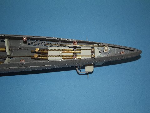

      This fittings kit is specifically designed to convert the Revell 1/72 Type-9 submarine into a practical radio controlled model submarine, in conjunction with the recommended Sub-driver.
      The parts in this fittings kit have been reproduced from robust materials suited to the task. Additionally, this fittings kit makes it possible to integration our 1/72 weapon system within this model.

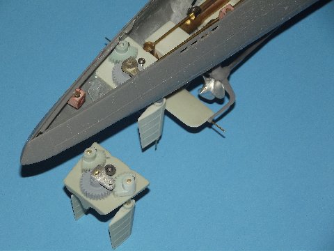

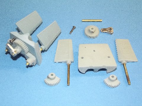

      Twin rudders have always been a head-ache to make work properly -- we've solved the problem for you by providing a rudder mechanism that is easily assembled and slips into the lower hull with the minimum of fuss.

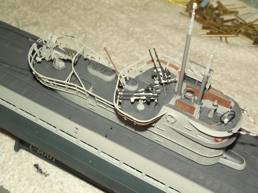

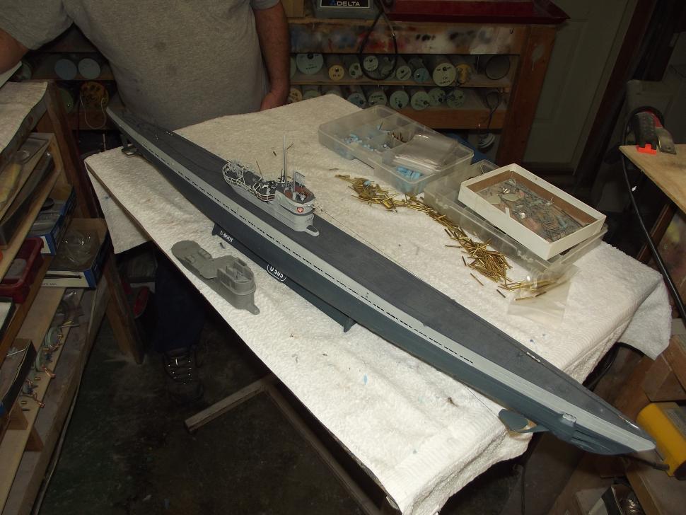

          Al Lintz is one of my retired-navy buddies from way back. This bum currently is the senior engine and air-frame guy for the big 'fighter factory' museum/airdrome out in Pungo -- this nations largest collection of flyable WW-1 and WW-2 era war-birds. His idea of a 'vacation' is cramming his ass into the front end of the only flying British Mosquito (a very, very hot strike-bomber), and making the summer air-show circuit with the pilot-owner -- his task to keep the thing in flying shape for both ferry and show flights.
          As a youngster this nut-ball Gunner's Mate crewed on fast-boats in Vietnam. We watched Apocalypse Now. He lived it! After that horse-****, Al spent the remainder of his navy career running the armories aboard most of the underway and in-port duty stations he was stationed at.
          How this certifiable nut-job got his FAA tickets for aircraft engine and air-frame work is beyond me! My personal misgivings aside, Al, in these parts, today, is the go-too guy for old war-bird restoration, repair, and overhaul work.

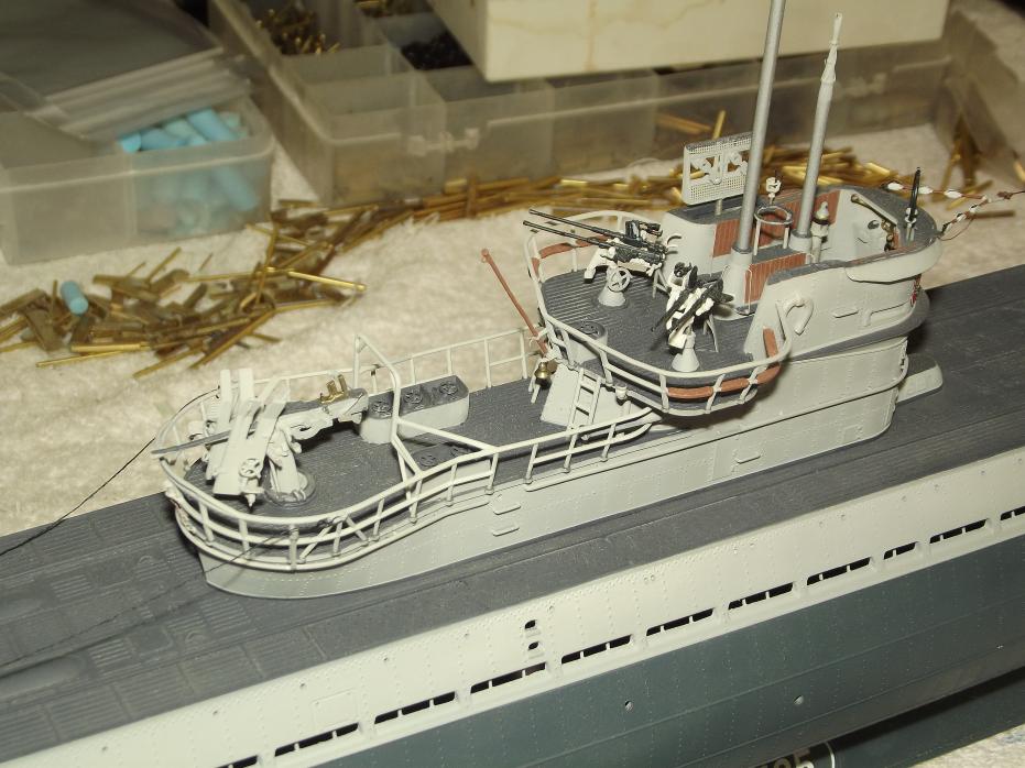

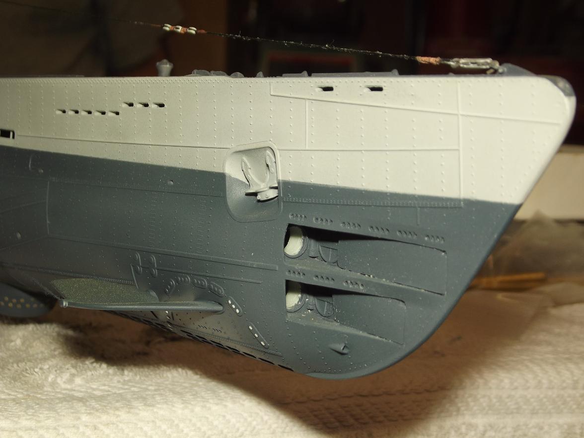

          So, he and I have been playing with r/c submarines for decades. Recently he got a massive hard-on for the new Revell 1/72 Type-9. He bought a kit and we talked it over -- I told him to lay off the detail and painting till we got the fittings kit in and the SD outfitted and integrated within the hull. No, not this smart-ass: he installed the closure magnets, works out the linkages, and -- before even getting the SD -- details and paints the model! In record time, too.
ID:	93274 Man! That's a nice looking model, Al! And the work he did on the gun-stations aft of the sail is noteworthy.

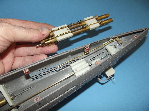

              The fittings kit arrived today.
              now the real work begins.
              Time to prepare the Type IX for all the cutouts.
              Thanx for your fittings kit
              Are there any places to cut out on the deck to vent the trapped air?

                Not really necessary on the plastic deck, but if you wish to have an open deck, the brass photo etched is pricy, but fully detailed and open. I'm waiting on my fittings kit, which should arrive today. I am opening up the hull while I have been waiting, an will post more pictures later this weekend on my Revell Type IX project thread. I am building two separate hulls, One with the brass P/E flood holes, and one cut with simple tools. The P/E took about 10 hours to accomplish, The hand cut, I have around 24 so far and still have to cut the shaft holes. I will need the carriage bulkhead and the prop shafts to line up the cuts, this time, since on the first hull I made my own fittings and shafts etc.

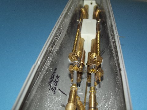

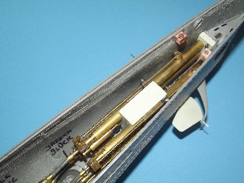

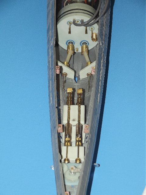

                  Question for HNSNBN on the fittings kit, shaft bushing cradle. The set screw, on the stainless stop, sticks out and rubs on the hull even after I removed quit a bit of plastic aft of the seperation gusset on the rear section of the hull. I could grind the screw off a tad but it most likley not be removable again.
                    • 13985
                    Grind a flat on the shaft, under the set-screw. The screw will set deeper into the collar, no longer making contact with the hull.
