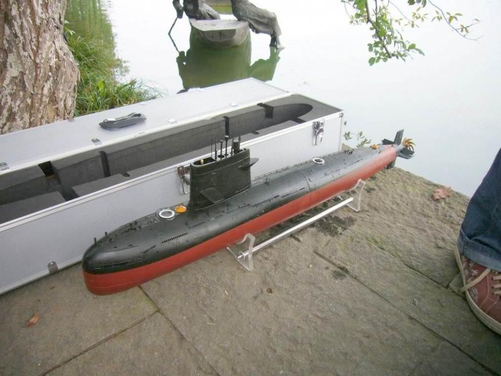

              Hermill, I beleive that this is a picture of your boat. Is that true?

                • 13982
                That is one good looking model. Well done, Feng!
                • herrmill
                  • 360
                  Yup, took the photo myself.

                    I like the case too!
