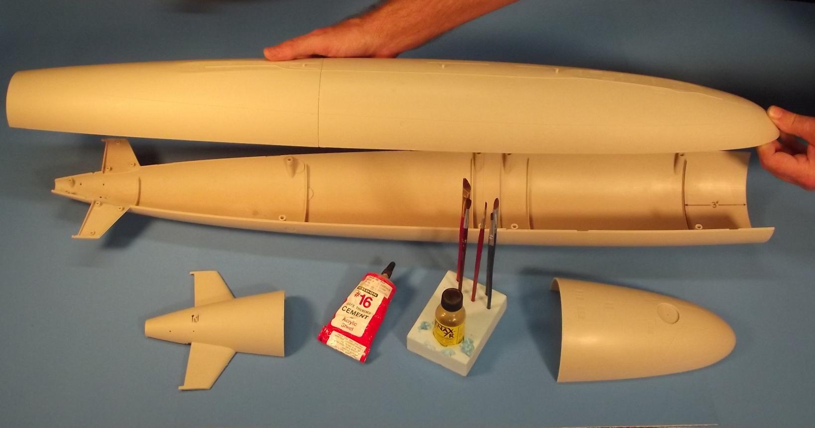

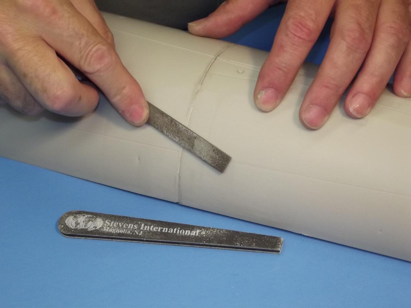

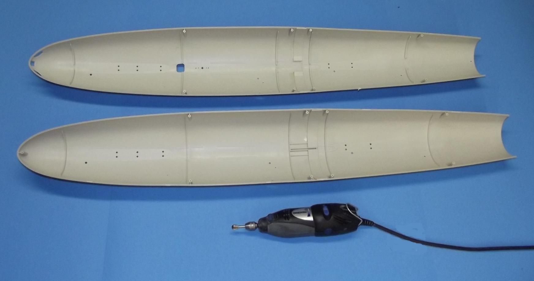

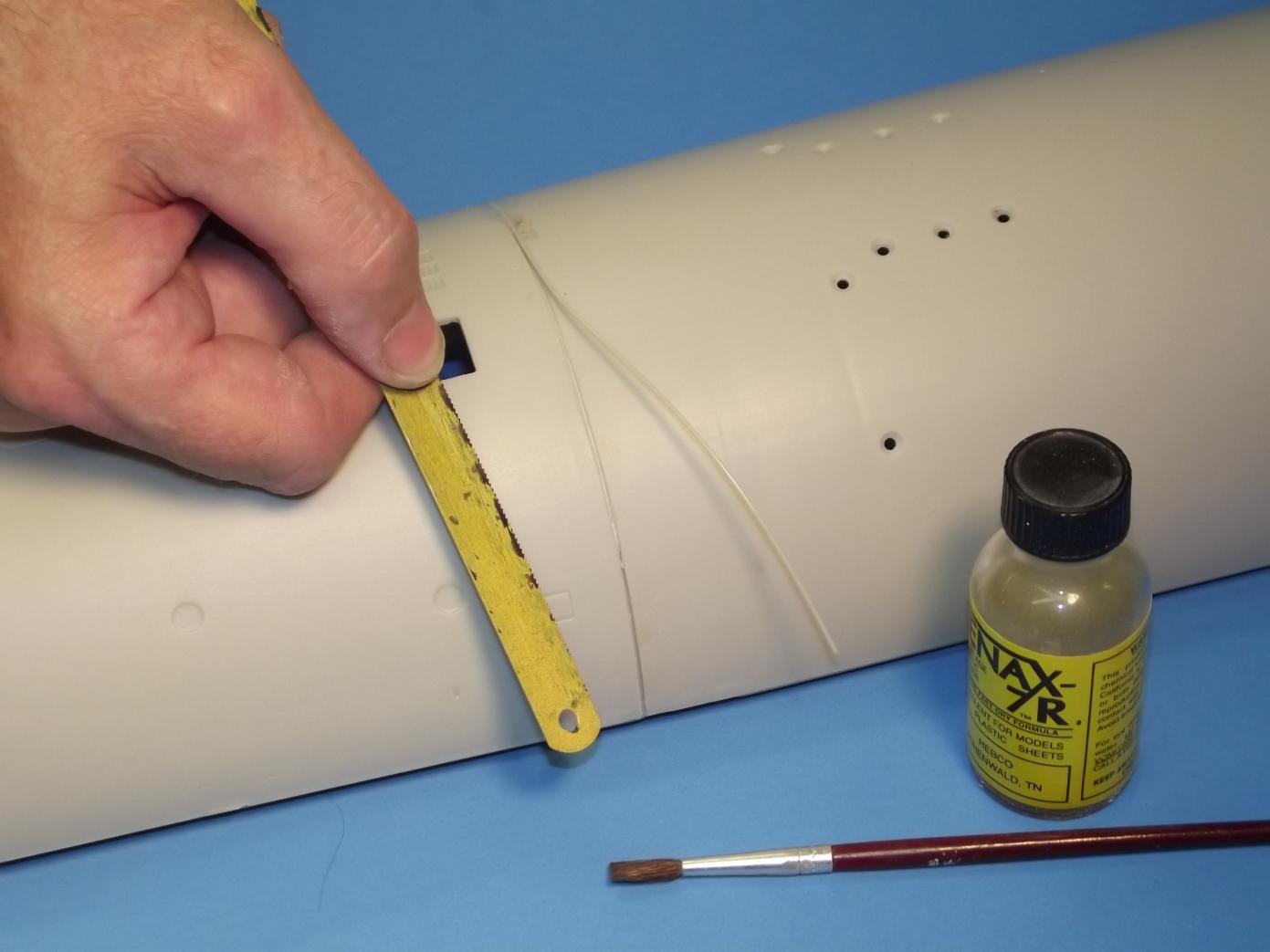

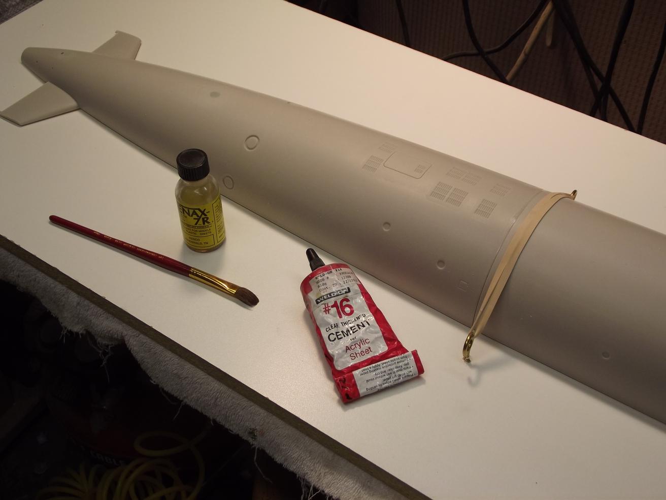

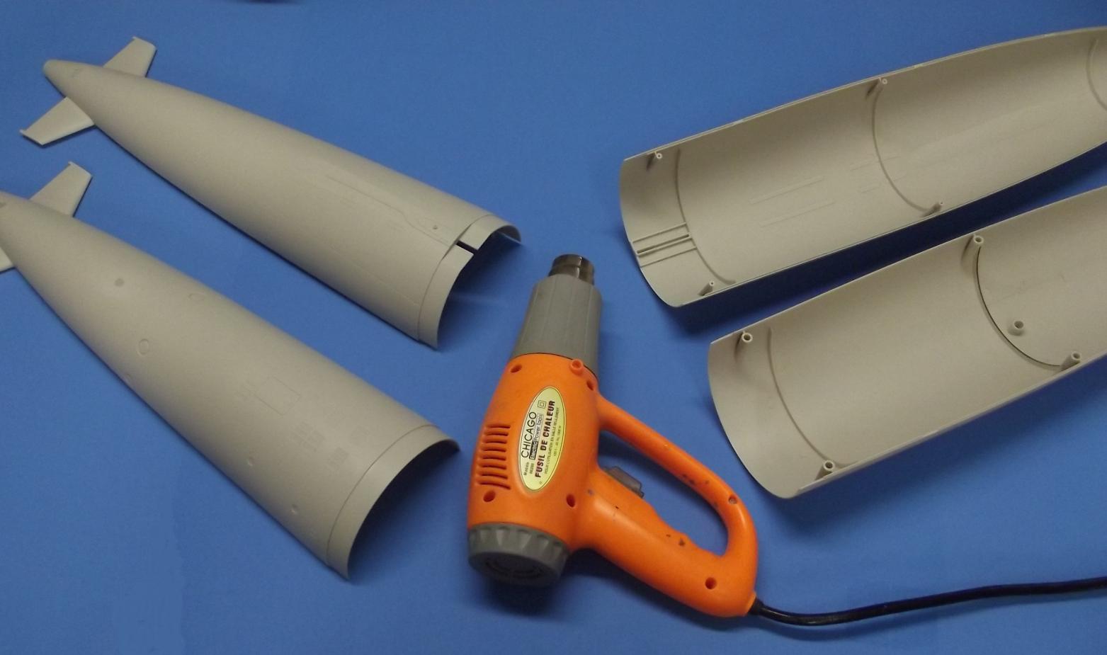

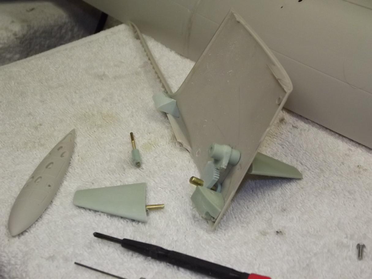

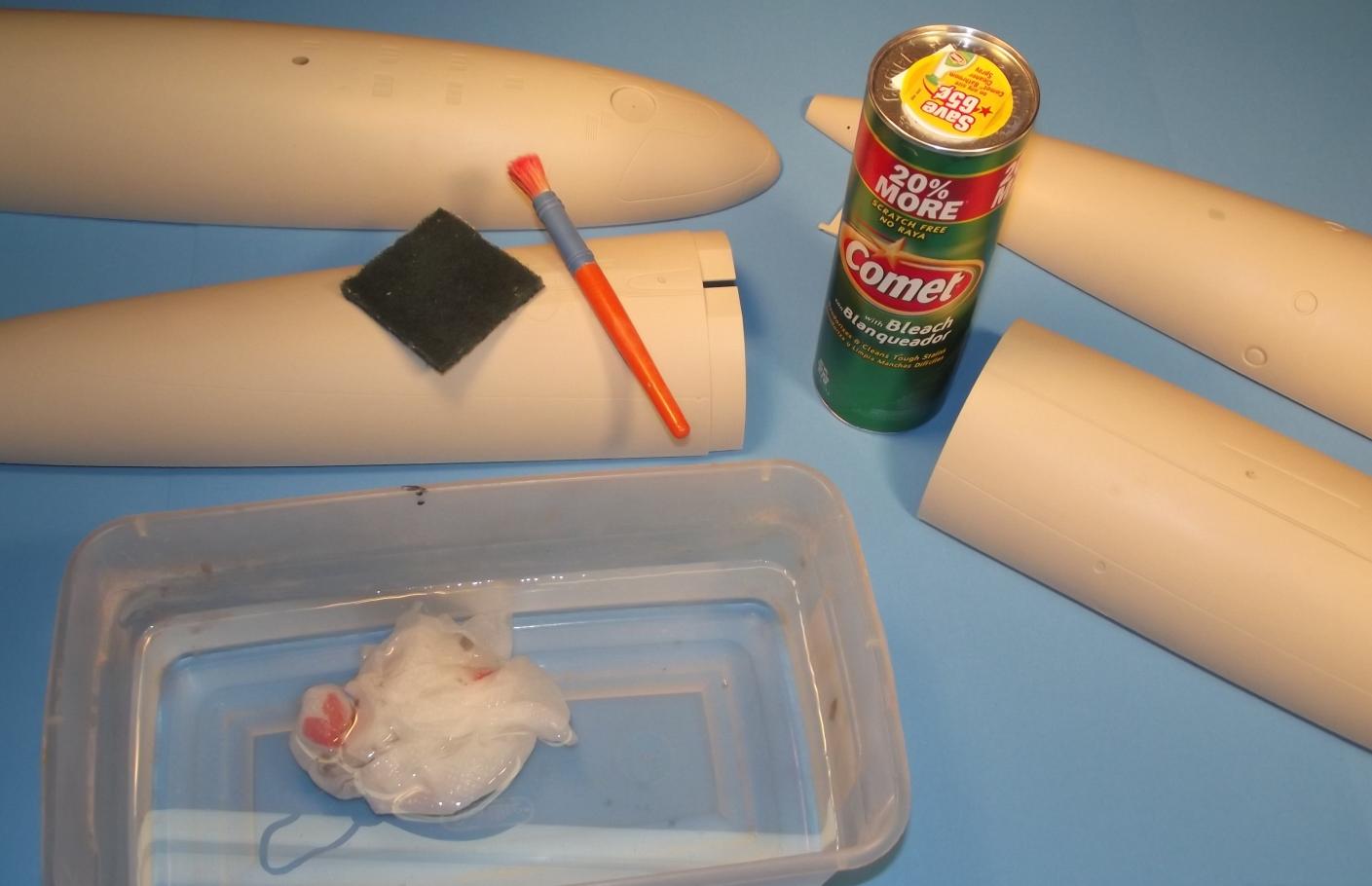

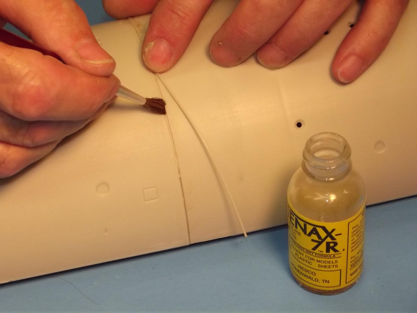

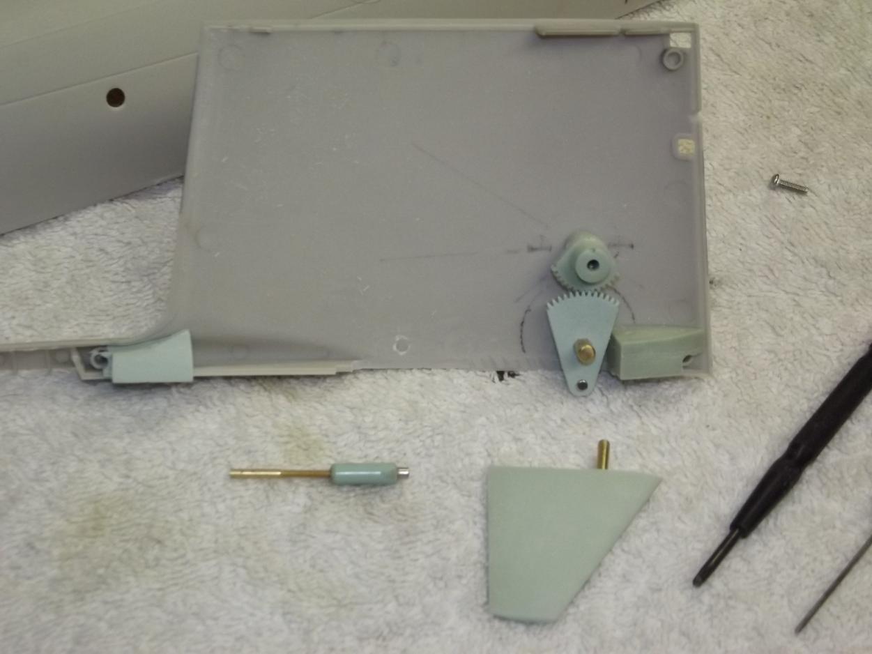

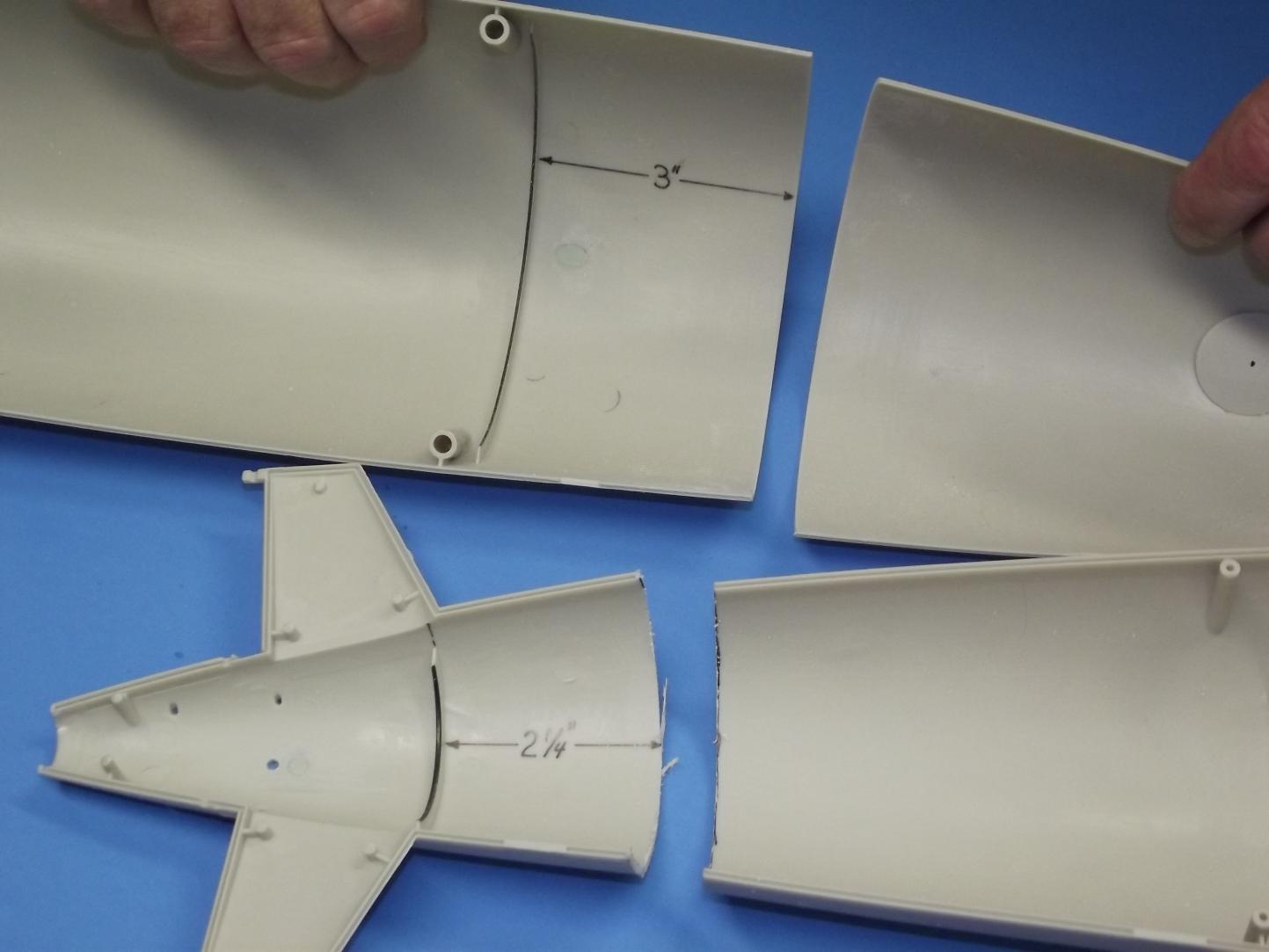

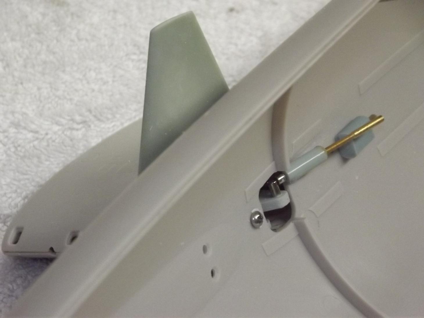

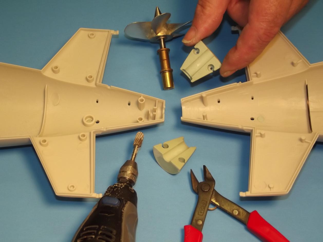

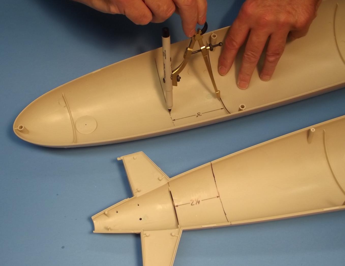

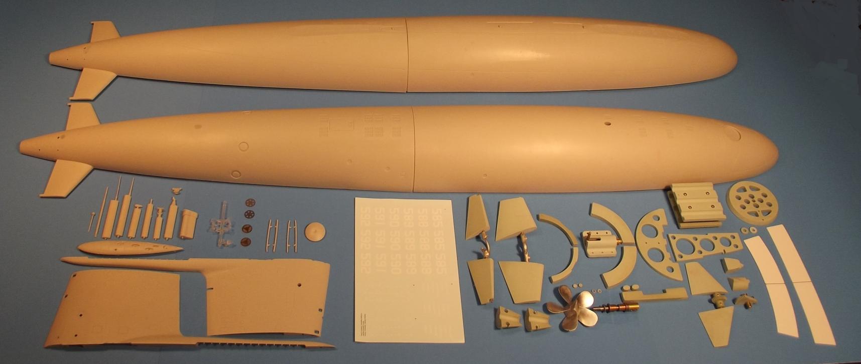

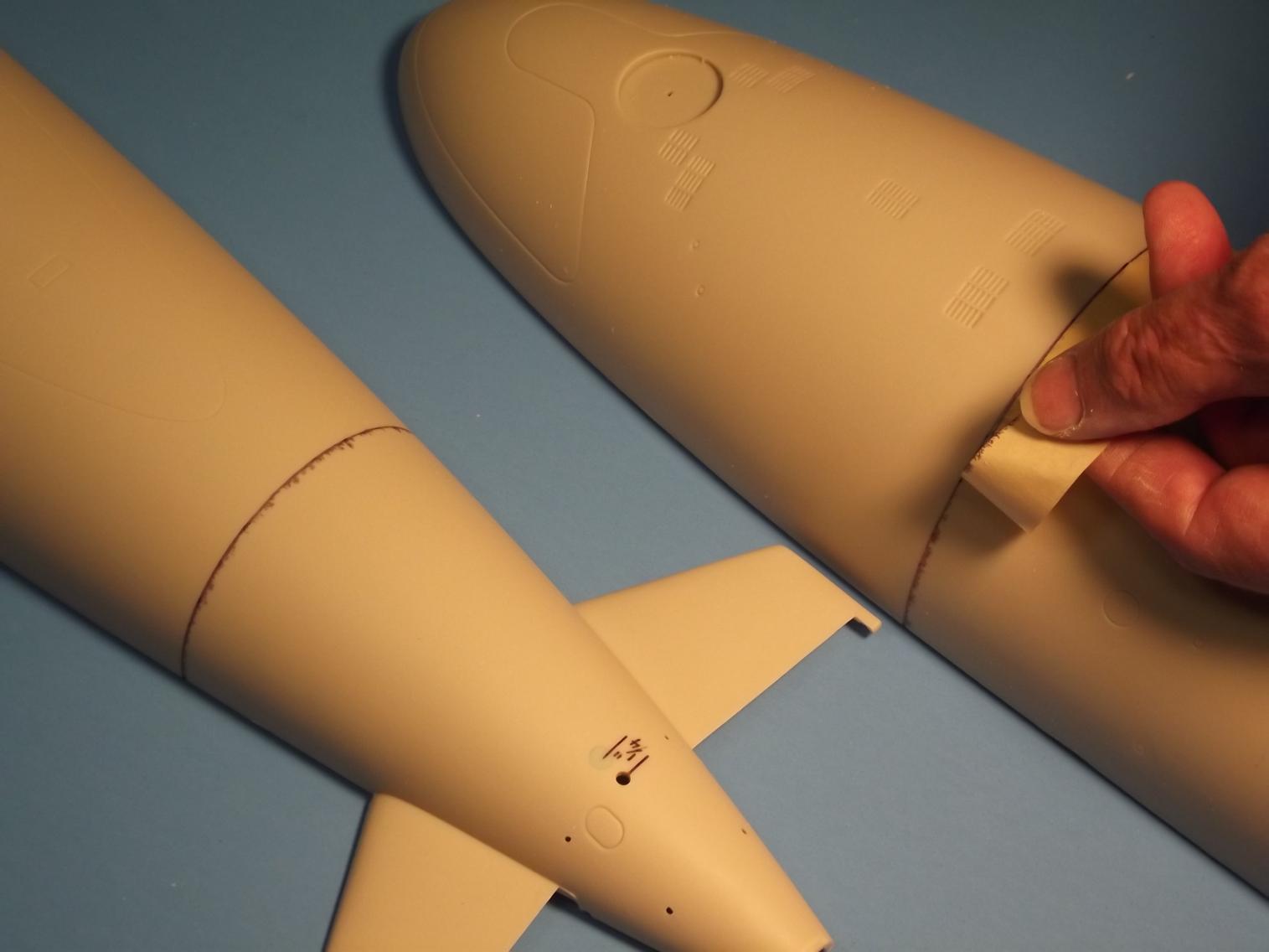

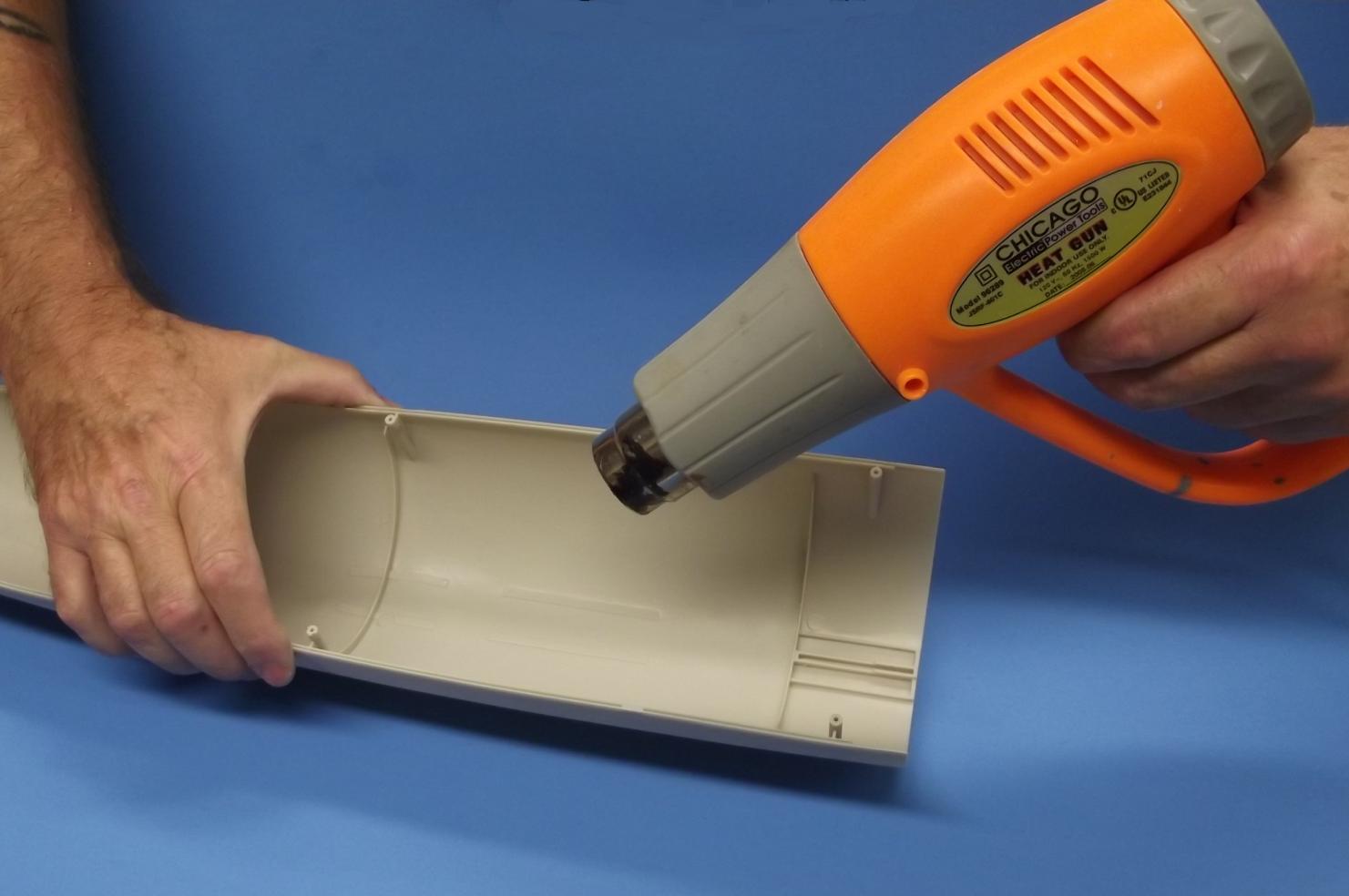

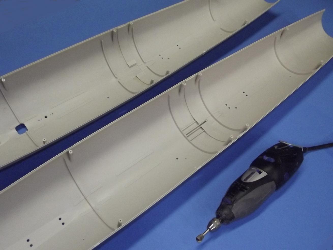

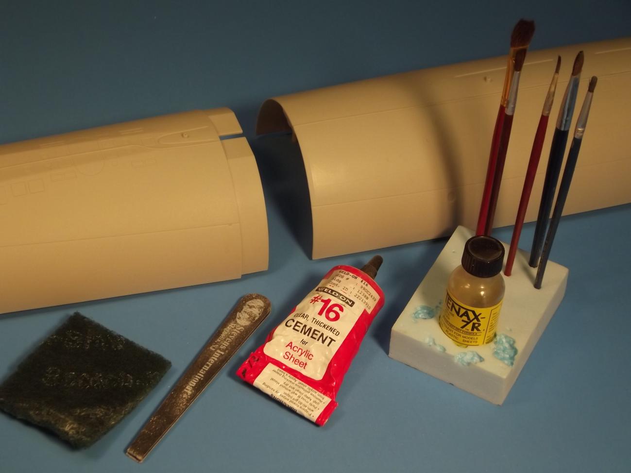

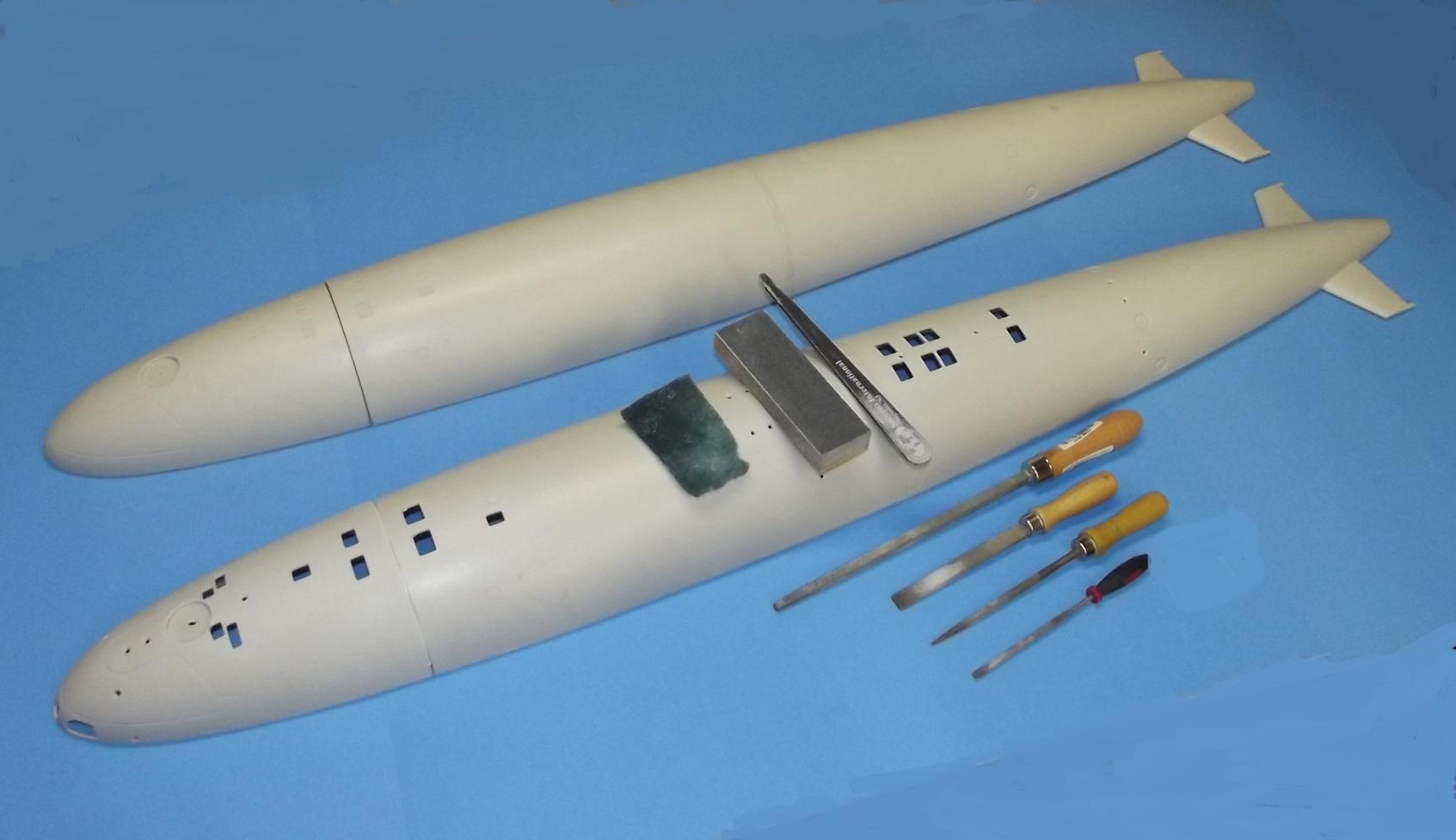

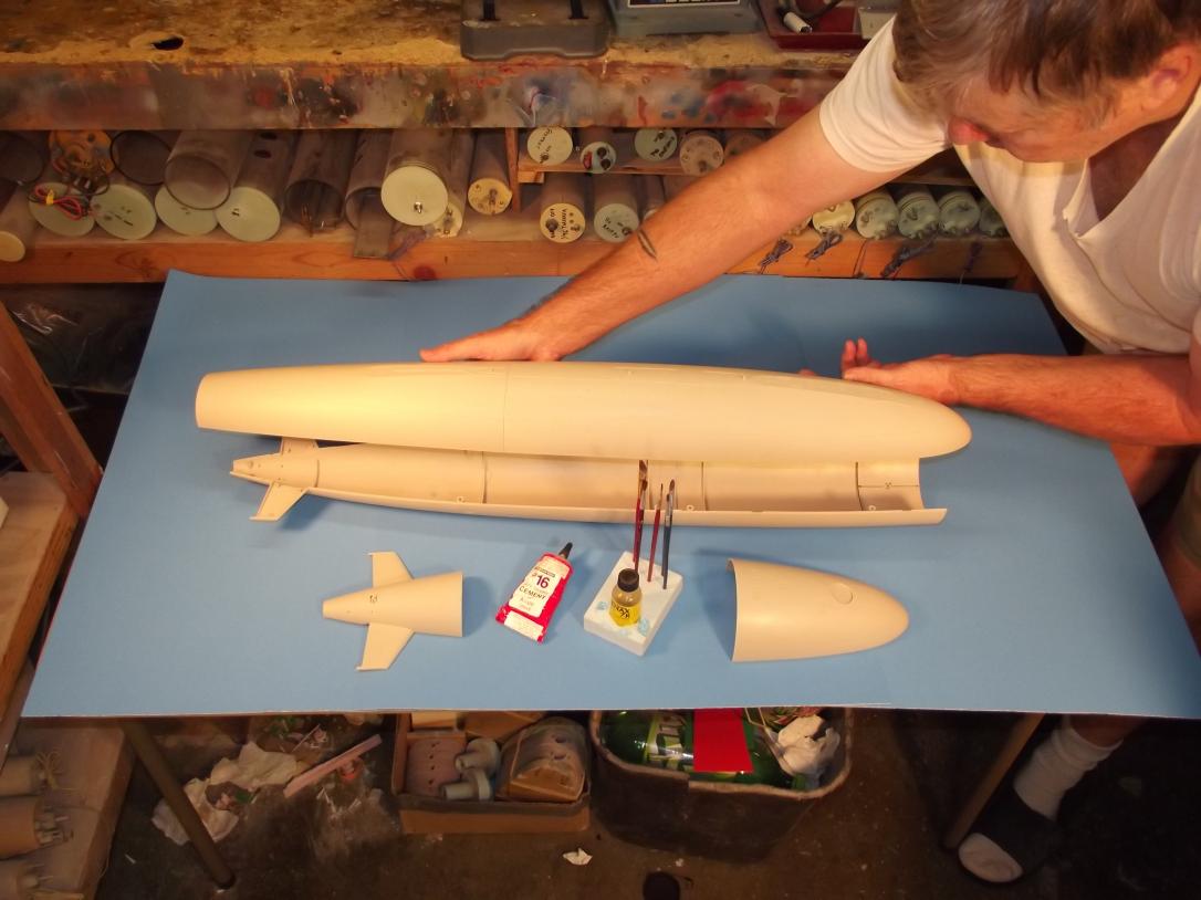

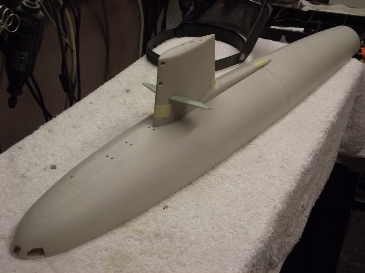

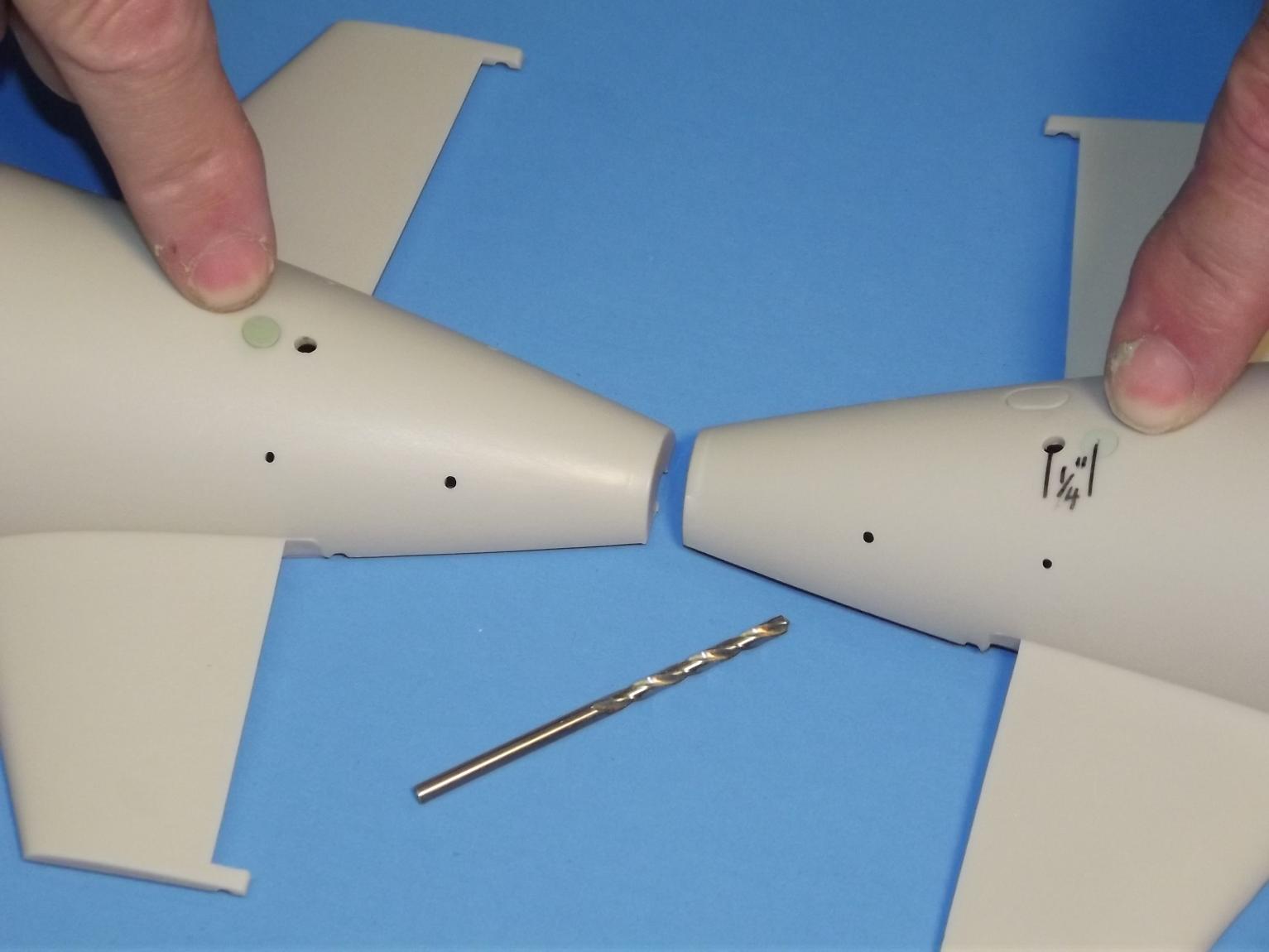

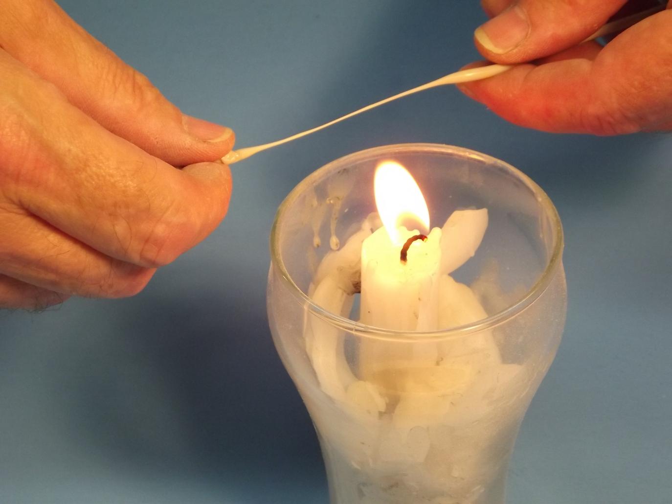

                    I'm working up the fittings kit instructions this week. Here are some shots that will be wrapped into the text:

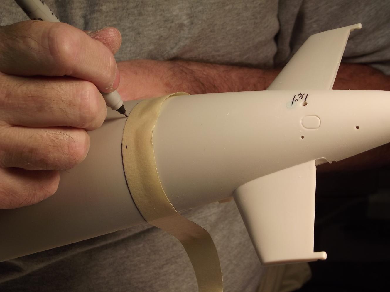

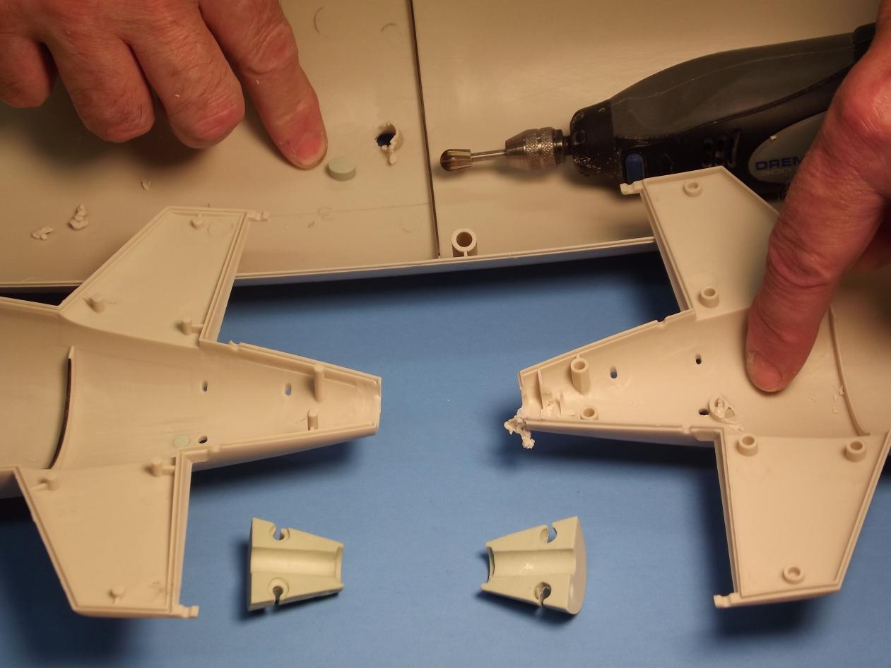

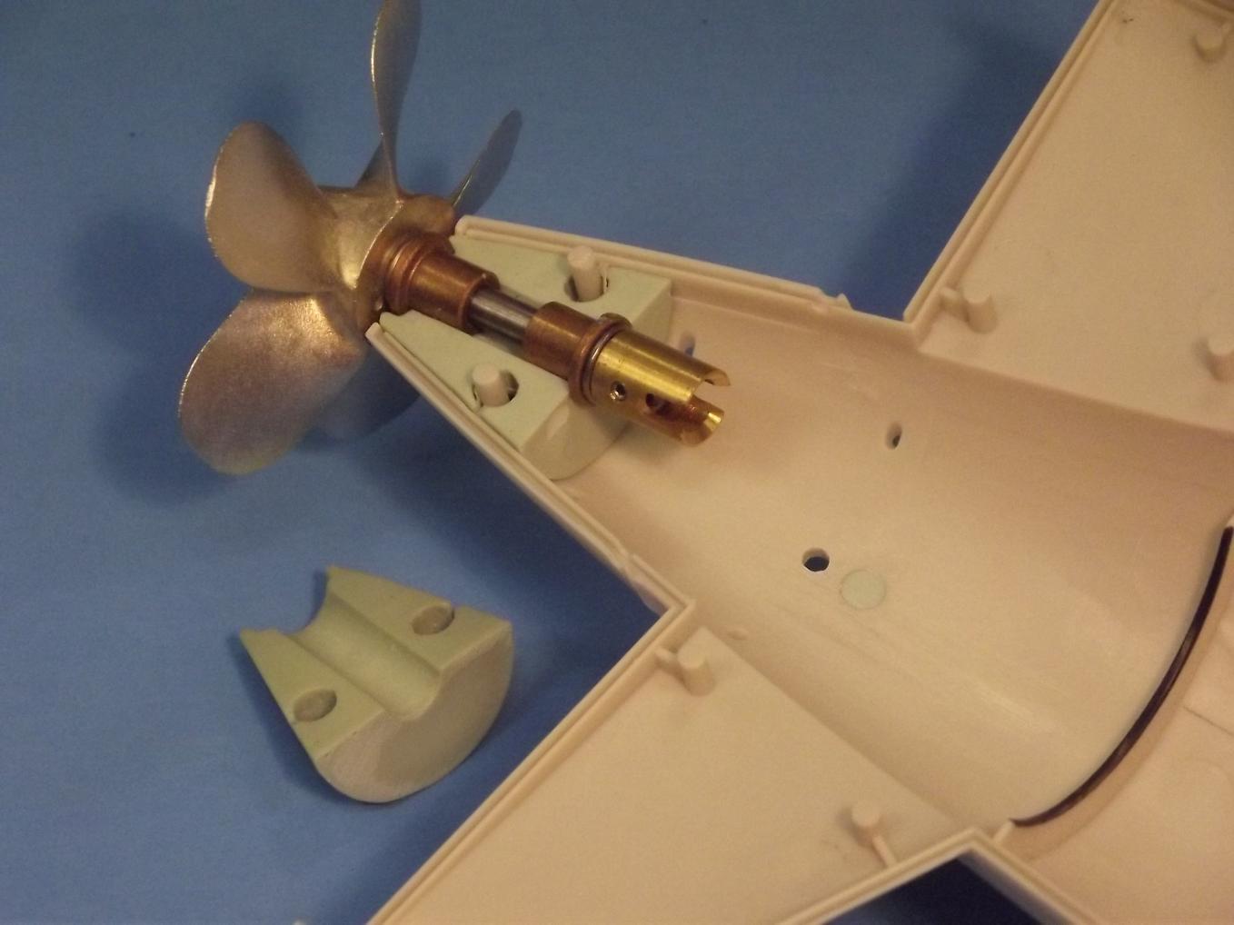

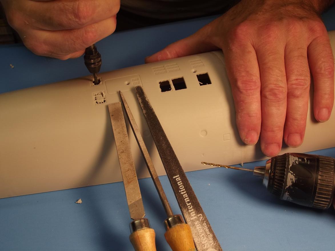

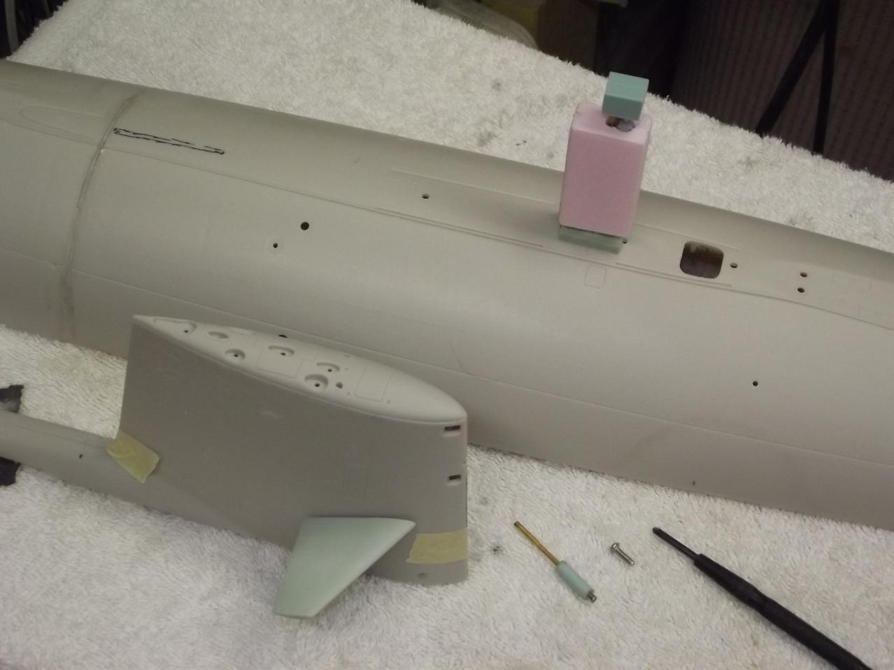

                              tonights shots:
