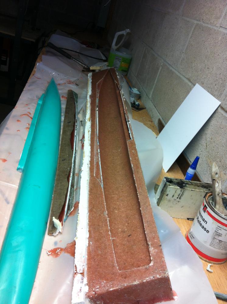

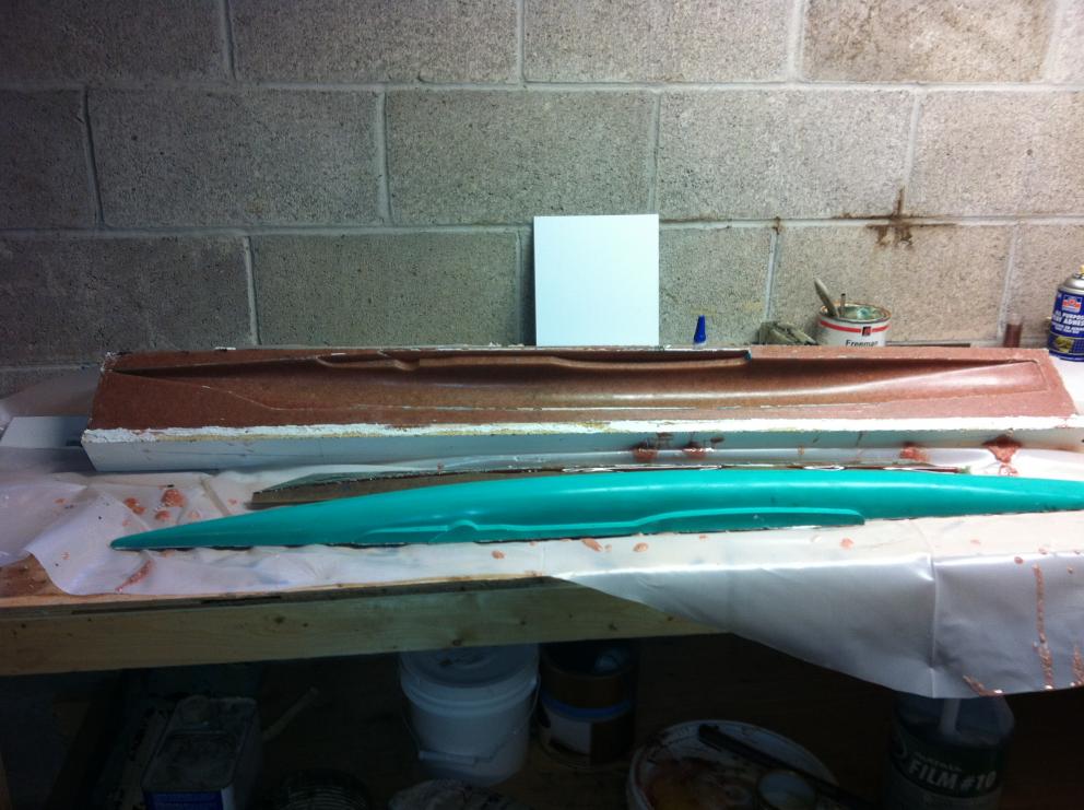

        I just looked at my mold and decided to open it up!
        It was still warm from the exotherm, and the MDF board just fell away from the resin.
        And then - the scary part - I tried to get my precious master from the mold - it fell out! The brown strip in the middle is the hardboard keel.
        I have a bubble - it's on the top edge on the right - see above. I can live with that as it's an easy mold repair.
        Other than that -MISSION ACCOMPLISHED!

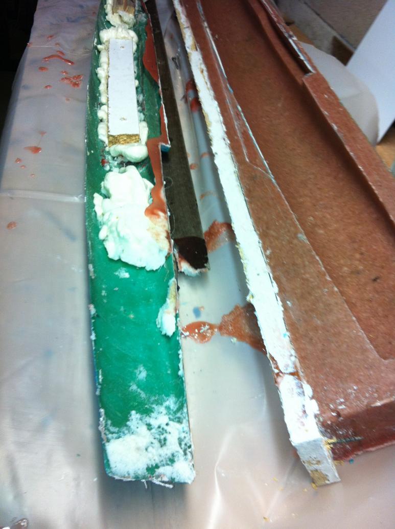

        Below, you can see the wood and foam I placed within the GRP hull. This enabled me to screw it down to the MDF.
        Yep! I reckon that's a winner!

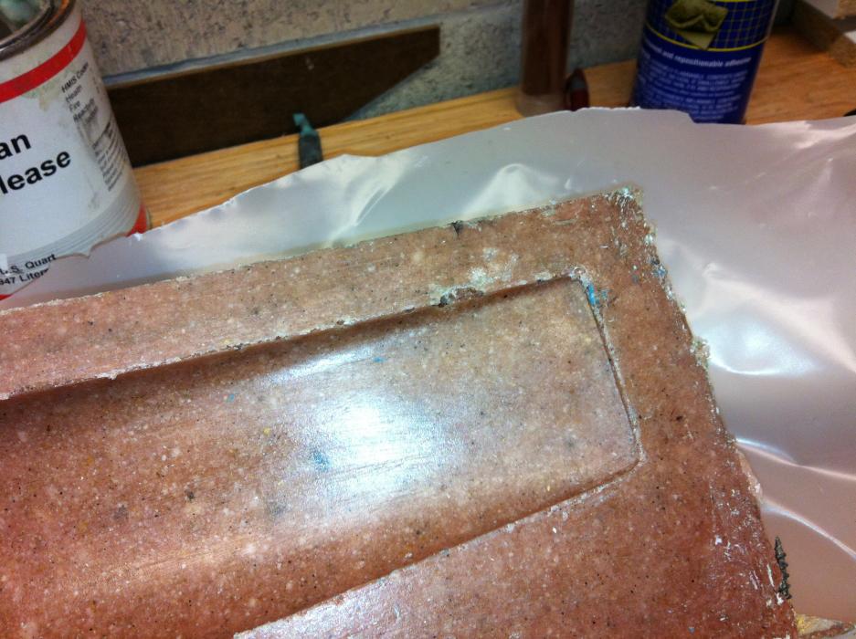

          #34

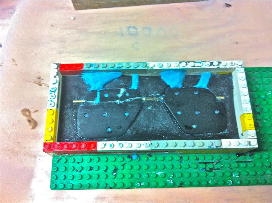

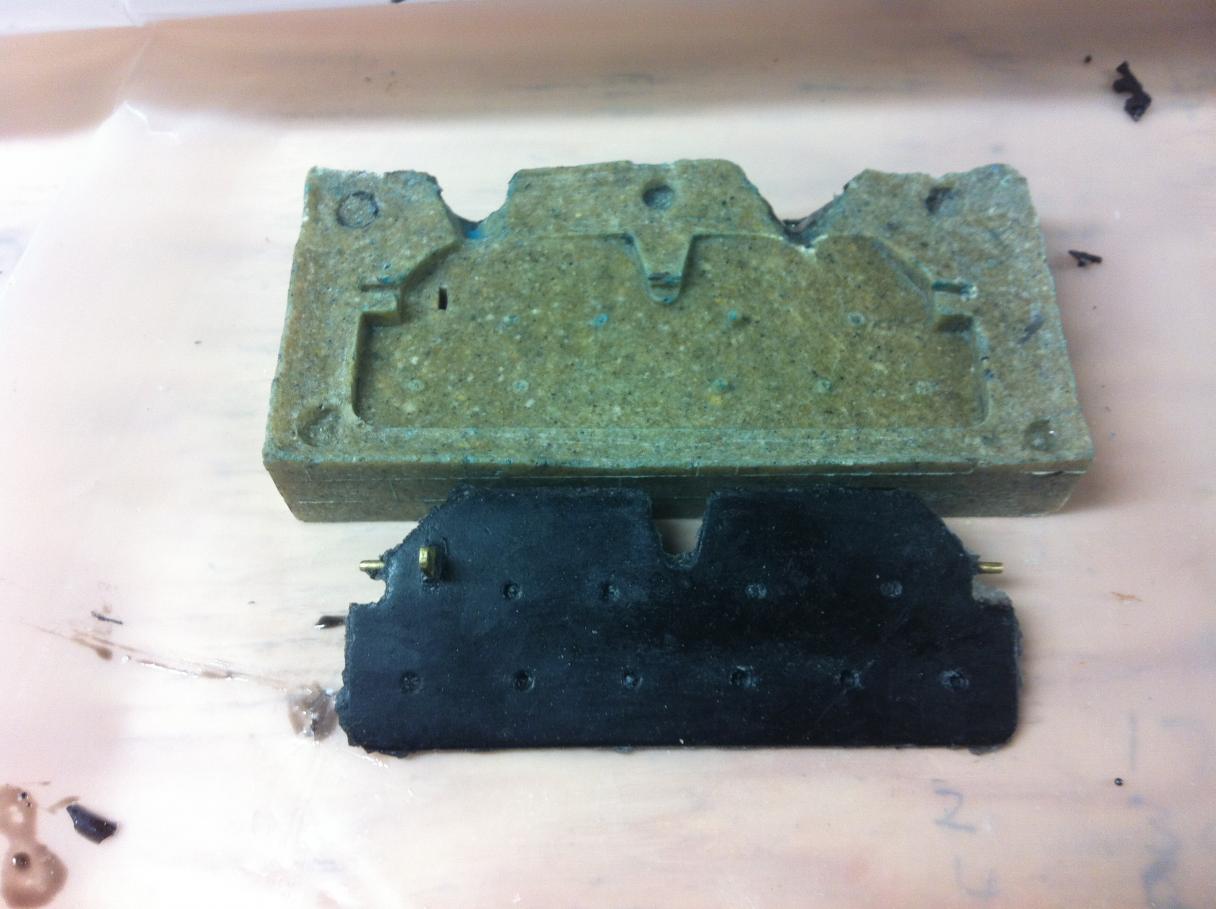

          I poured another X Craft dive plane today, and even though I had PVA sprayed the mold, I was having difficulty in removing the product from the mold. It had barely cured up and was a little flexible, but I could not get it out of the solid sand/epoxy mold. This is the disadvantage of these cheaper molds.
          However, the light bulb came on, and I decided to put the entire setup into a pot of boiling water for 10 minutes. Hopefully, it would cure out the resin, and at the same time, make it very pliable and easier to remove. I was right, and the dive plane fell out of the mold.
          So, I think we have a new process here.
          It goes like this -
          1. Make a mold using sand/epoxy.
          2. 2 coats Mold wax and polish with cloth
          3. Spray 2 coats of PVA
          4. Pour epoxy into mold
          5. Shake the mold vigorously to remove bubbles
          6. Allow to set for 5-6 hours
          7. Boil the mold in water for ten minutes.

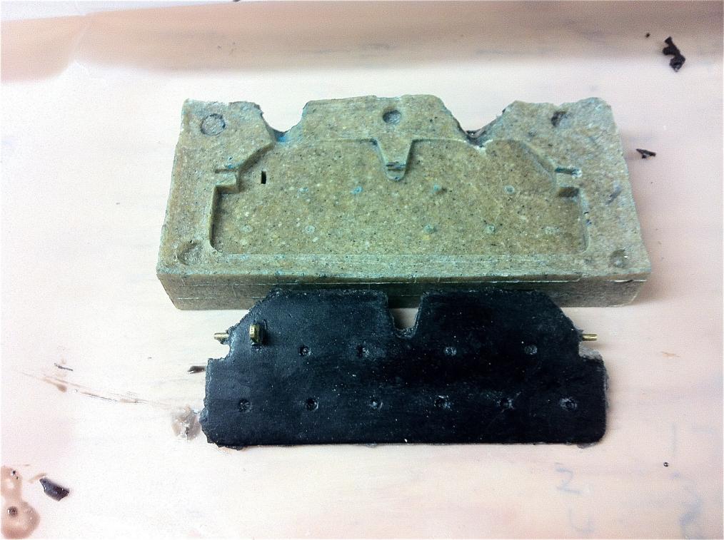

          Below, I'm making a mold for the rudder from the shattered parts of the rudder (thanks UPS)
          I used black epoxy to make the mold, and unfortunately used the same color for the rudder, so I messed with the photo to get a better view of the part.
          Note the clay placed to provide vents and pouring holes.

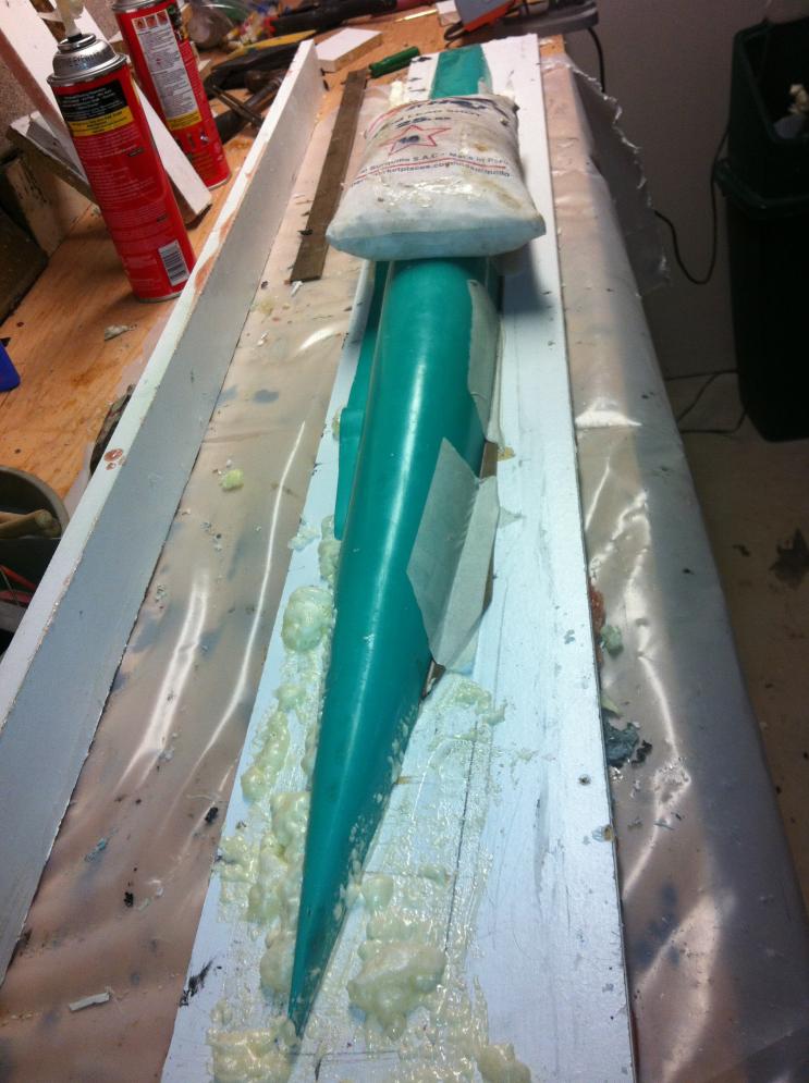

          Here's the M1 model. I'm making a mold for the starboard side now. I placed the dummy keel onto the original mold, to get it lined up so they match. Then I taped the dummy keel to the model hull and transferred to an MDF board.
          After lining it up to match registration marks from the other mold, I pumped a load of Great Stuff Foam under the hull and whacked a 20lb bag of lead shot on top. Hopefully, the model will now be glued tight to the MDF - we'll see tomorrow!
